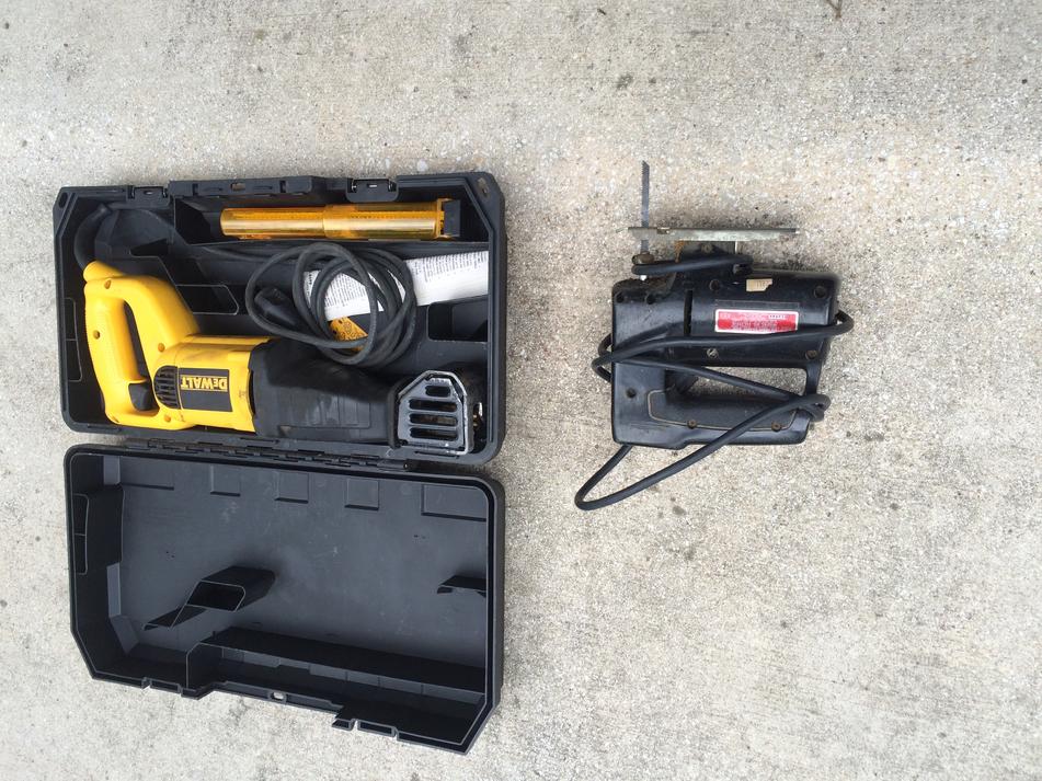

:sawzall:
Do we have the sawzall emoticon? That is the standard answer on Tacomaworld when someone says my tires rub.

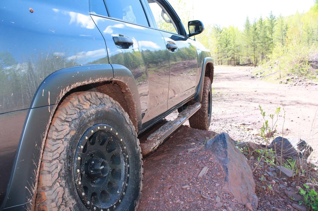

Update: still no rub
Few months out. Things are still good. Took a spin crawling at the iron range (MN) and added 100lbs to the front end with the wench. Still no rub. Again 285/70/r17's on 17x8.5 rims, no front mud flaps,+ fender mods, 3.5 inch lift (icon stage 2).
