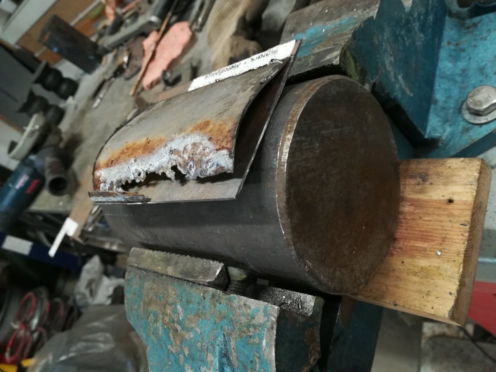

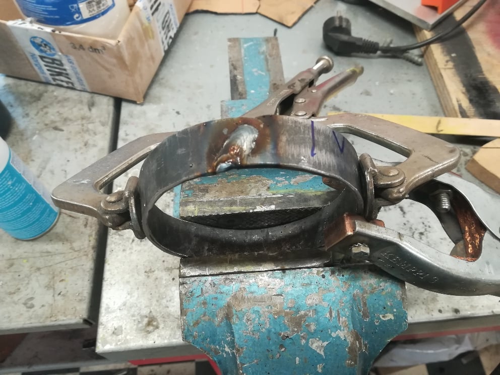

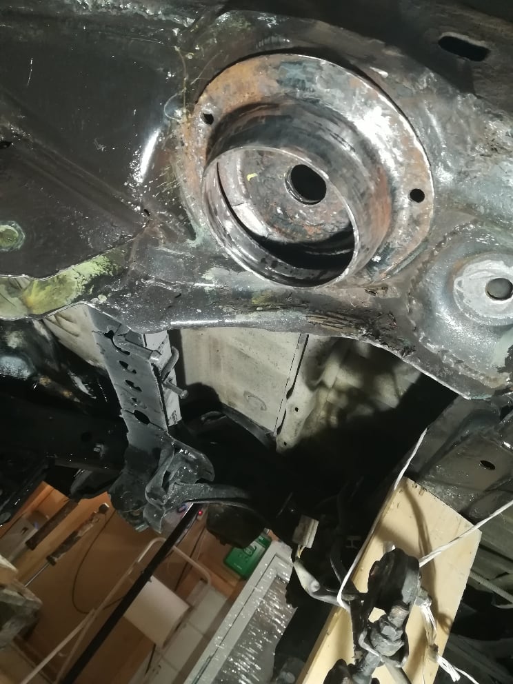

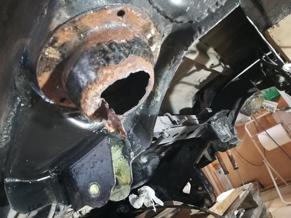

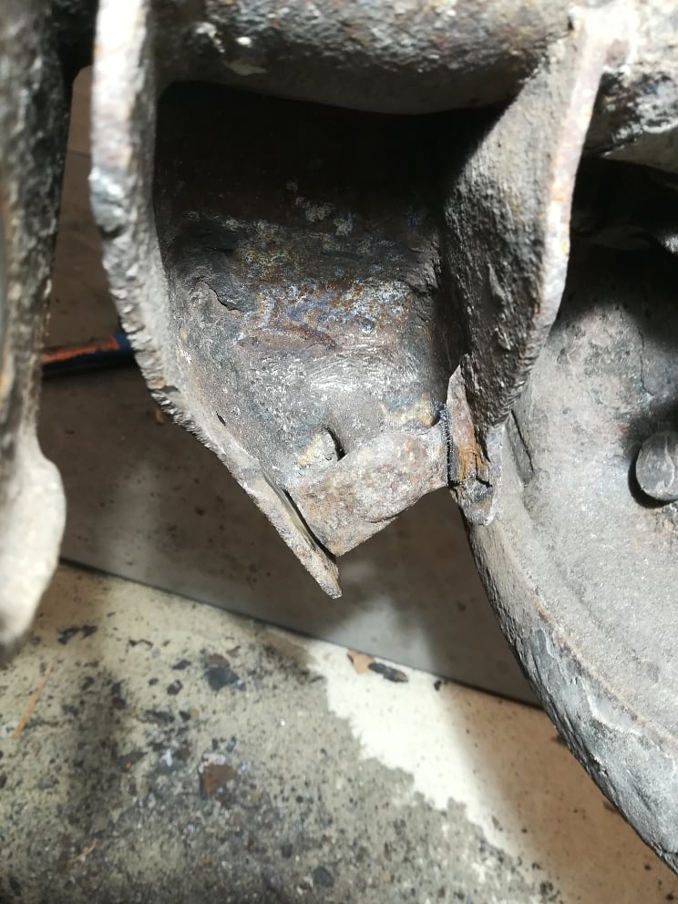

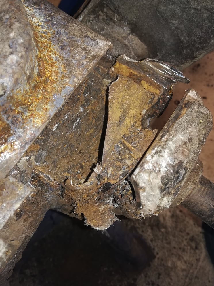

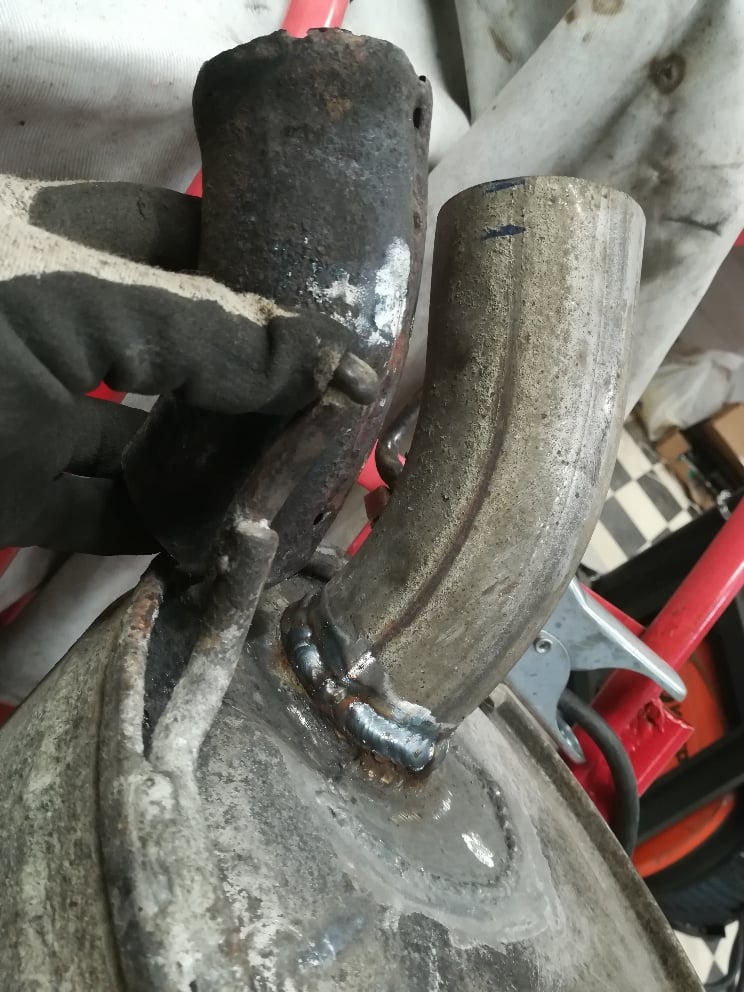

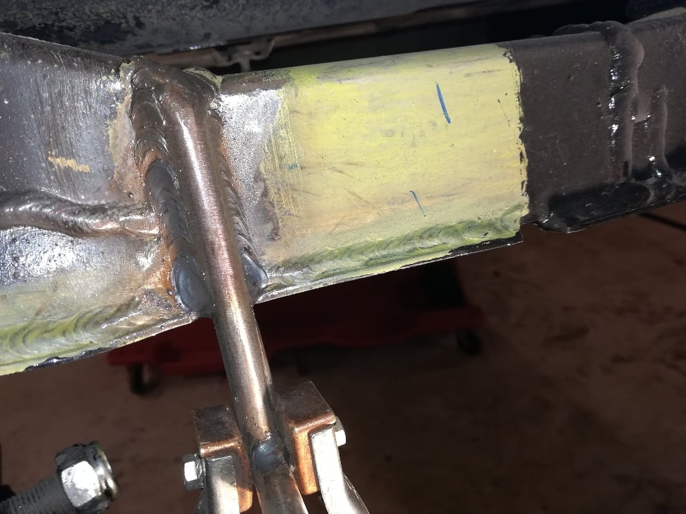

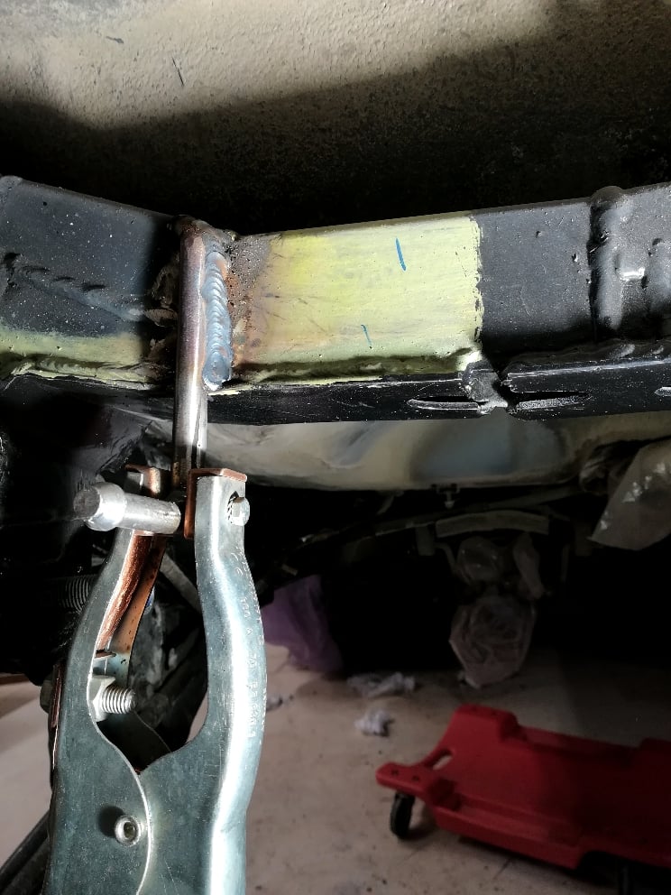

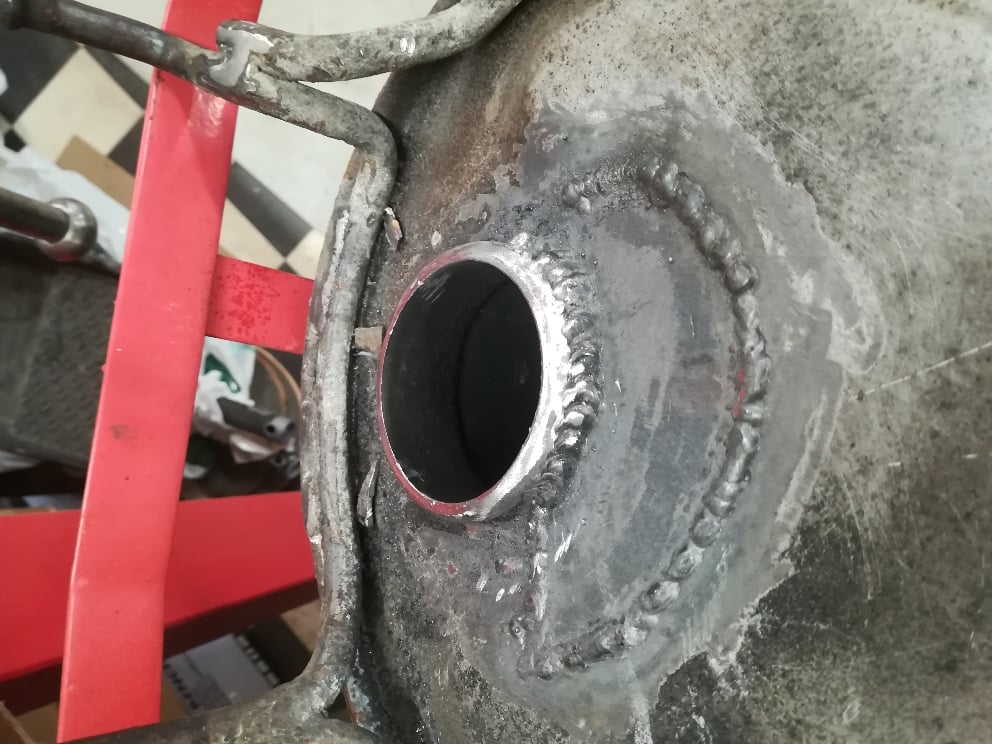

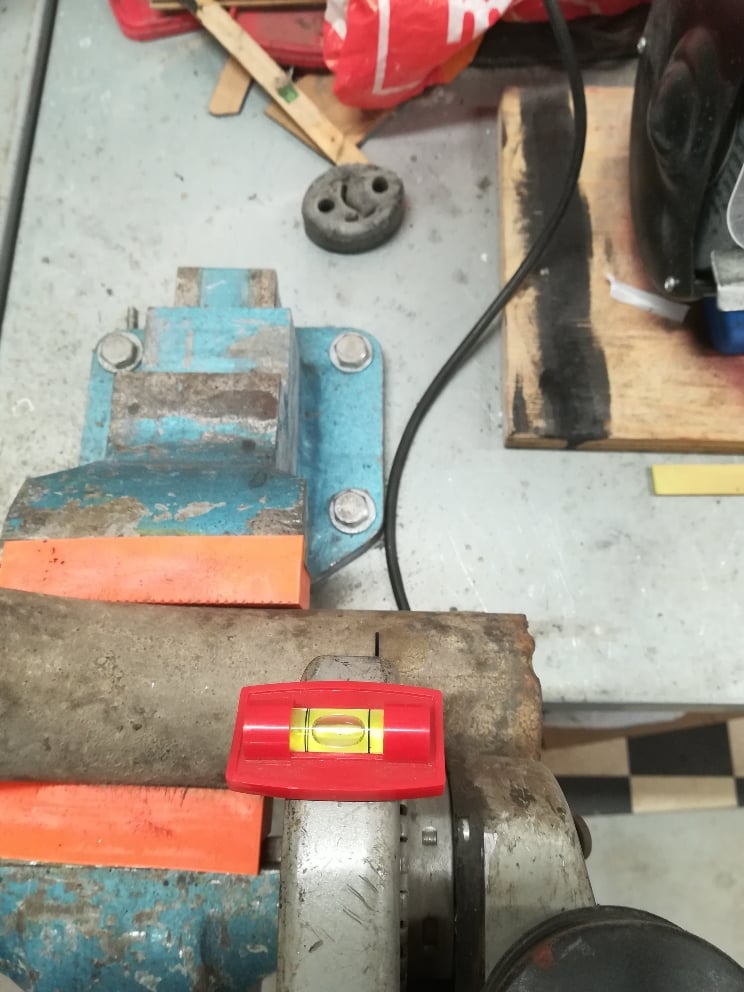

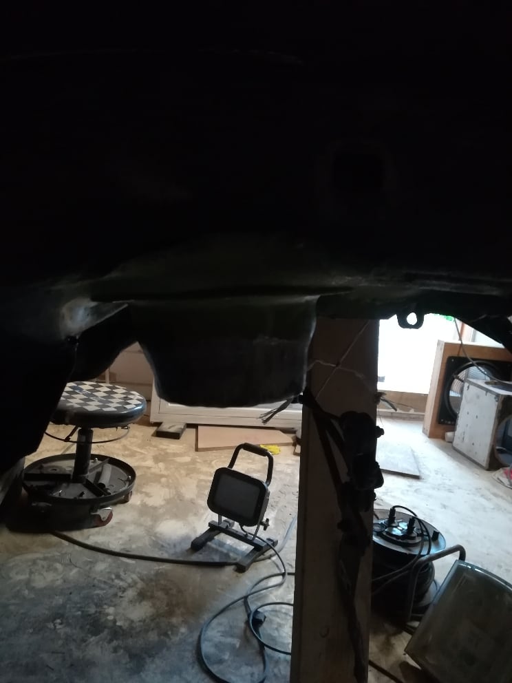

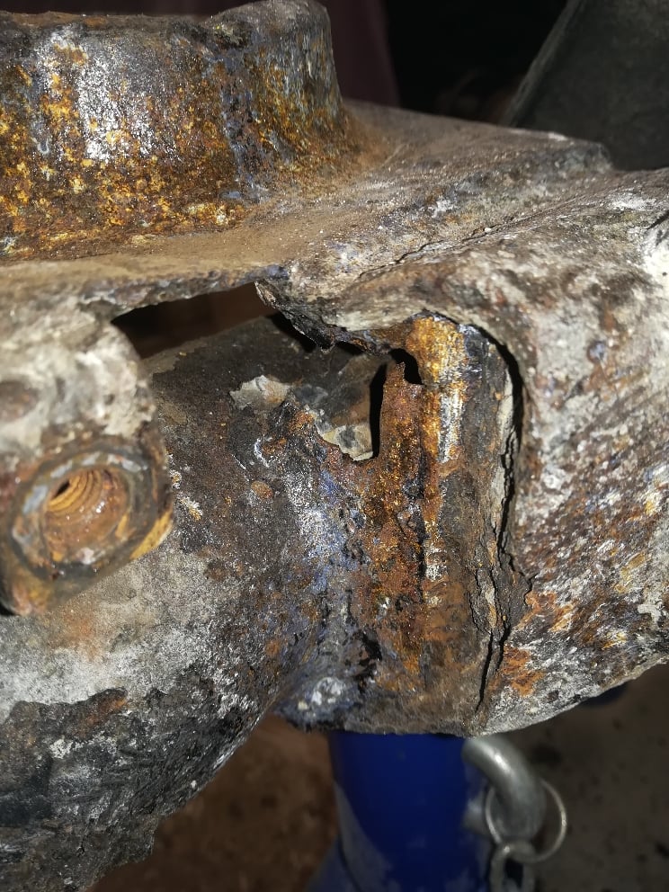

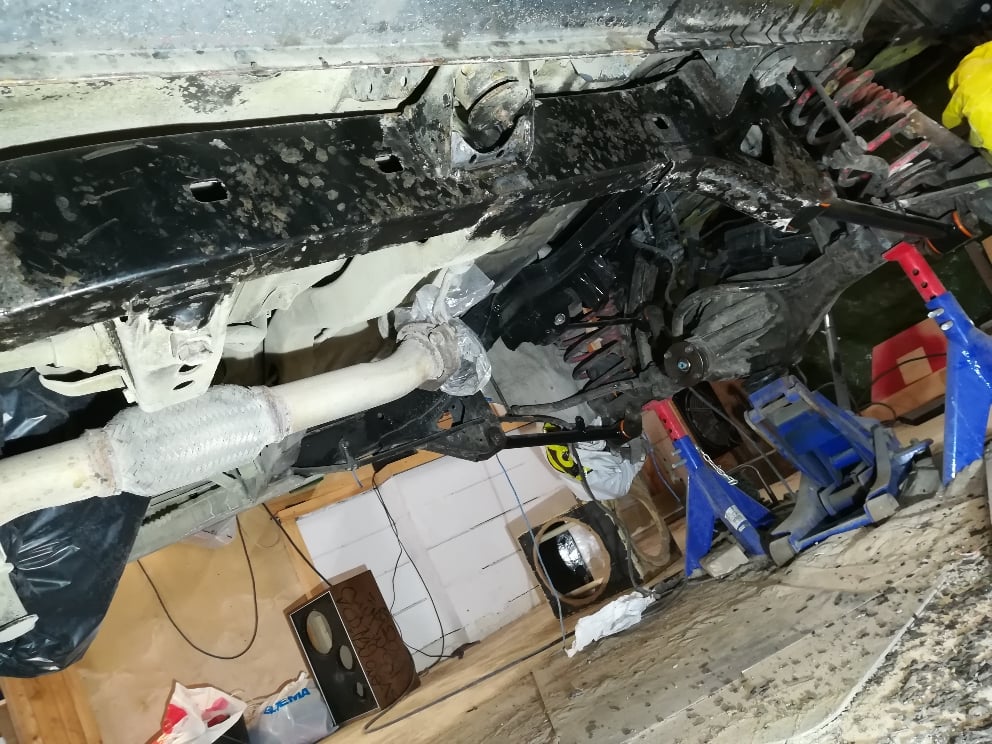

New ring for the lower frame bushing. Sandblasted area and cleaned up first and welded a small hole first.
Sent fra min WAS-LX1 via Tapatalk

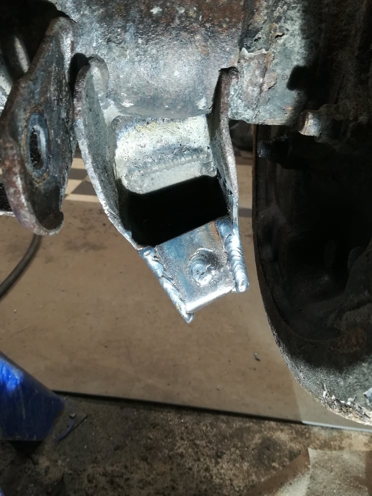

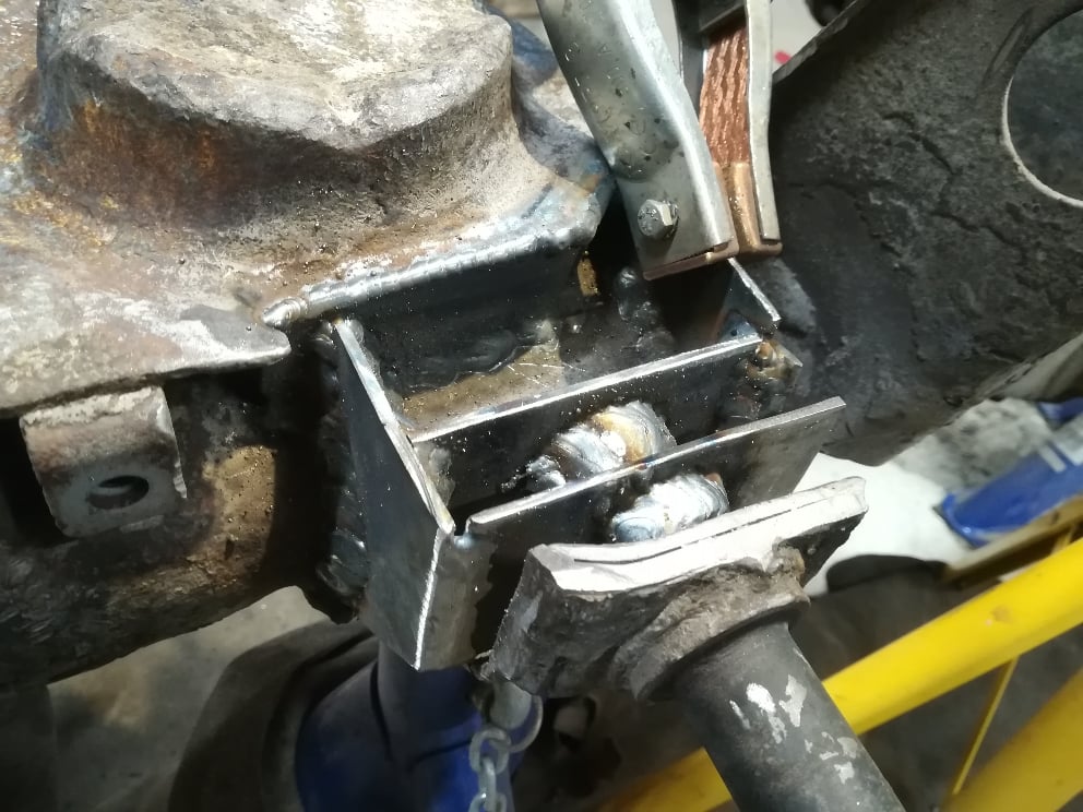

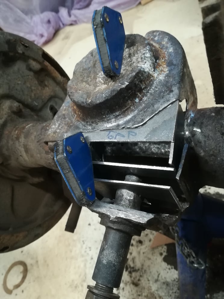

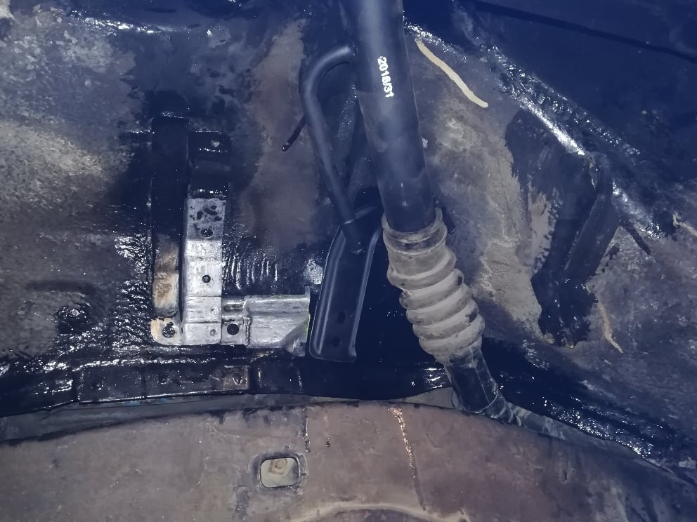

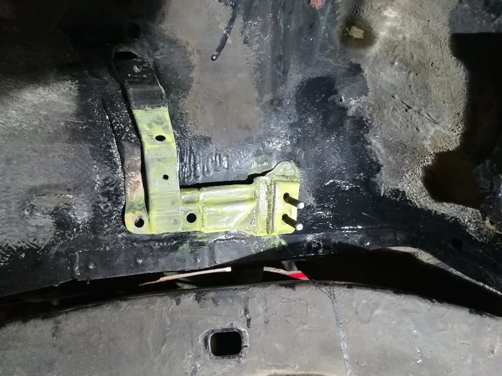

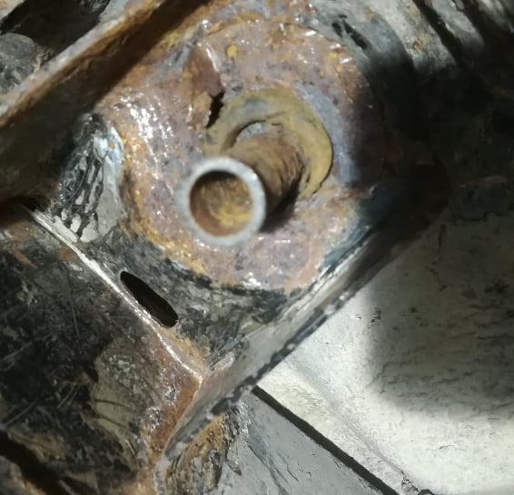

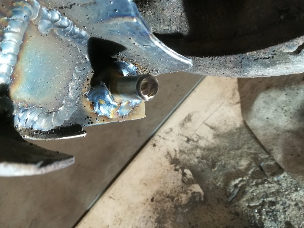

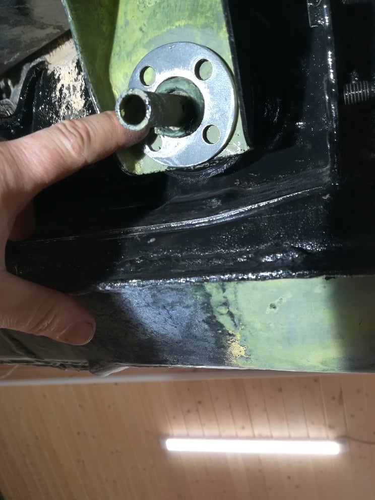

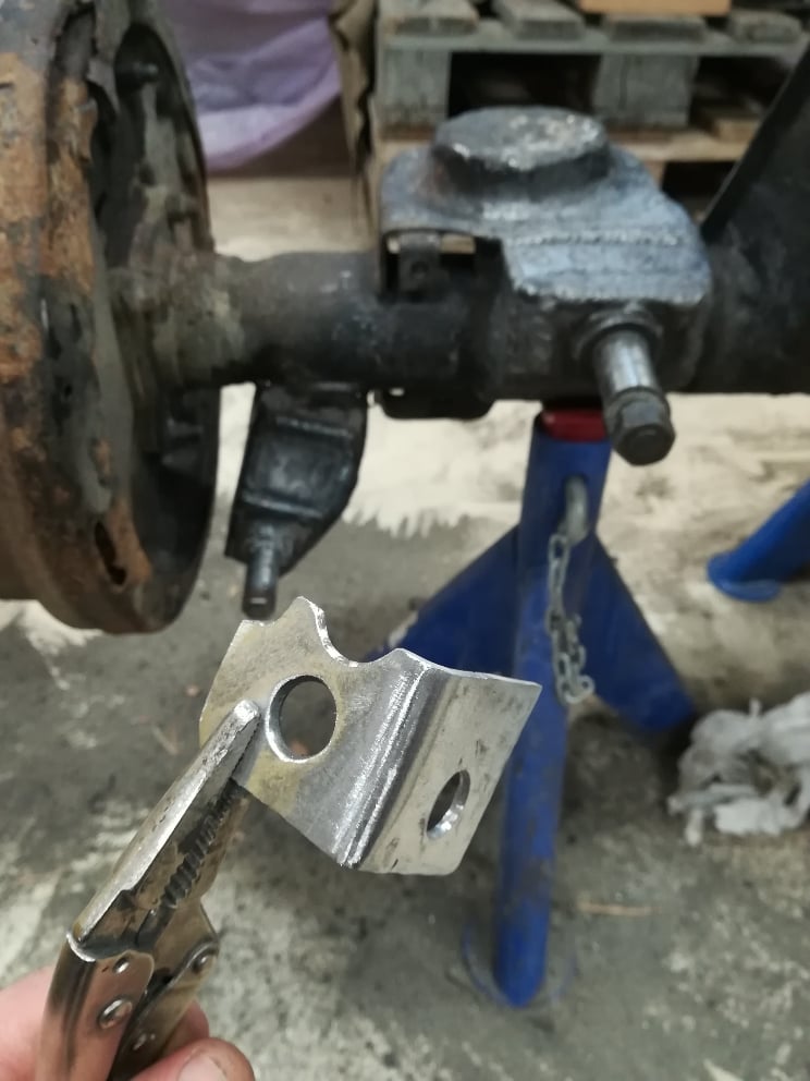

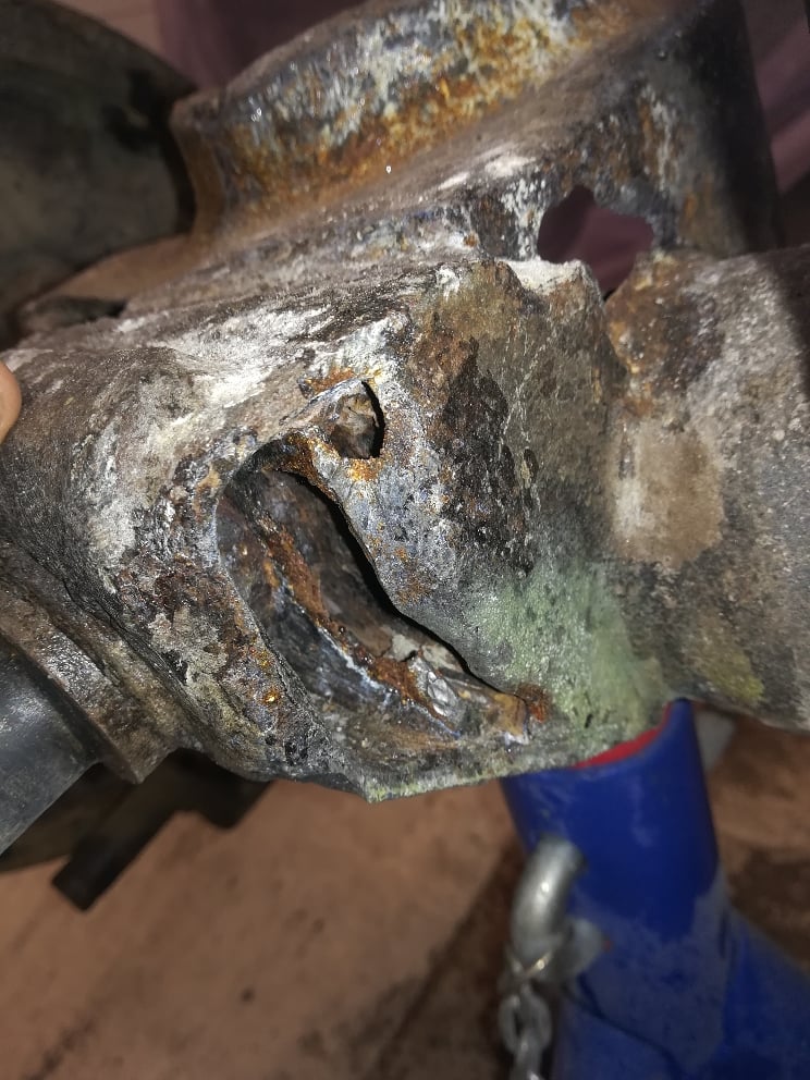

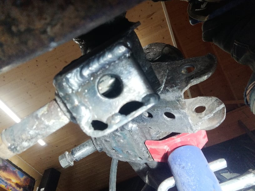

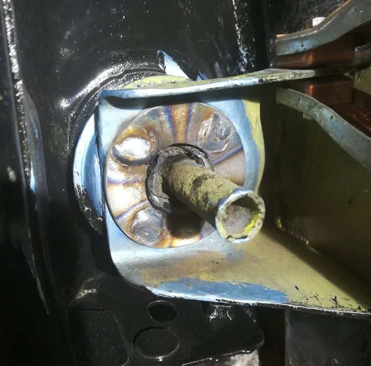

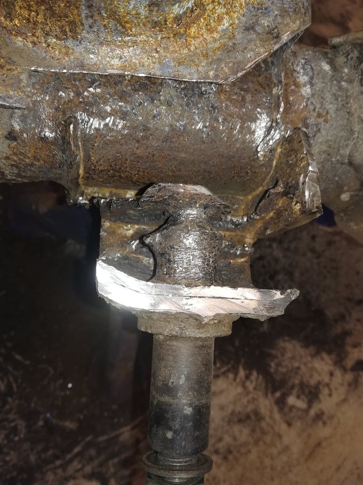

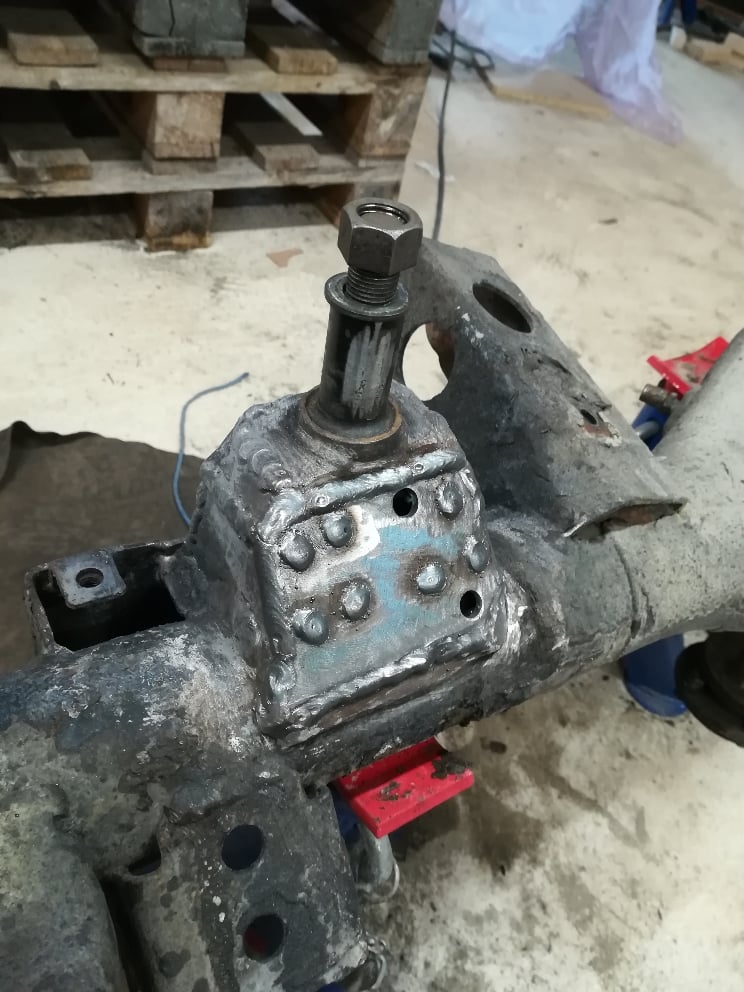

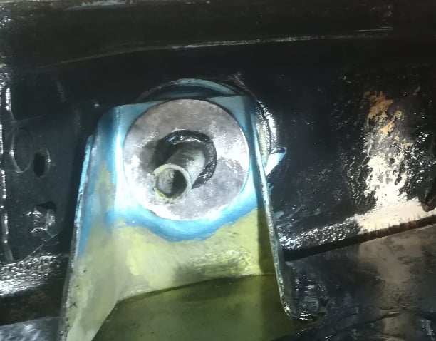

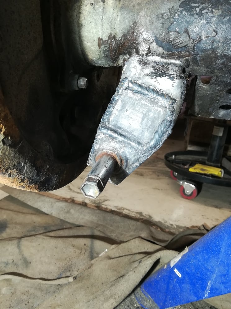

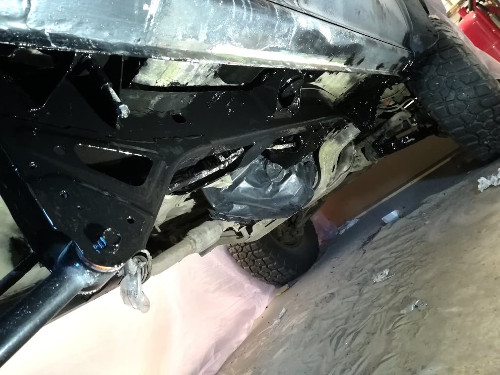

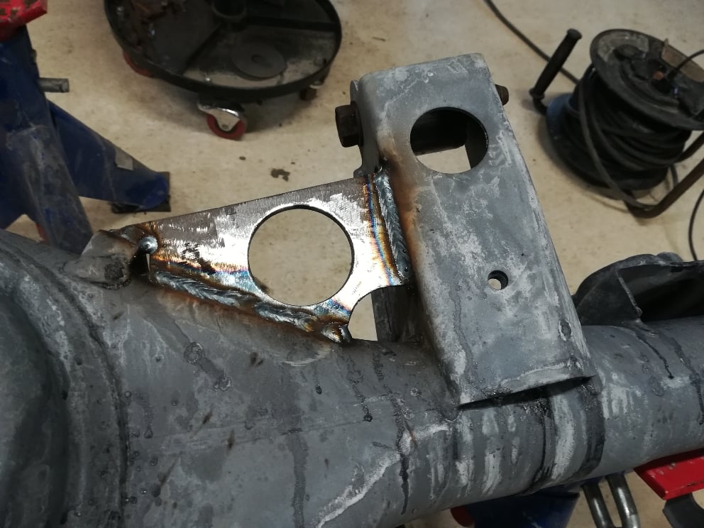

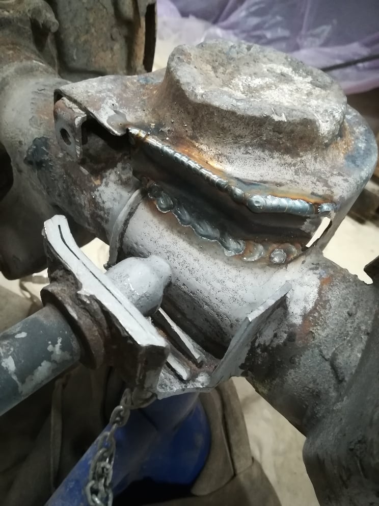

Panhard mount fixed and done. Did a bypass for water and dirt under the spring seat so it will not go in to the mount. the 2 holes underside will be covered with 2 plastic plugs after spraying in fat so it will not rust.

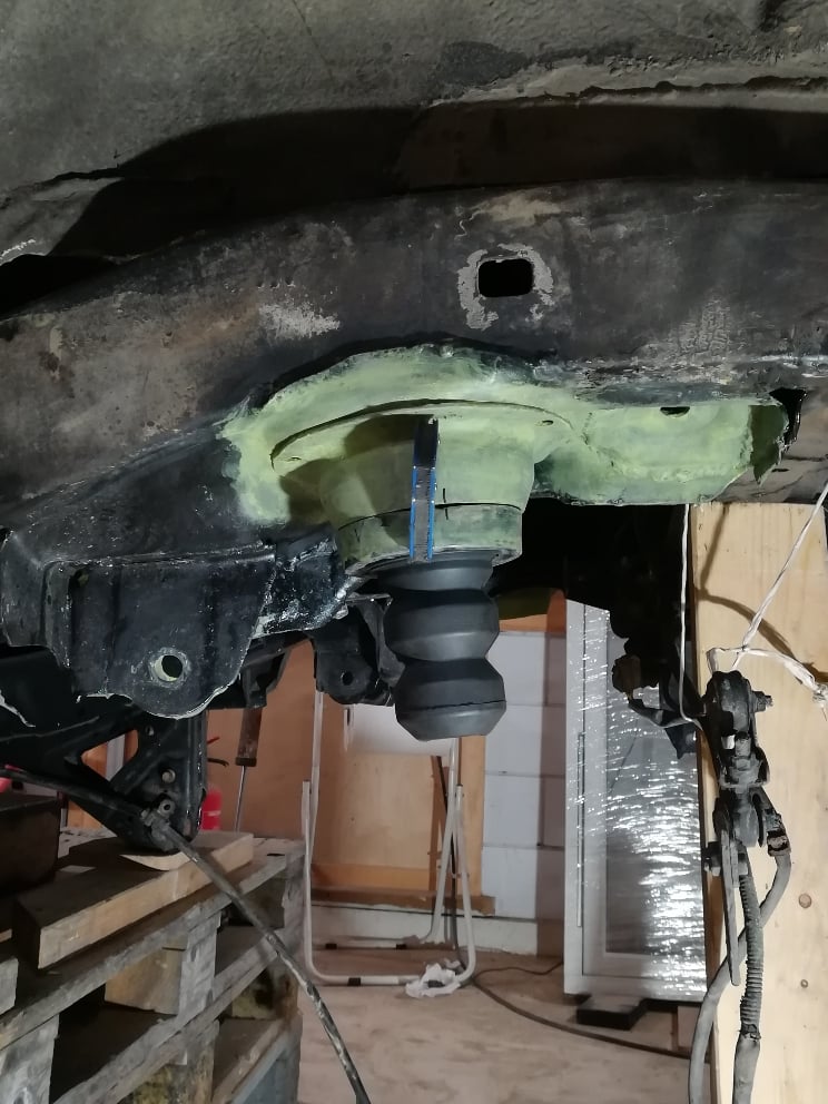

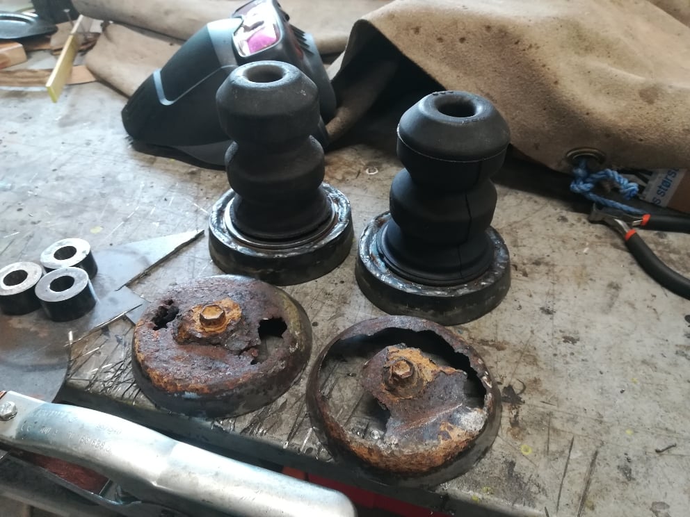

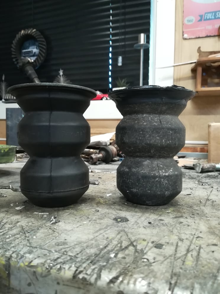

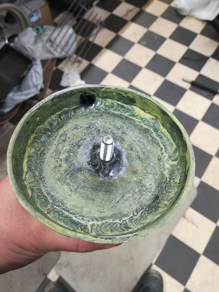

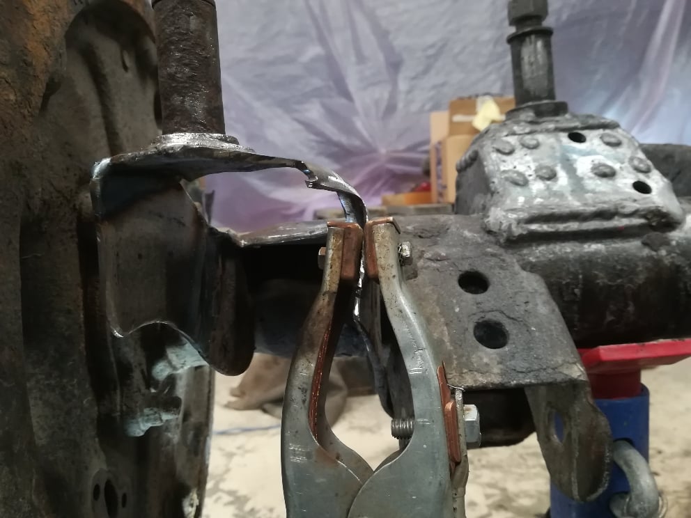

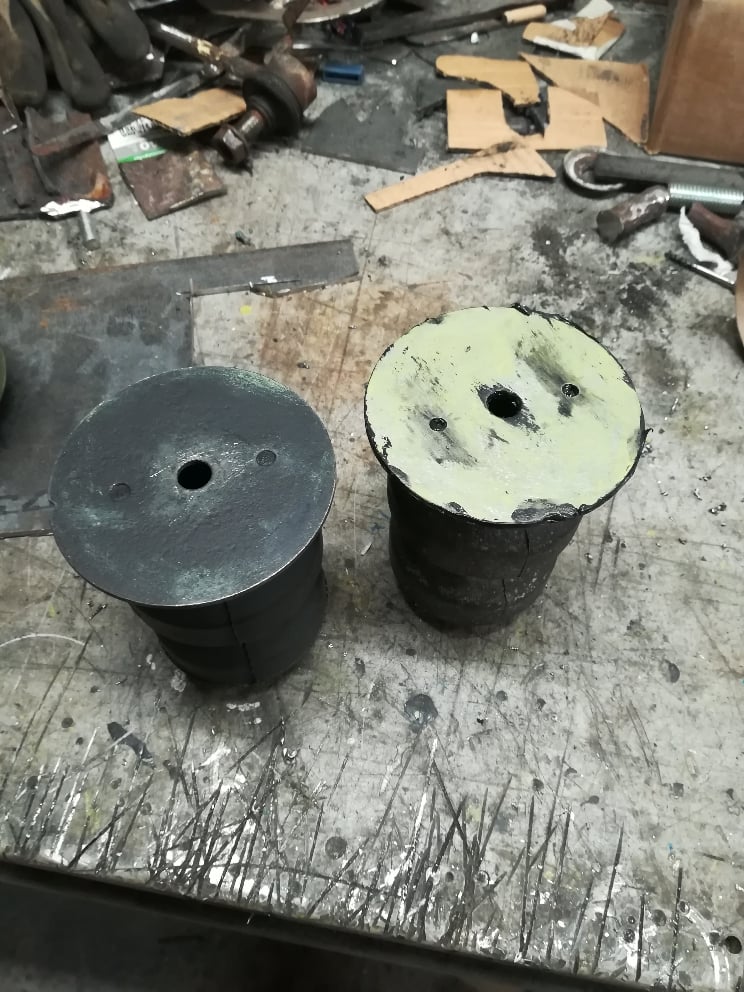

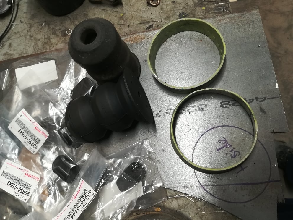

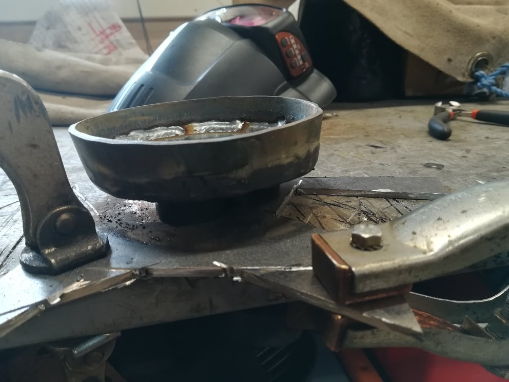

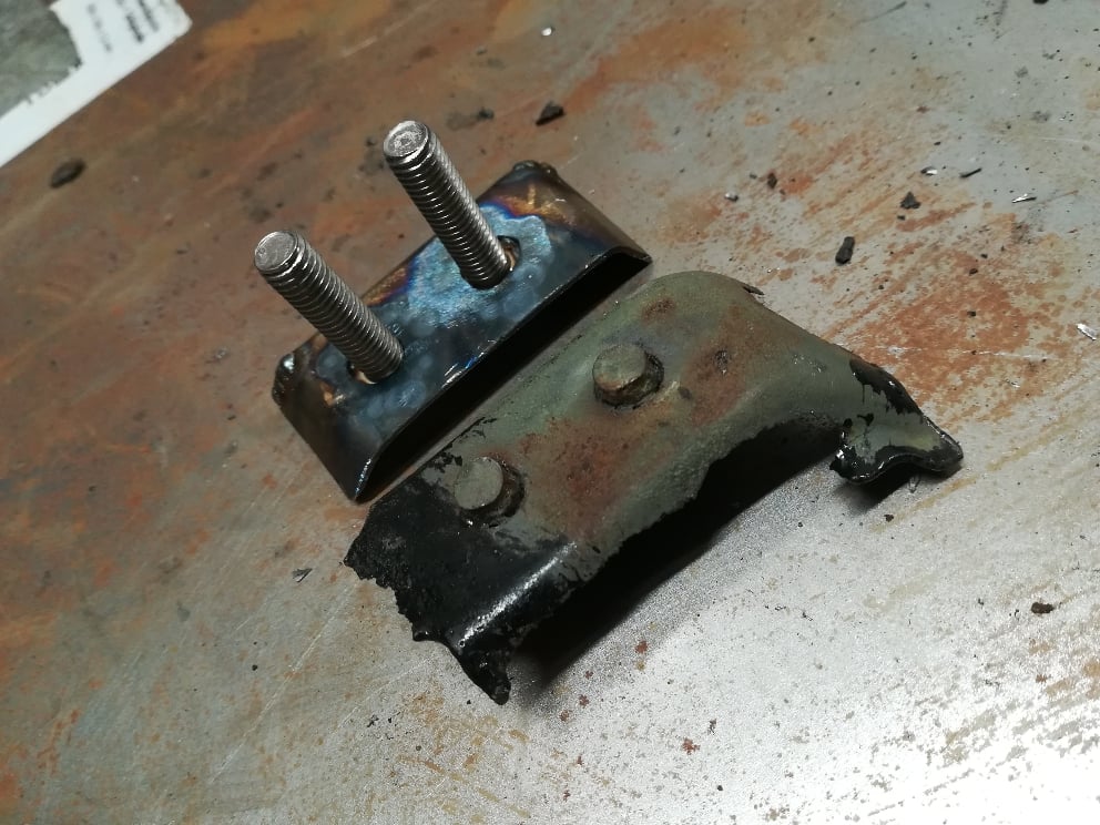

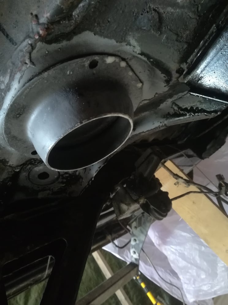

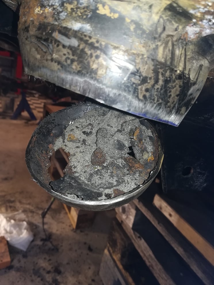

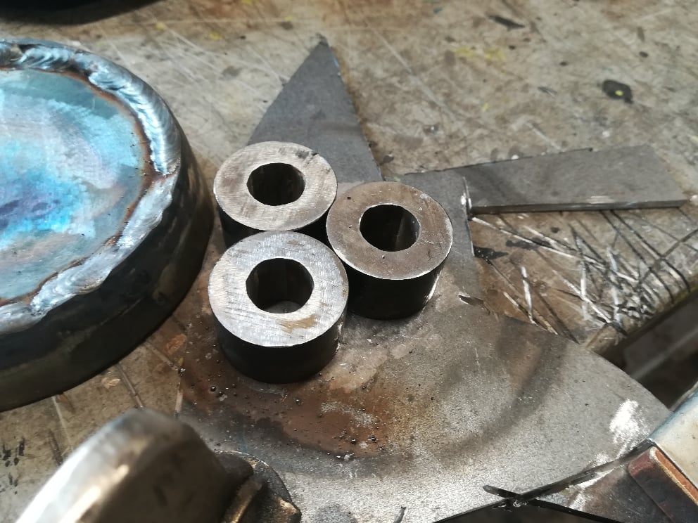

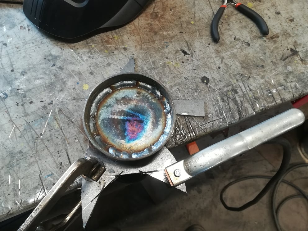

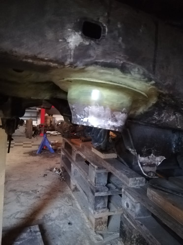

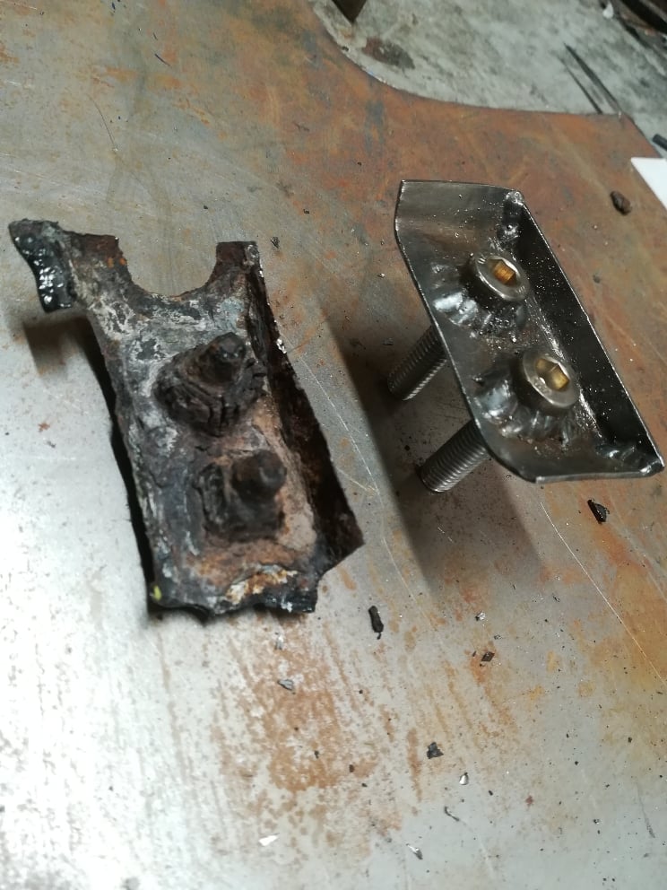

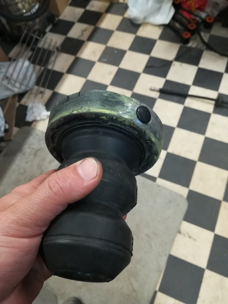

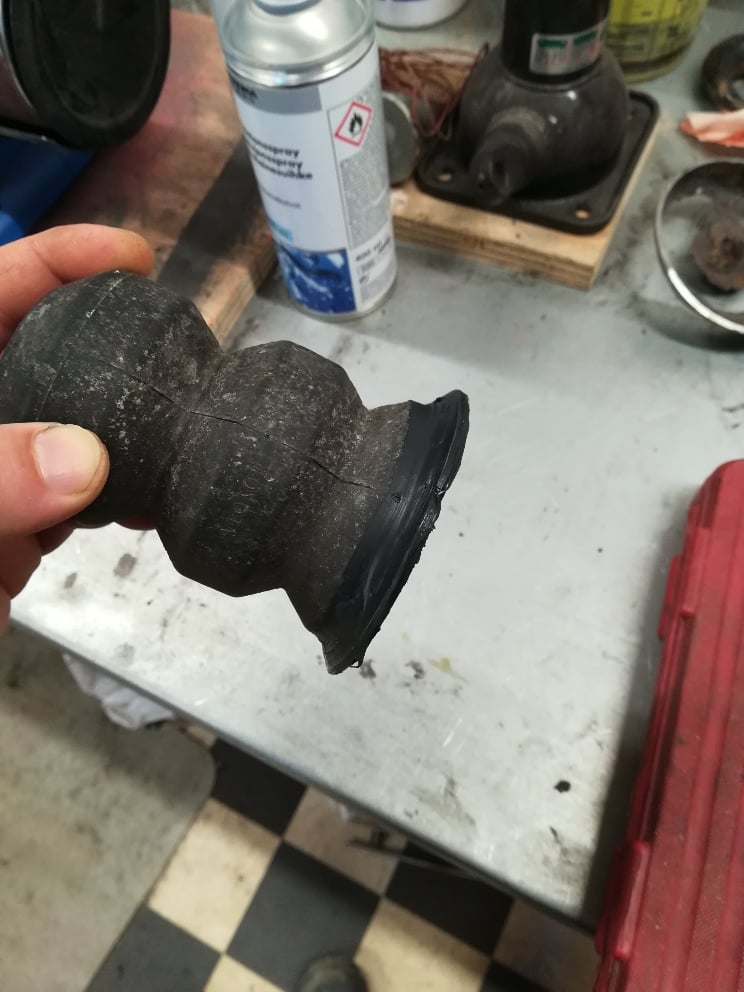

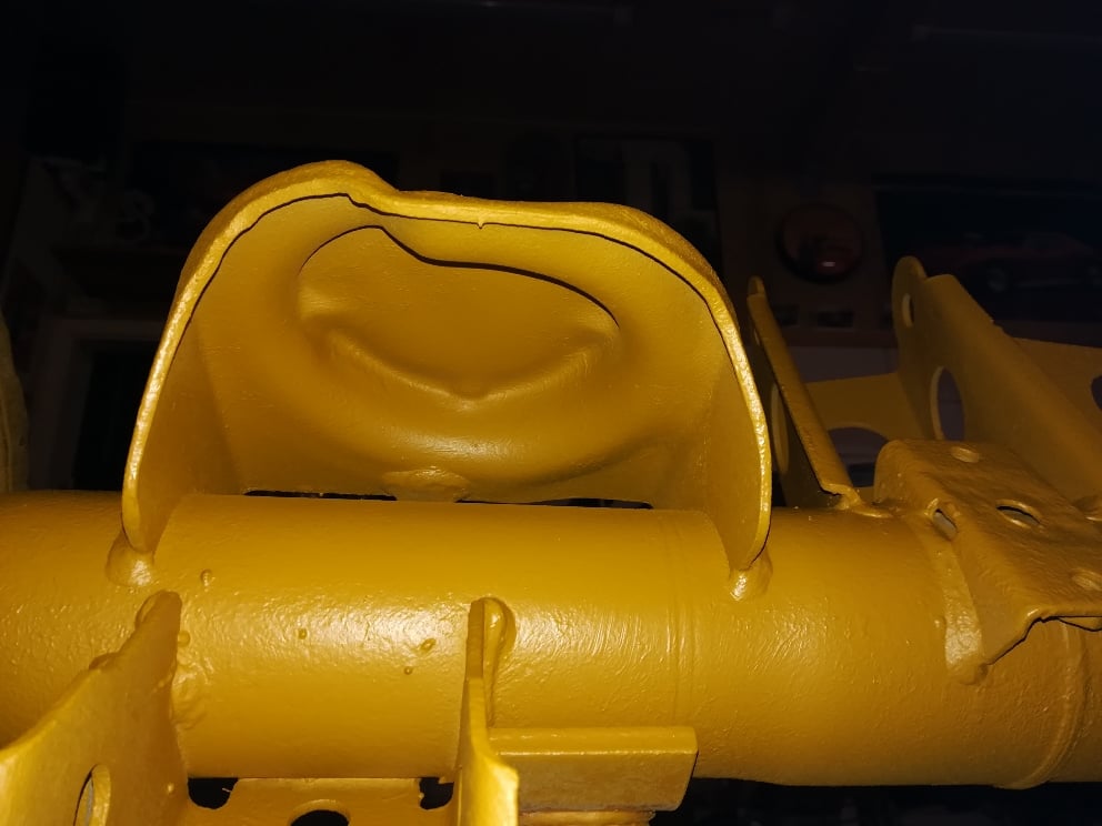

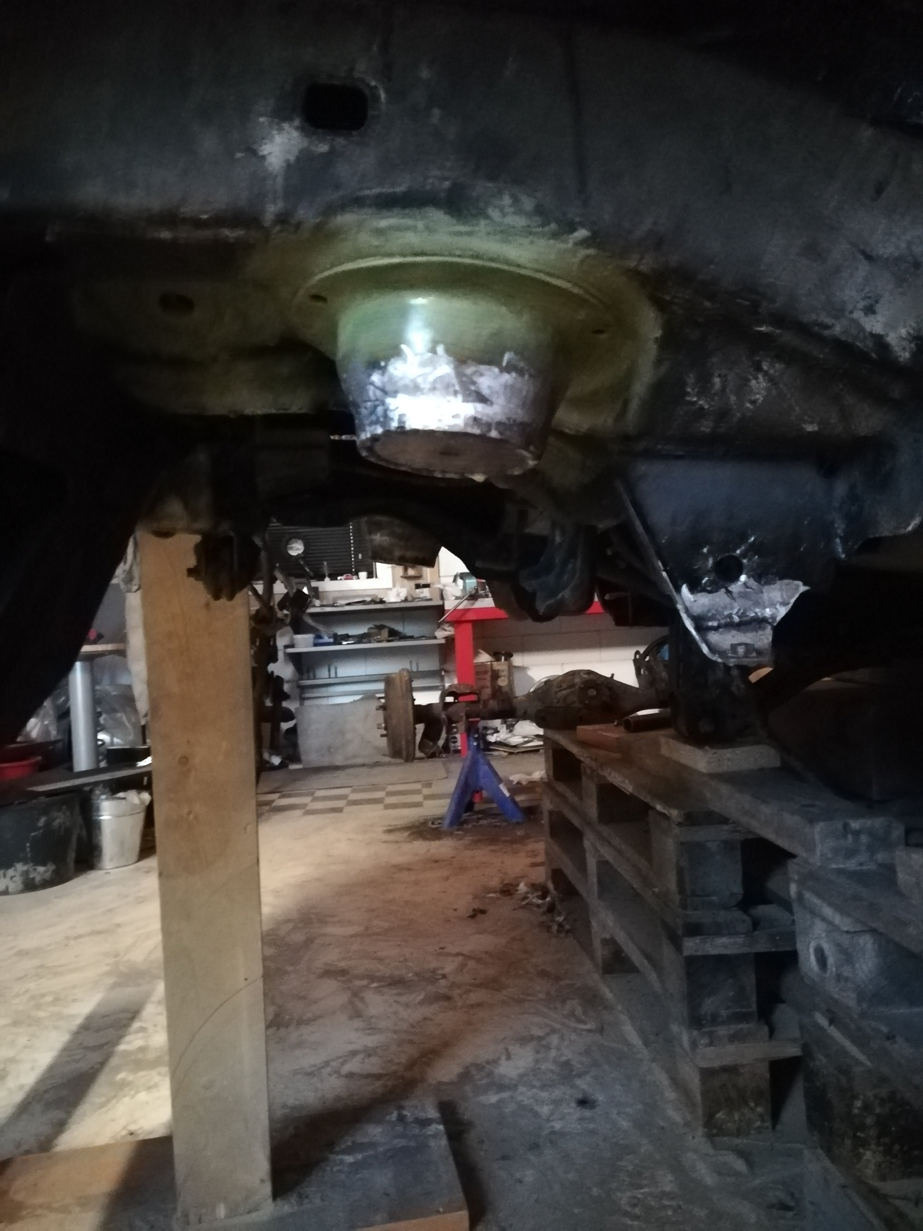

The new bumperstop cups are ready to weld in, i make a drain hole aswell if it will comes water down there later, anyway noe i can grease it inside to protect it from rust. the original is a rust trap, mine was full of water when i make holes in them. I bought a new rubber boob cause i missed one.. expencive but worth it.. the other one i cut a new disk and glued it on, so i can reuse it.
Got time today to weld in those bumper cups.
This time i decide to grind down those welds flush with the steel..

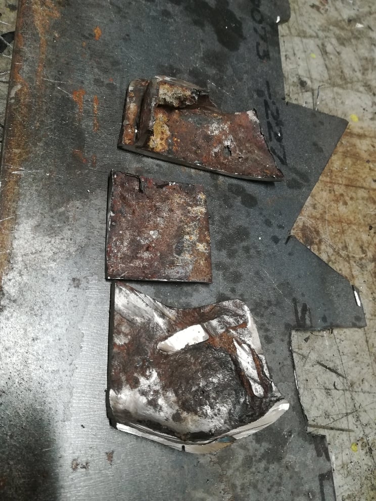

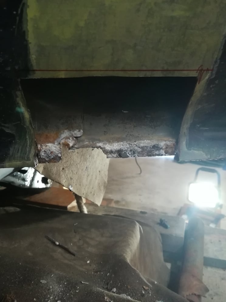

Frame is done... i think.. tailgate next! preparing new metals that goes in.

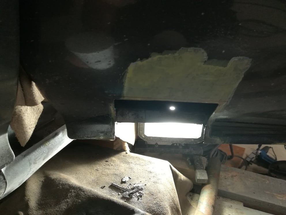

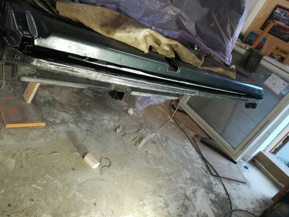

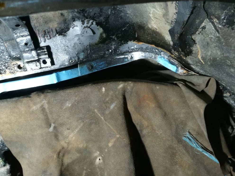

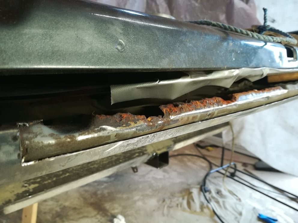

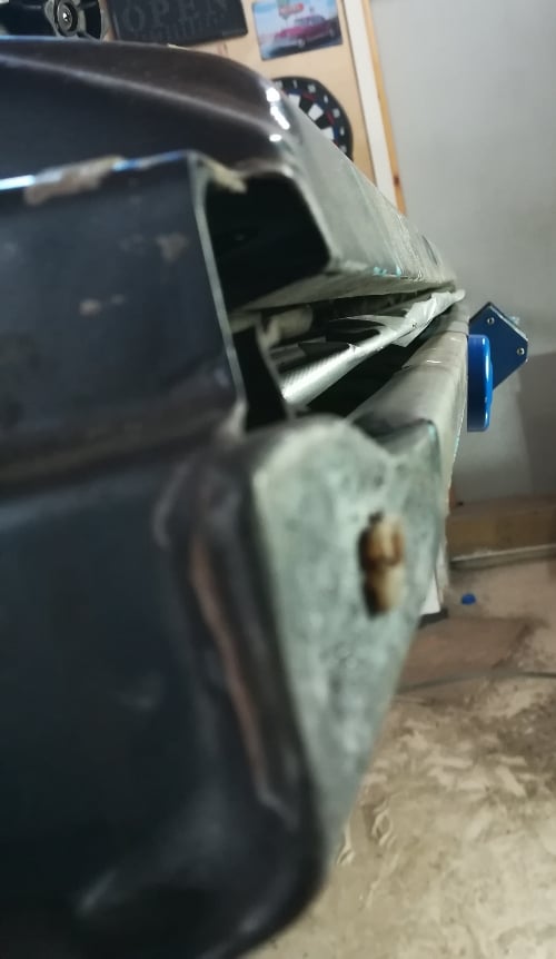

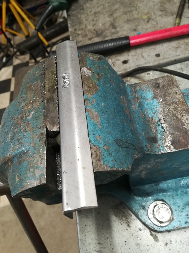

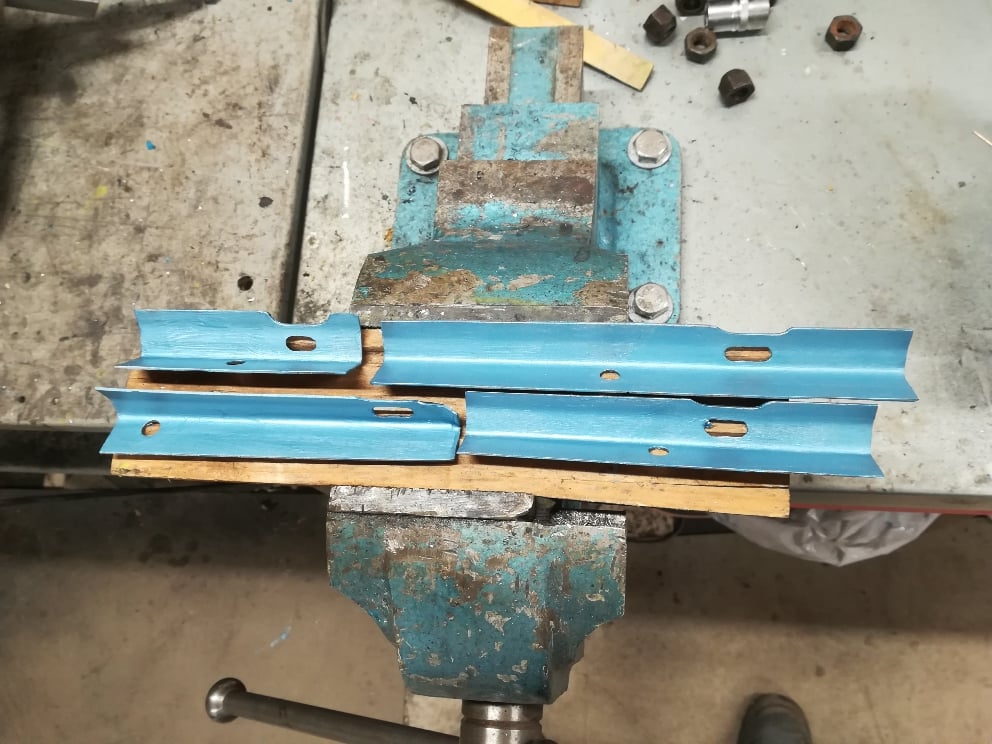

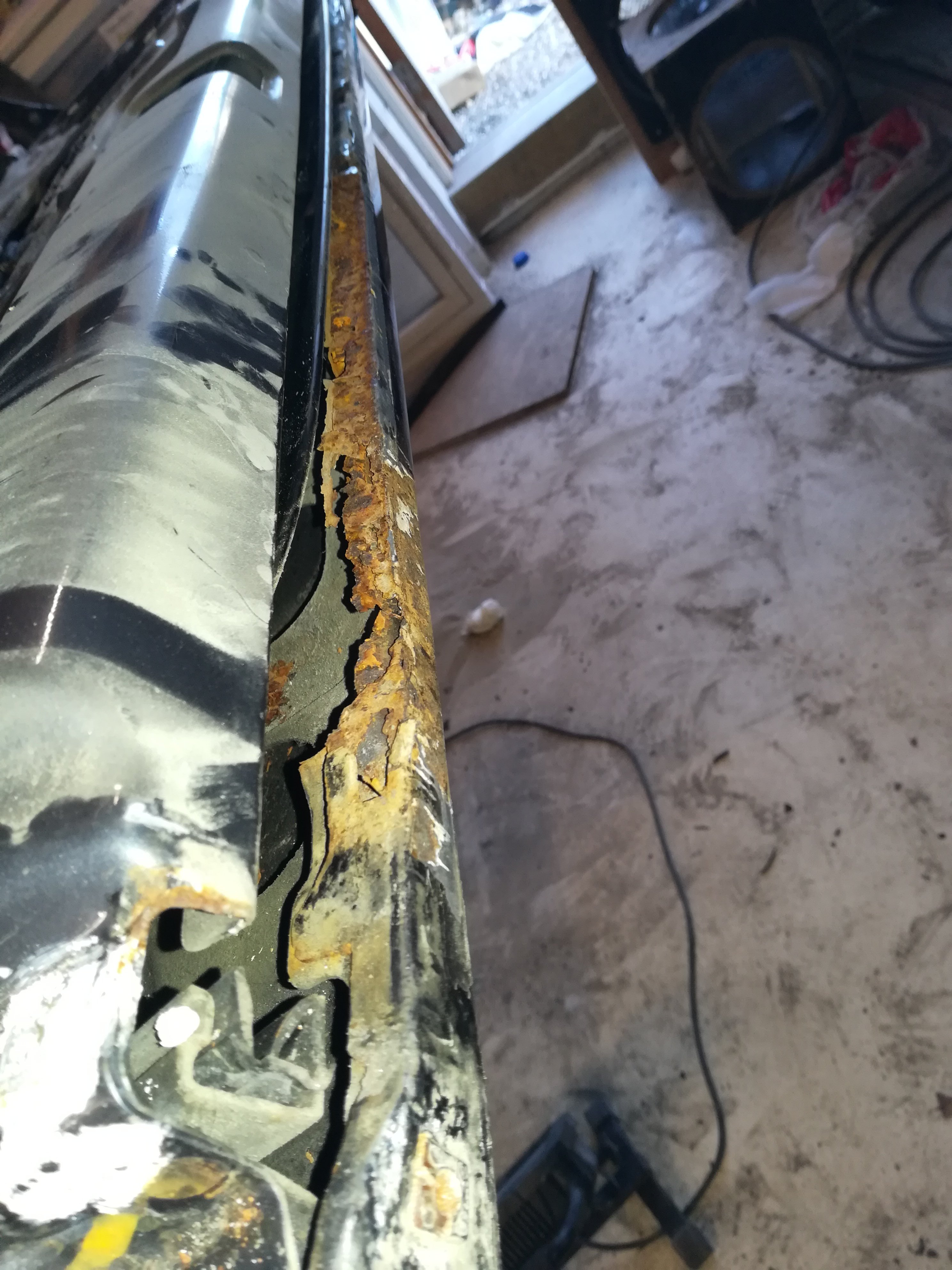

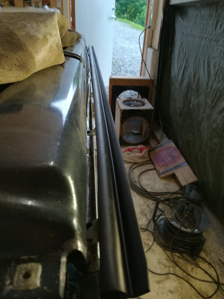

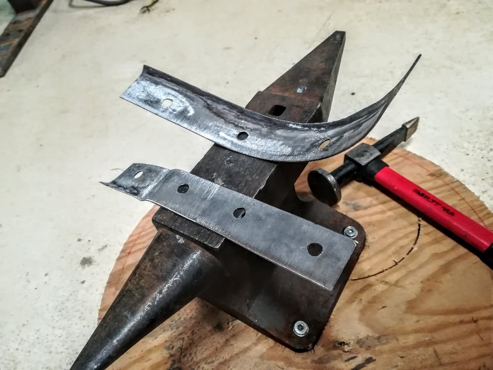

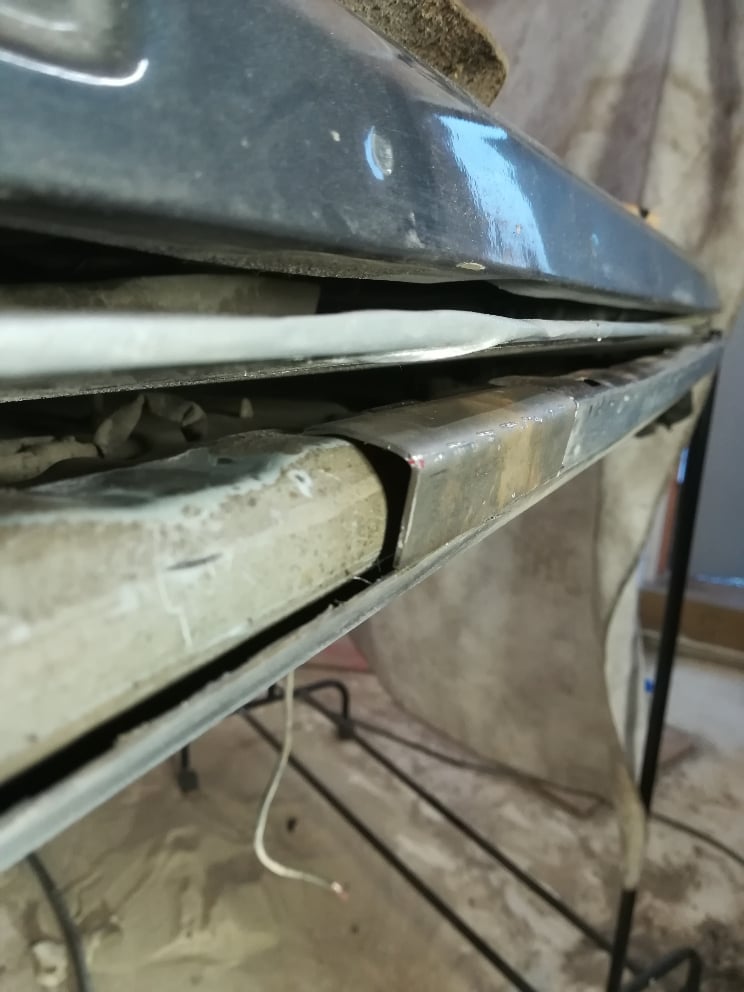

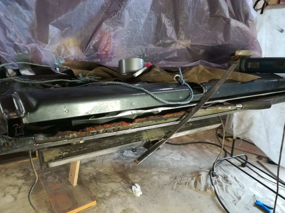

So the tailgate is finish welded, i think i will trow on some 2k epoxy primer, since part of the car will have a new paint anyway.

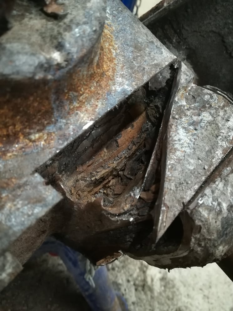

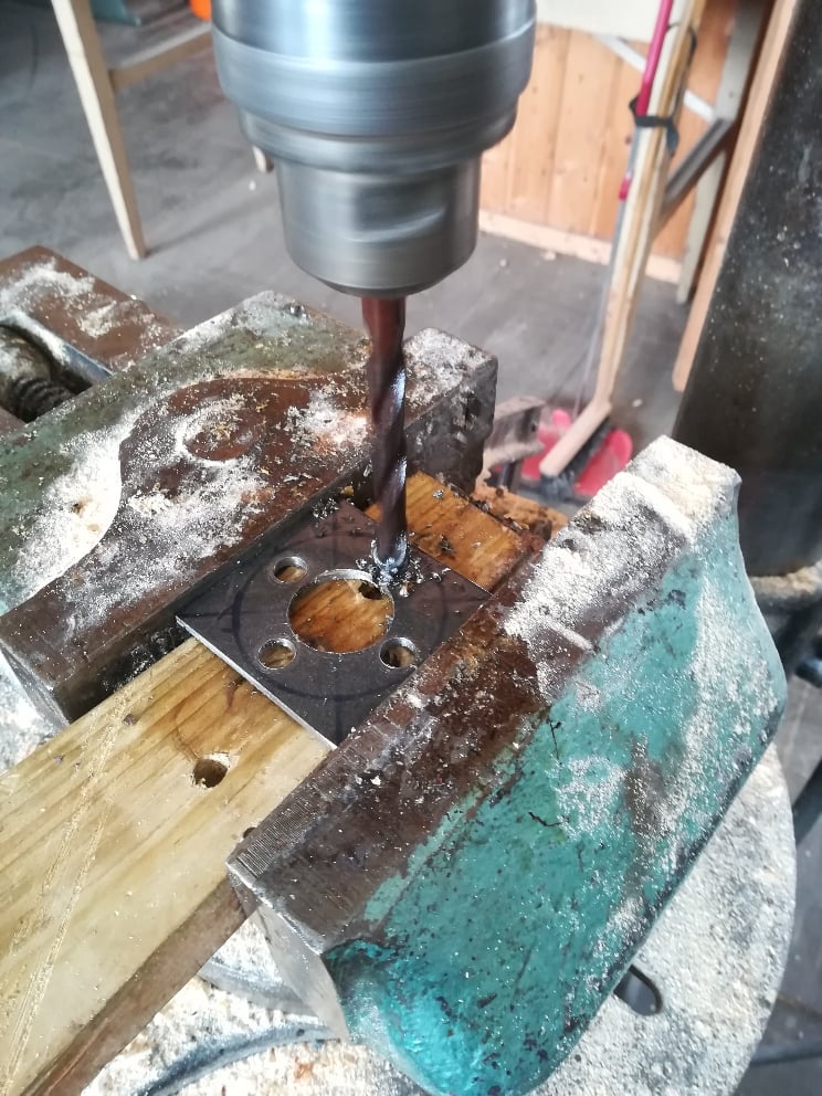

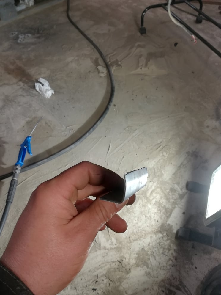

The new metal plates i make new holes for the window rubber list mounting clip as well.. wrong way on the picture btw.

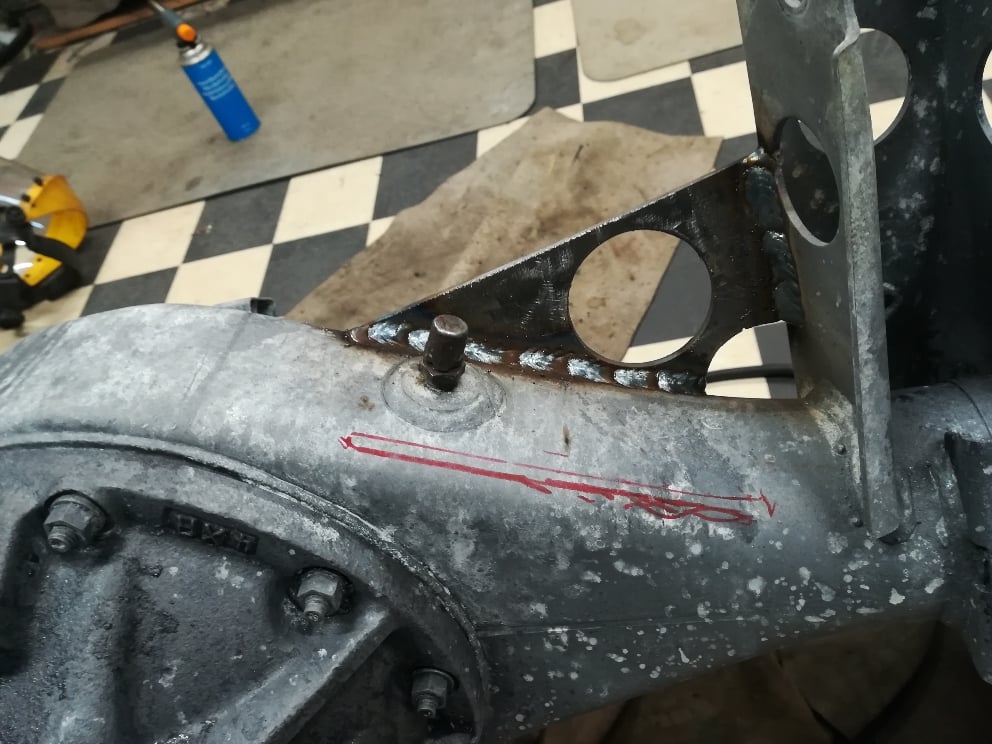

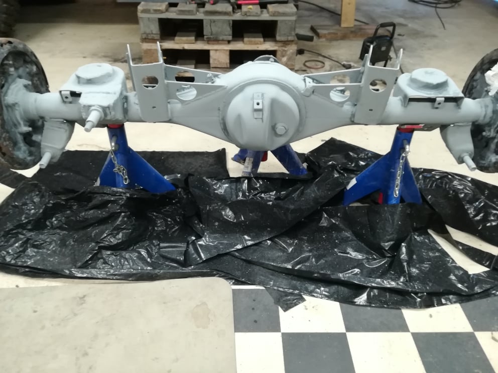

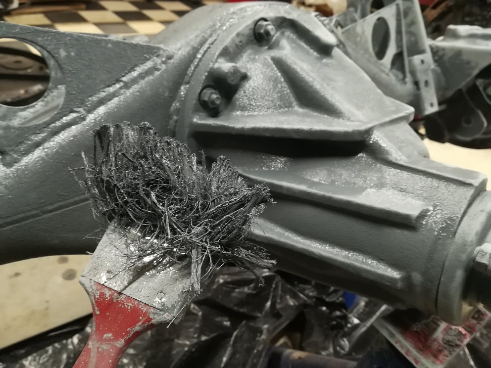

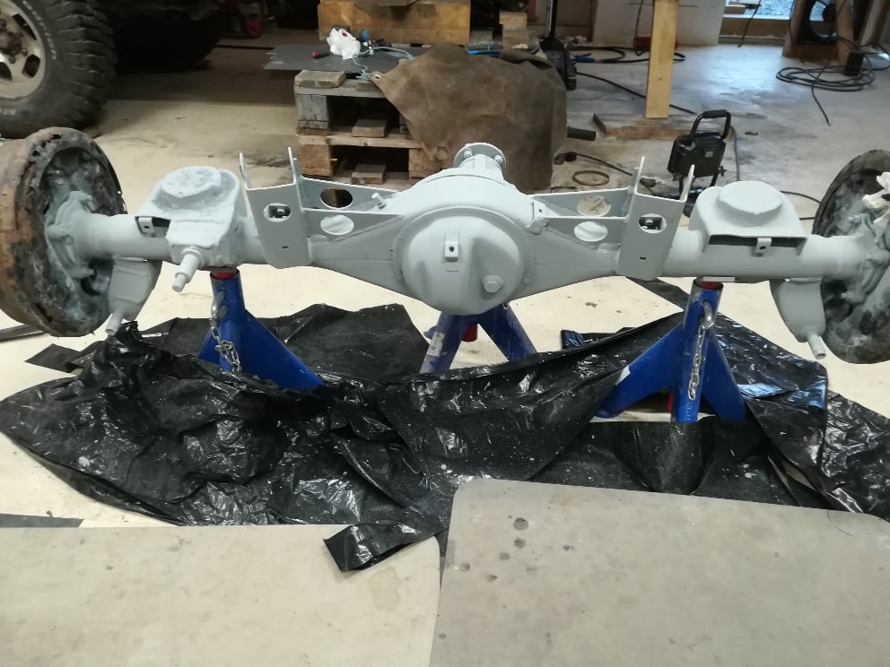

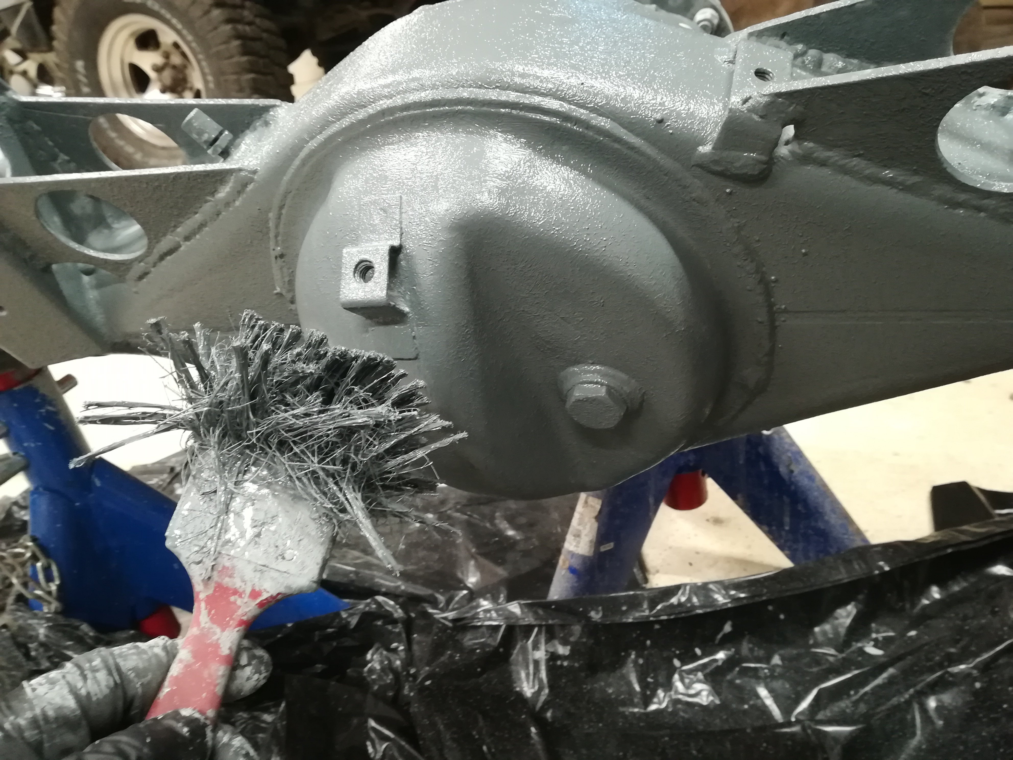

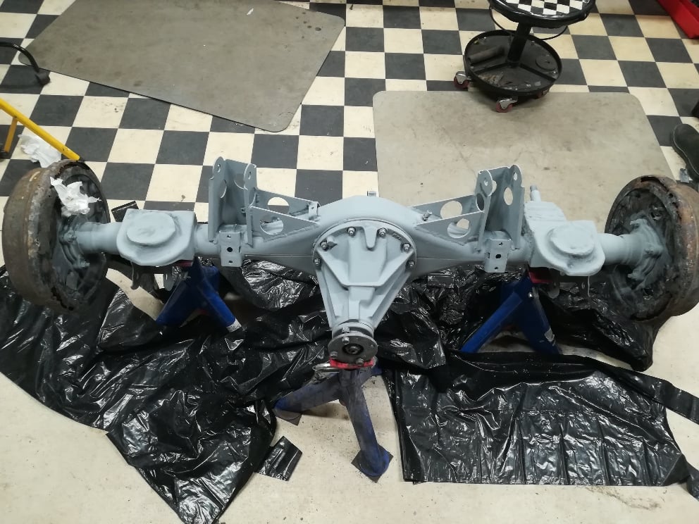

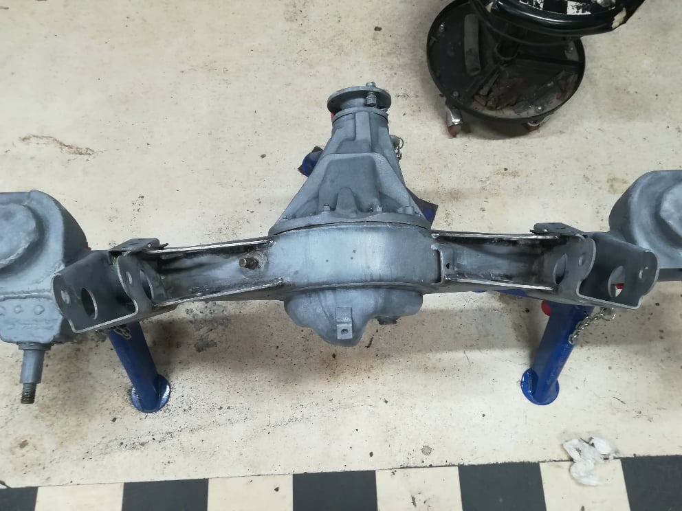

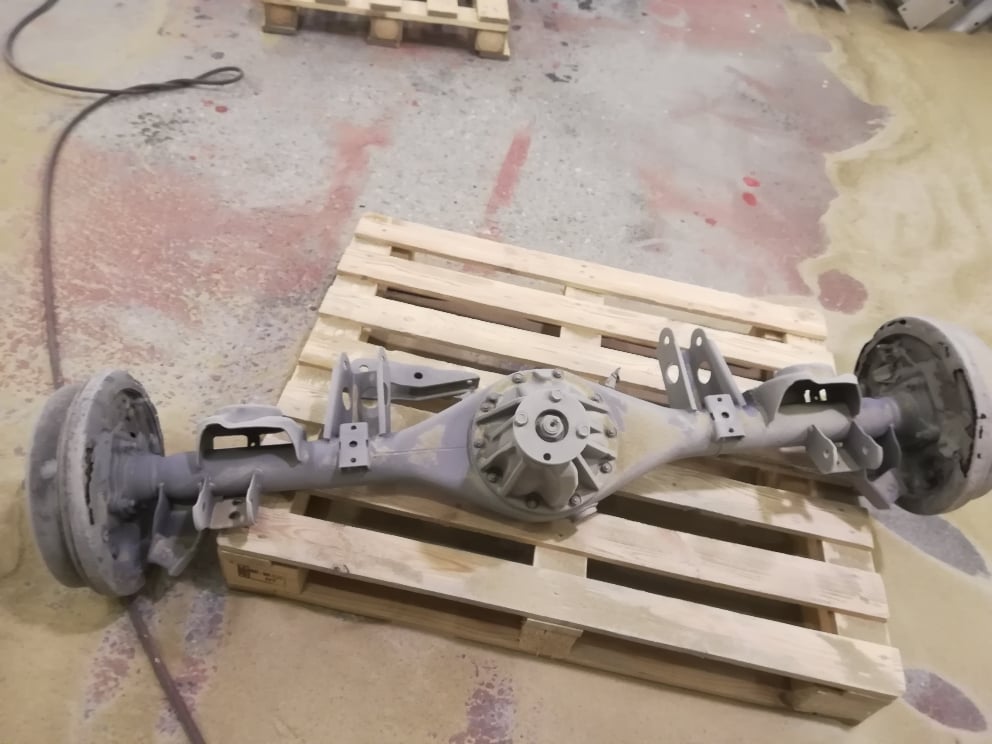

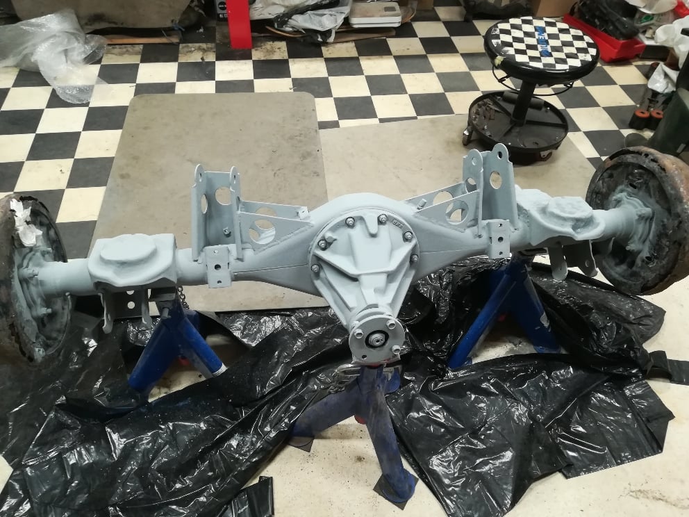

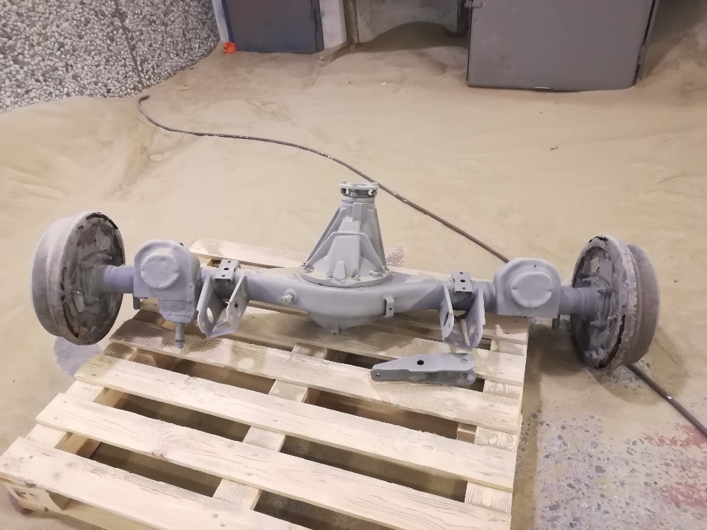

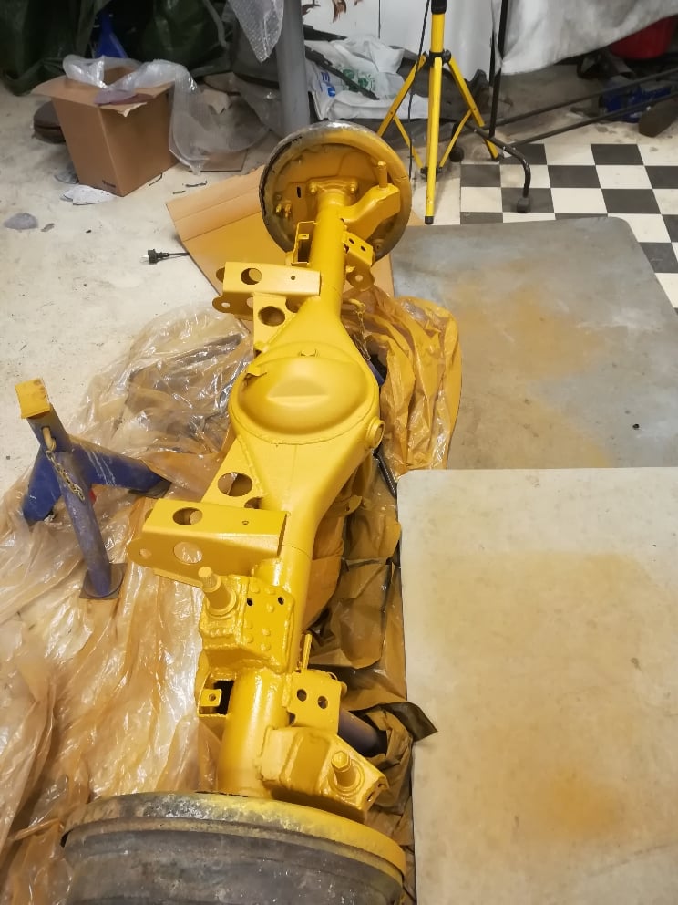

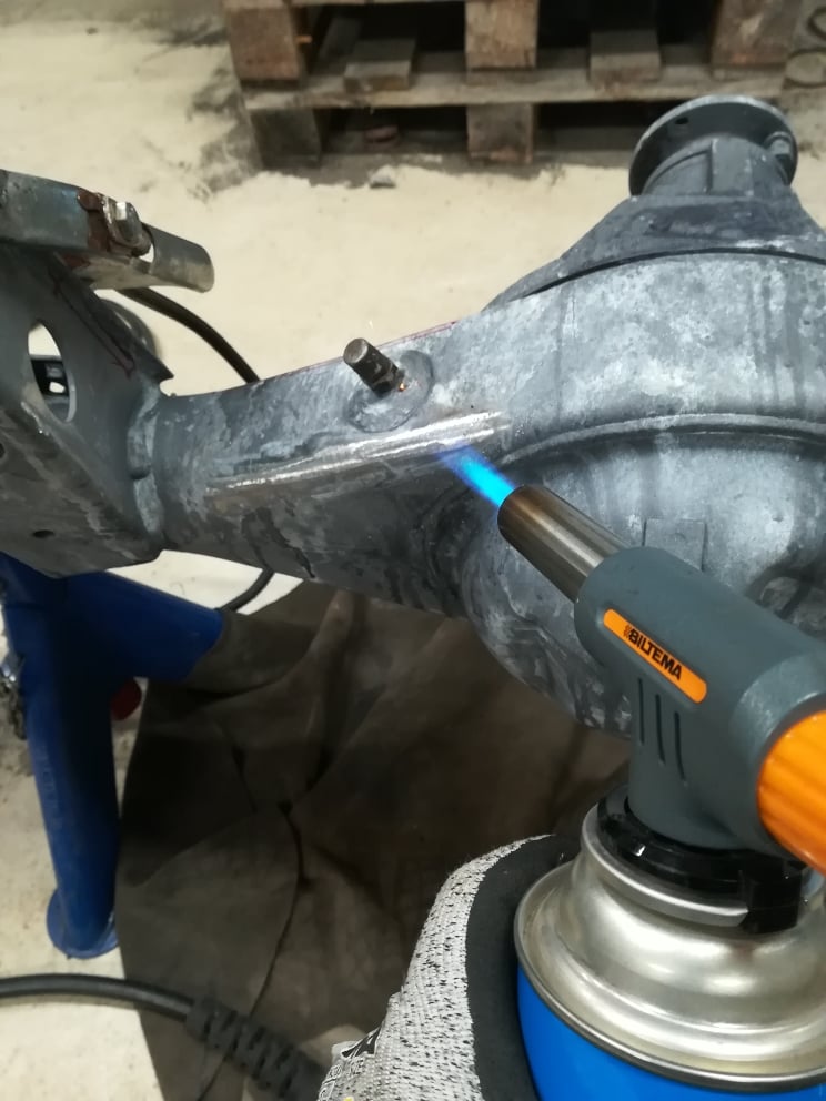

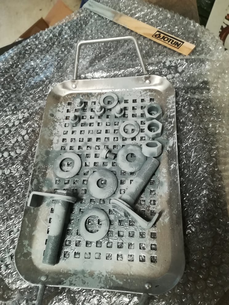

Rearend sandblasted, got it home and added some bracings and coat it with Zinga galvanizing layer.

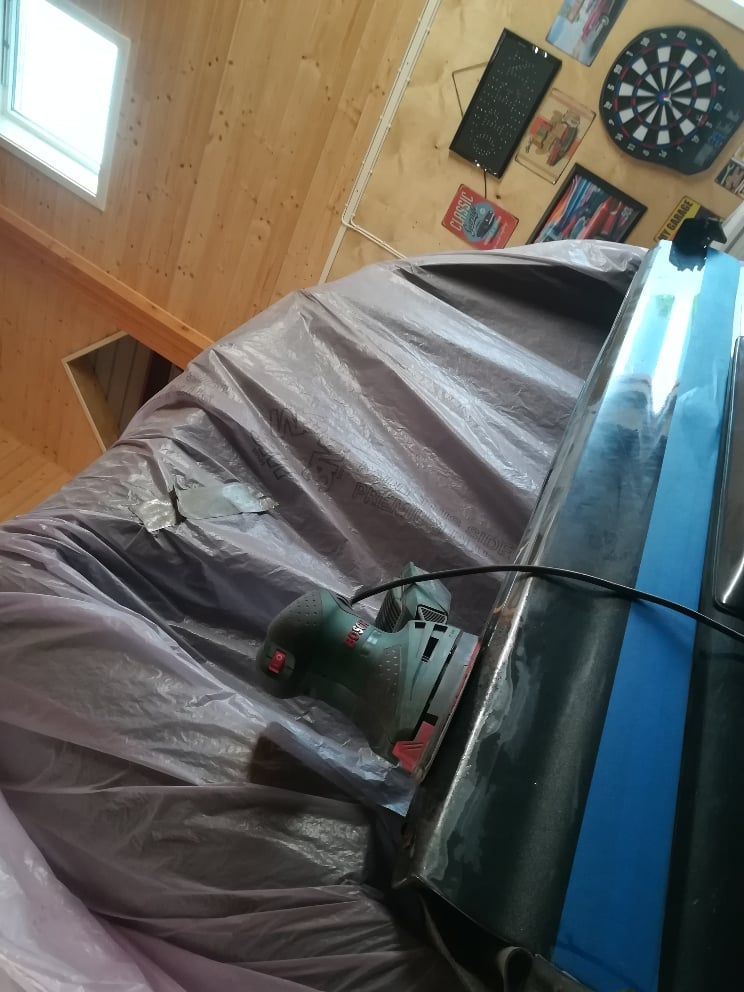

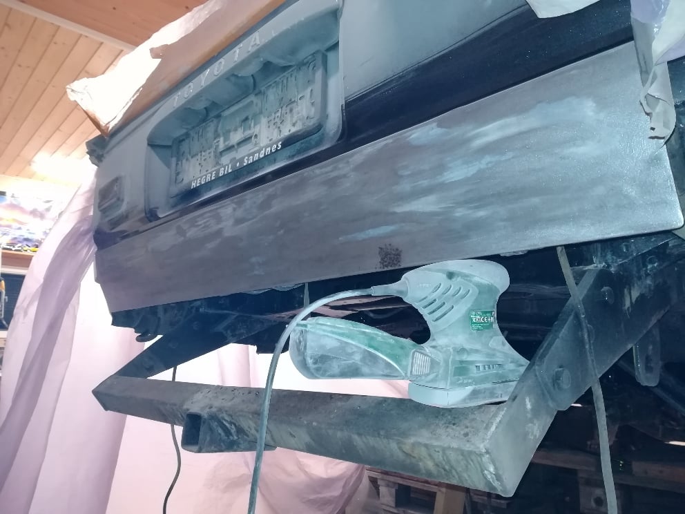

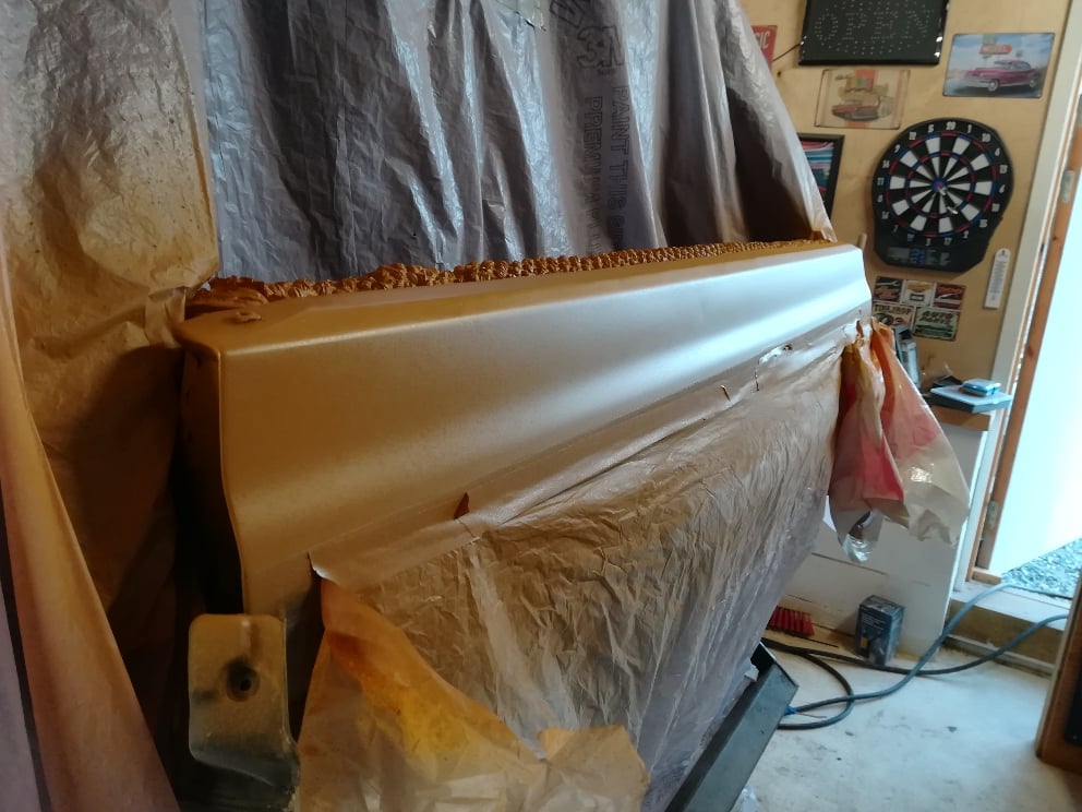

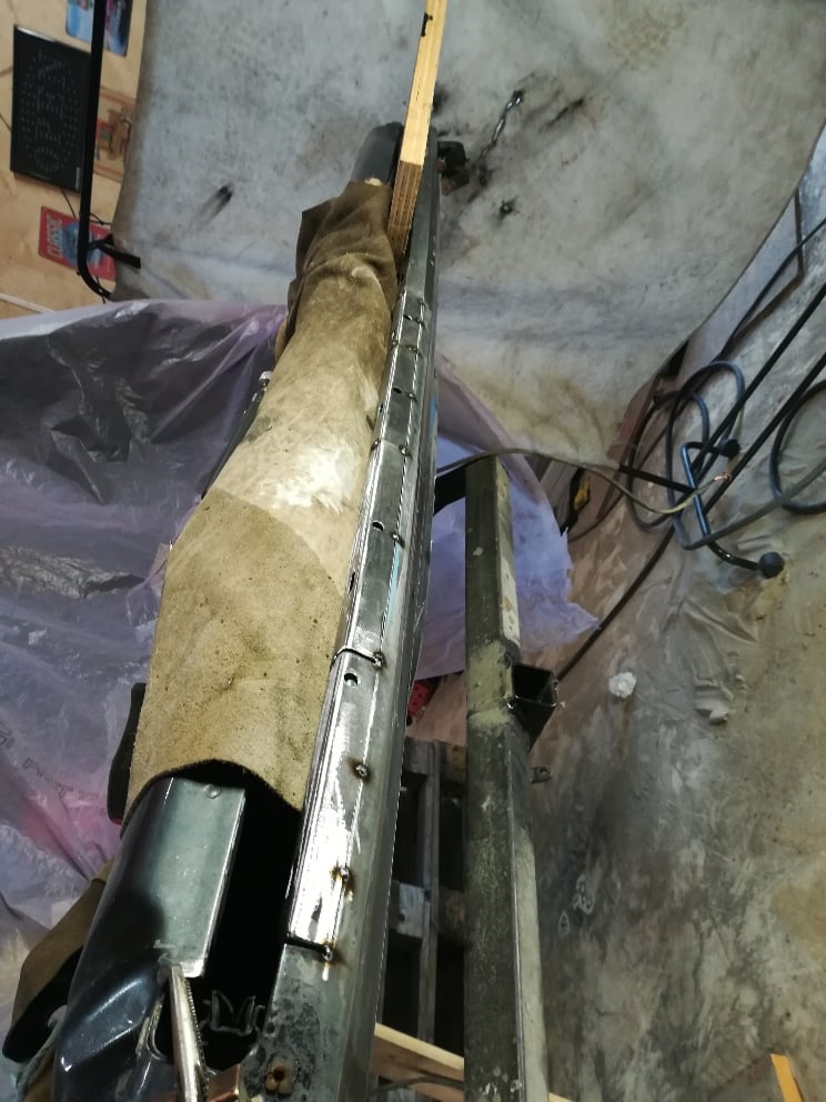

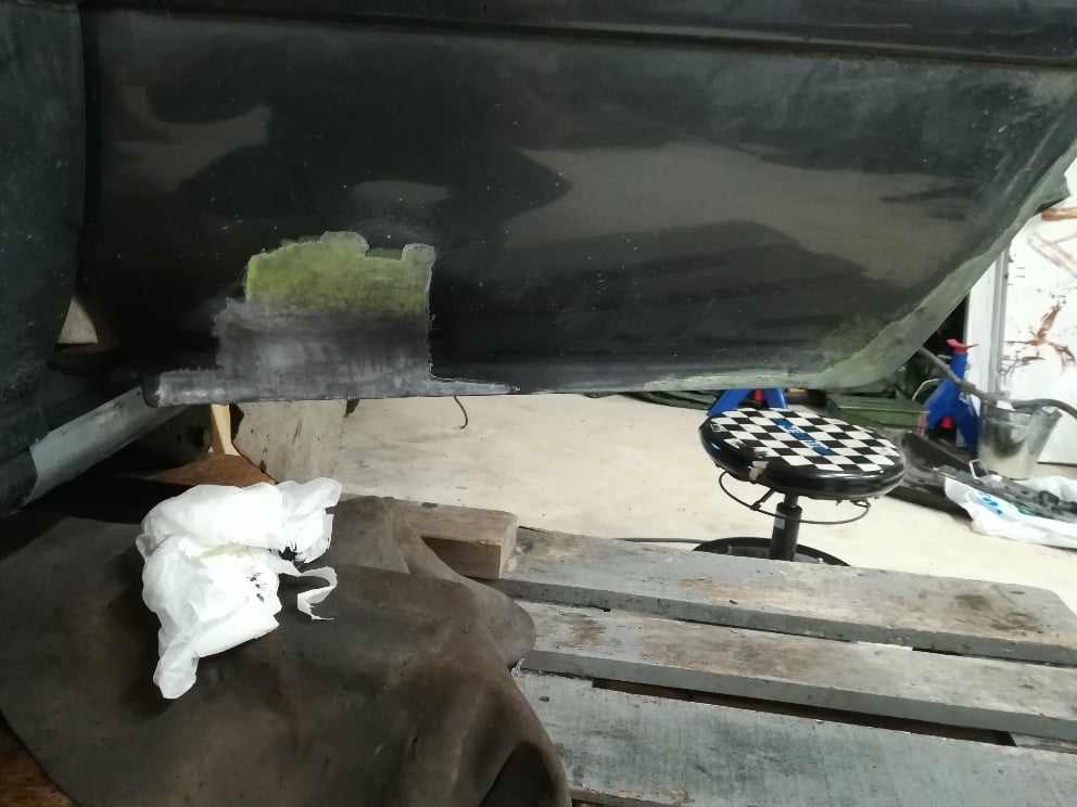

Begun to sand down the lower part of tailgate door, cause i want to paint most possible when it is ready, doors, fenders etc.. the axle and upperpart on the tailgate is ready for paint after some layers of 2k epoxy primer.
