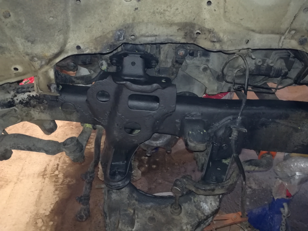

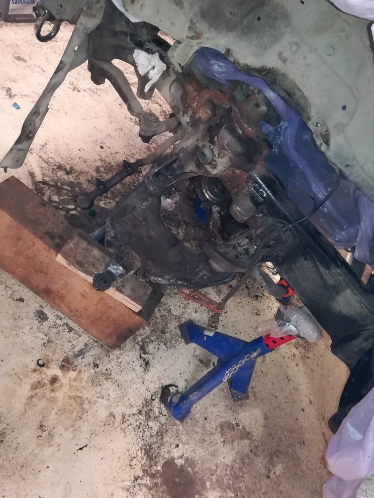

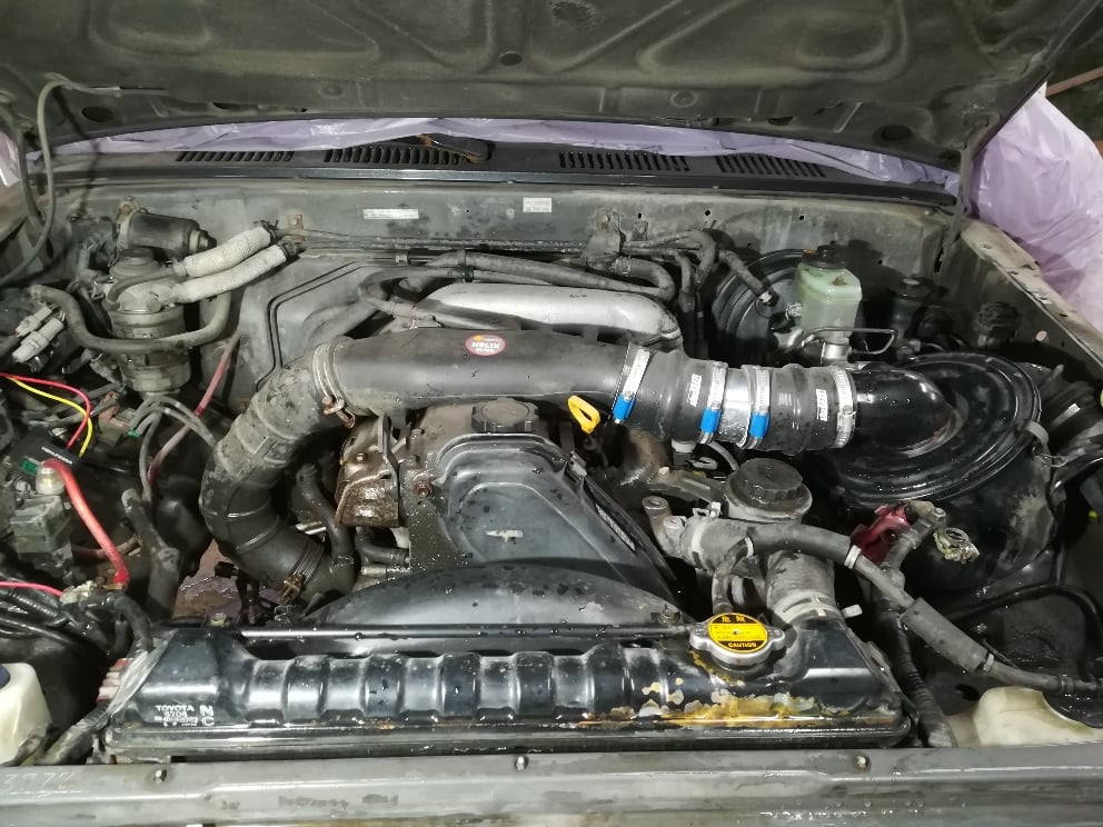

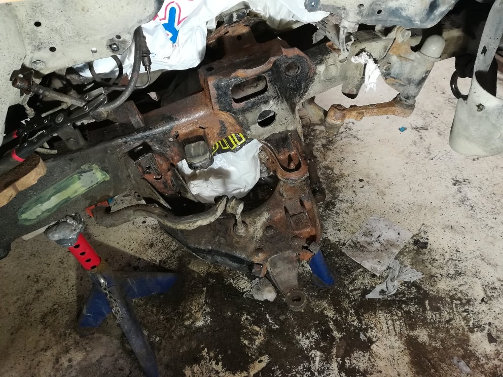

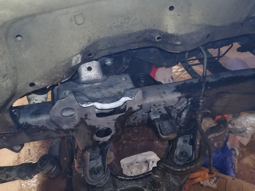

Finally done with this part today,.. i have a bit bad sandblasting equipment, but some hours later i got rid of the rust i want to get rid of. wash it after with some degrees cleaner and a lot of water.. the engine bay was covered, but dust and sand come thru... so wash that a bit as well... will take a solid wash when the car is done and outside.

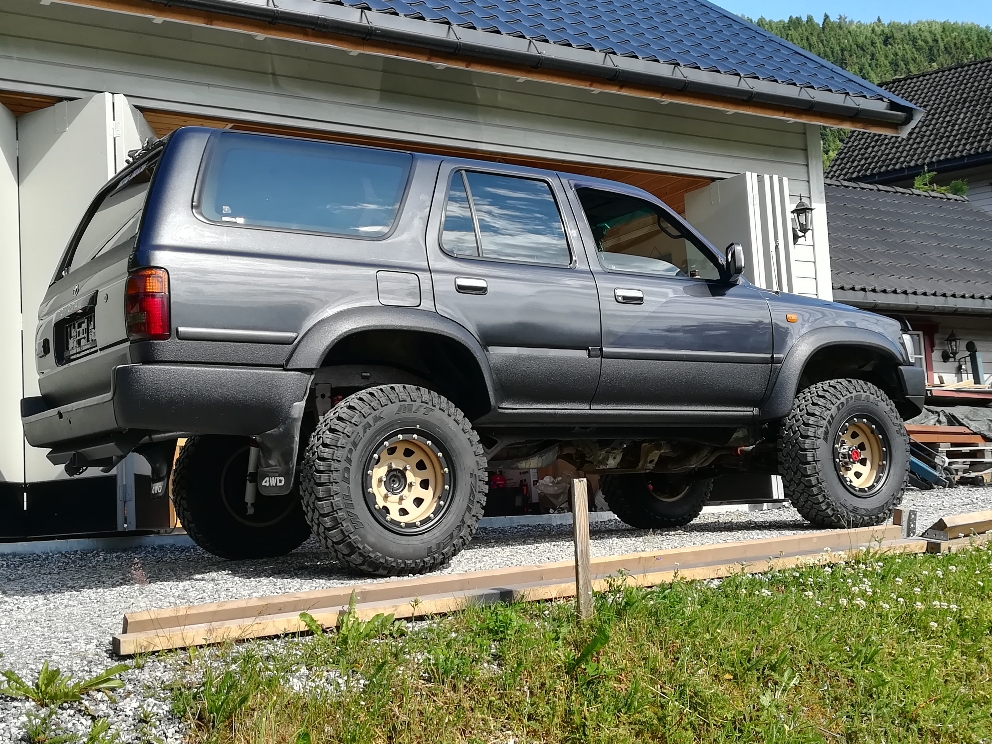

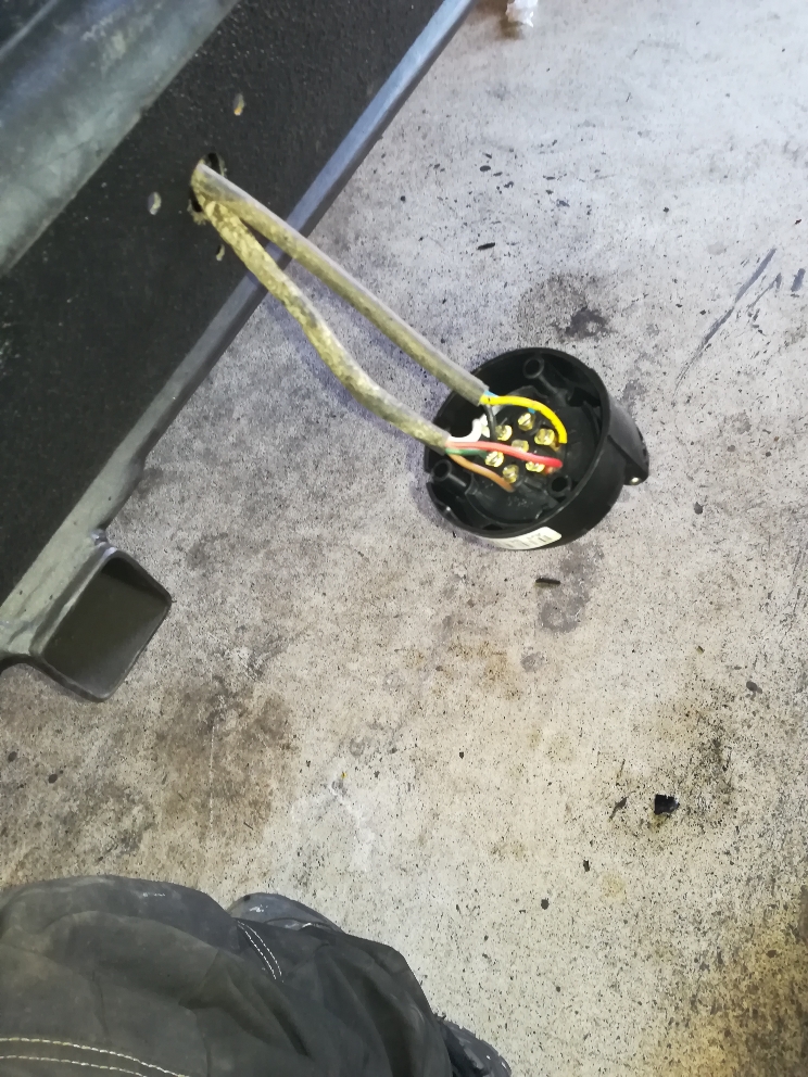

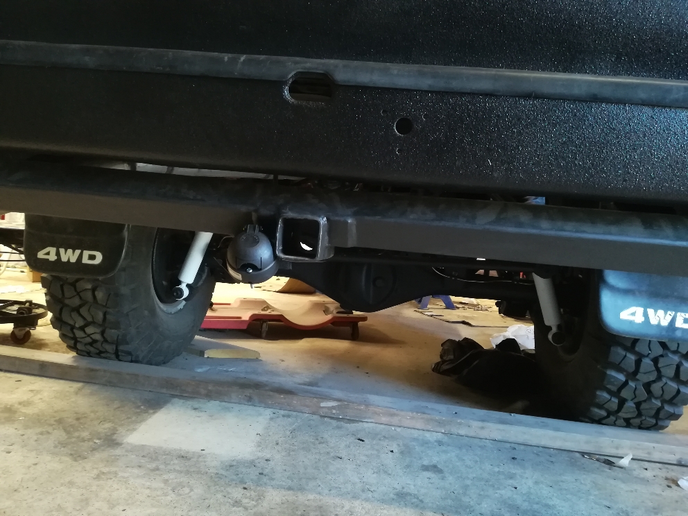

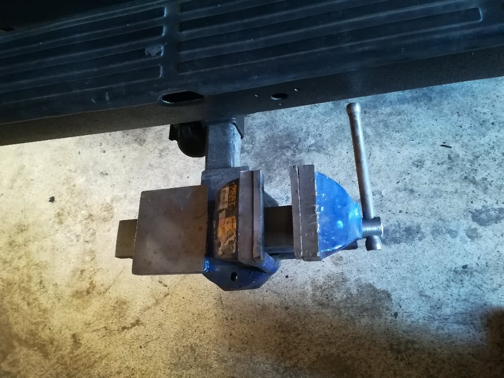

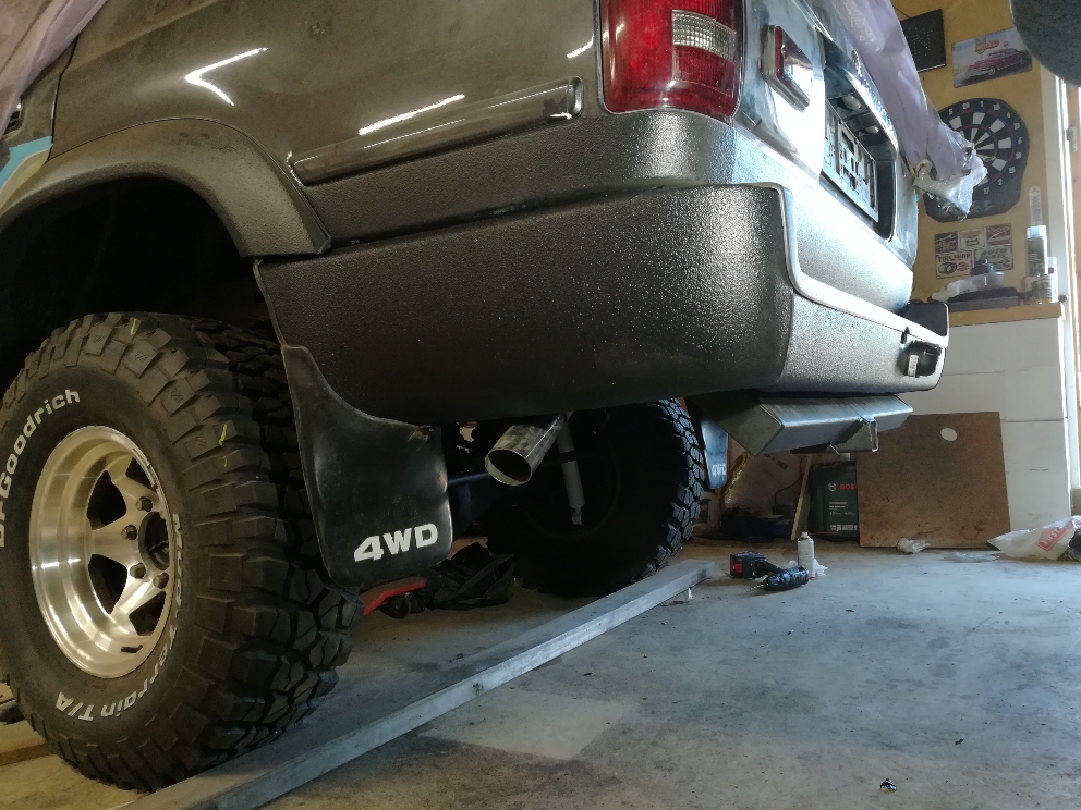

Bumper on.. think i will move down the connectionplug to the towbar instead.

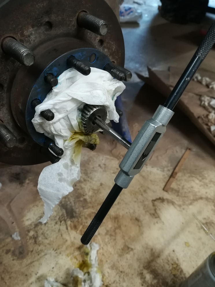

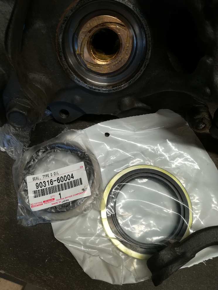

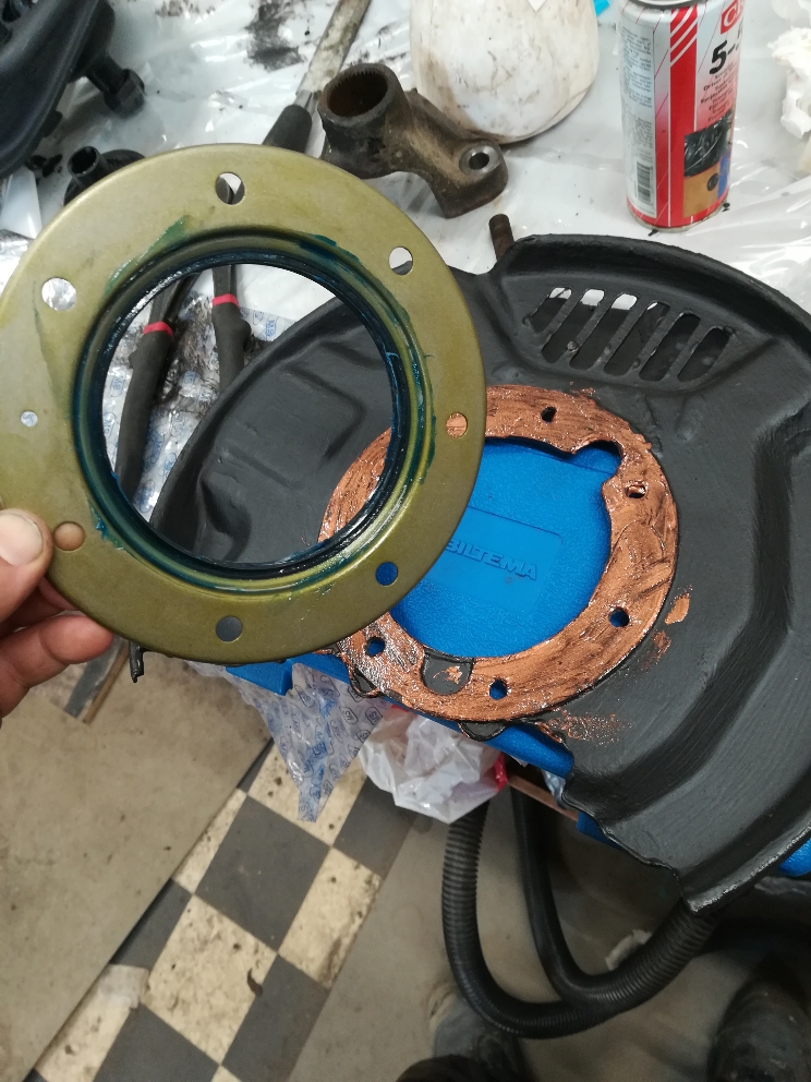

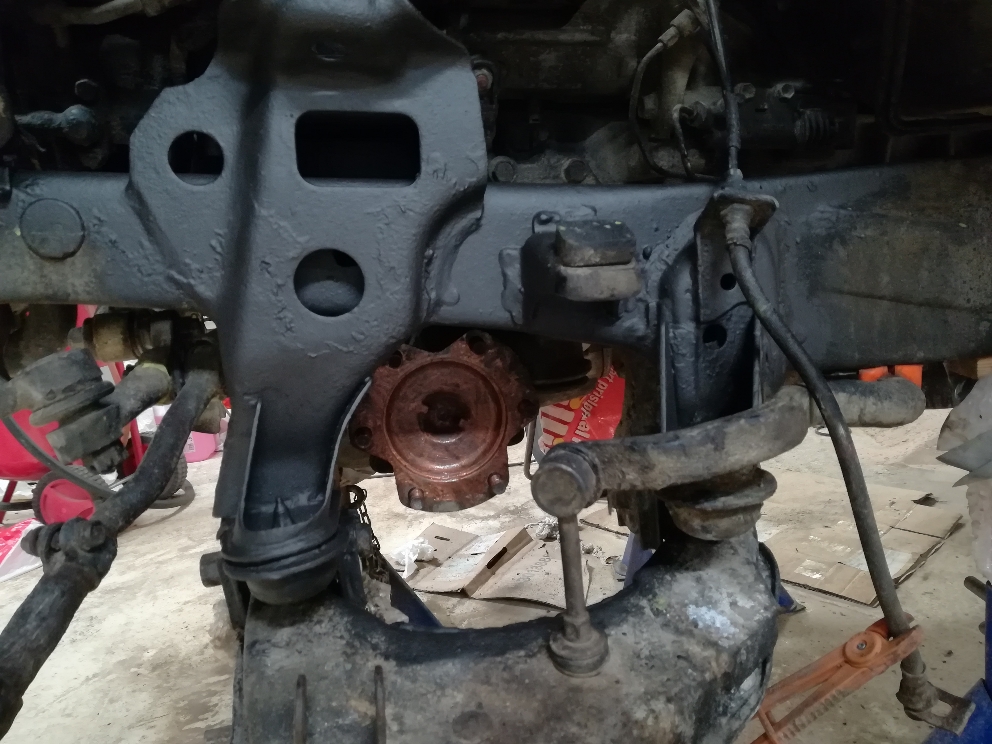

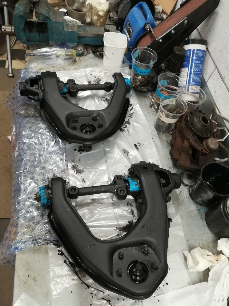

A short visit to the garage today to put on the first layer of Zinga Tarfree coat , also got some OEM parts from Toyota, the correct seals for my steering knuckles/spindles.

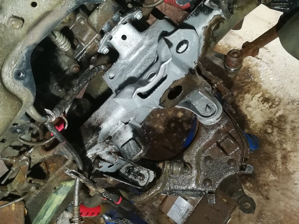

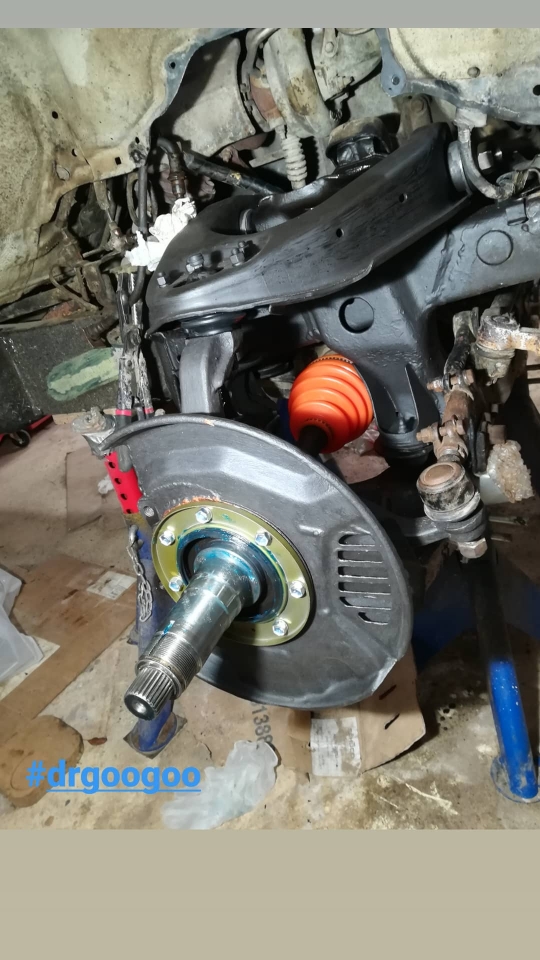

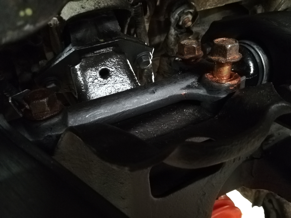

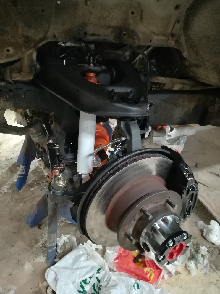

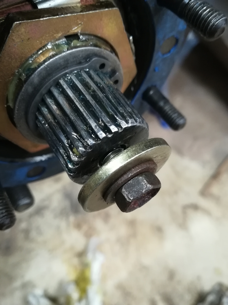

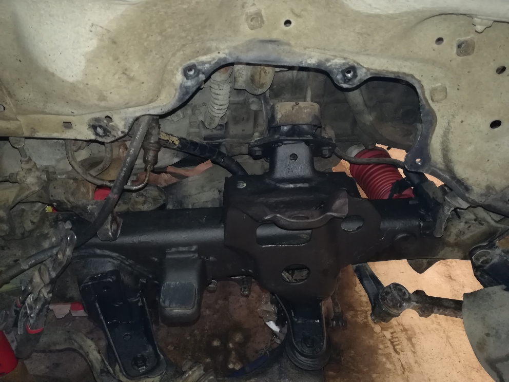

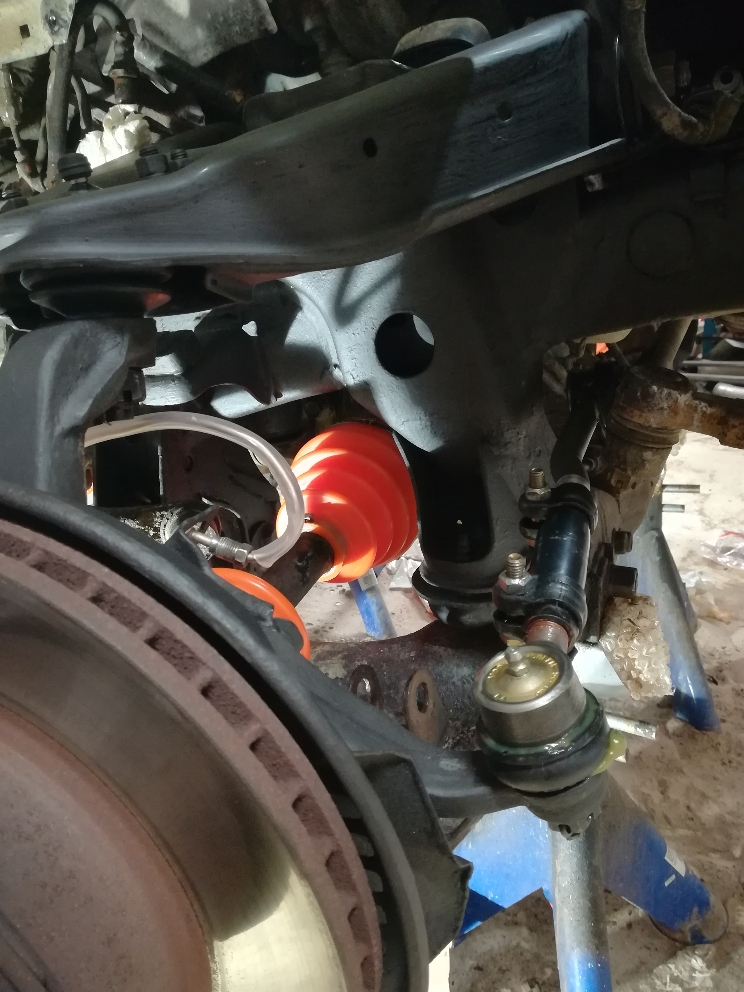

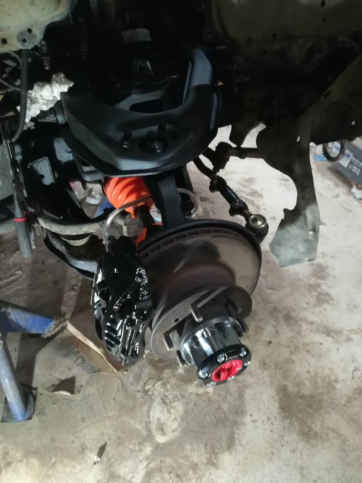

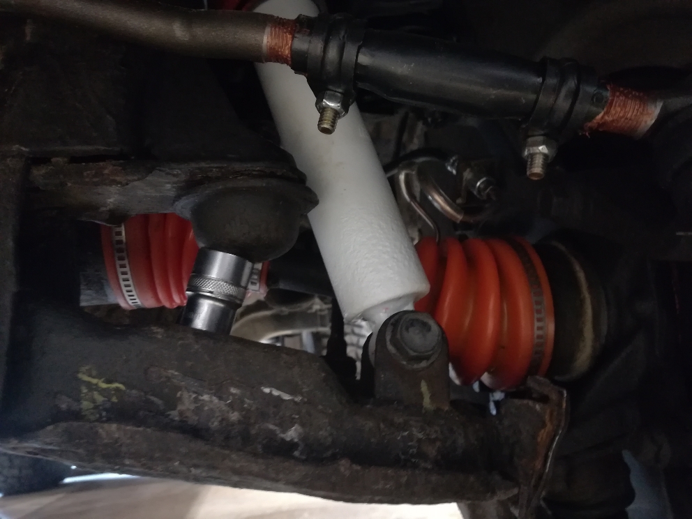

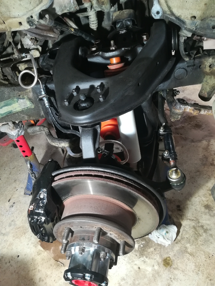

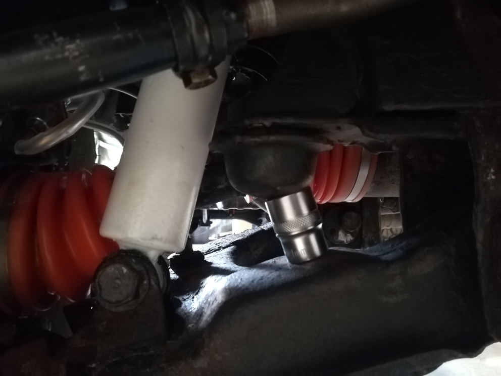

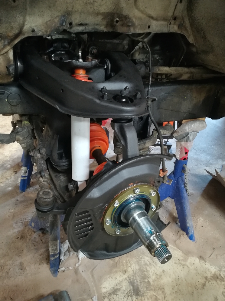

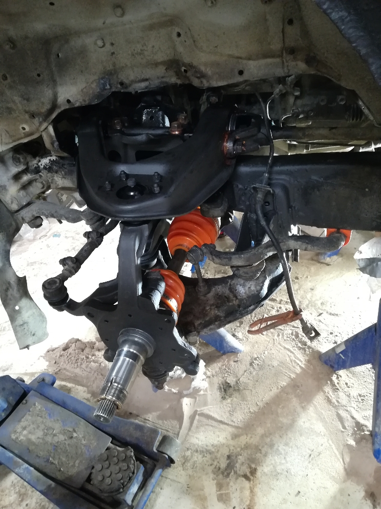

Begun to install the front susp tonight and torq all the bolts exept of Torsionbar bolts and tie rods cause those will be to the end. have some new Moog "problem solver" tierods i will use.. just have to line up everything first.

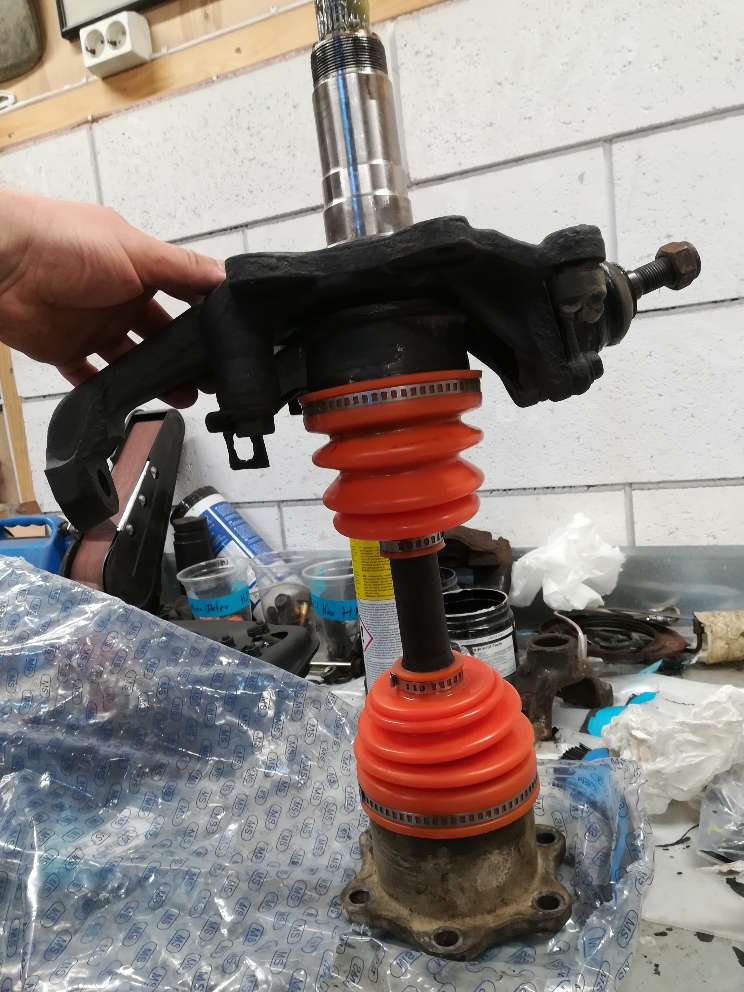

Yesterday i moved down the electric plug for the towbar and prepare the steering knuckle with new seals and the upper control arms. new grease in both torsion bar ends, used copper paste on all bolts before installing.
Sent fra min WAS-LX1 via Tapatalk

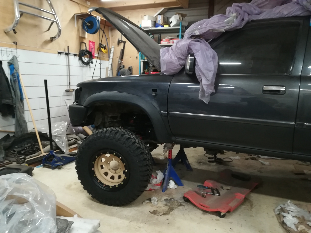

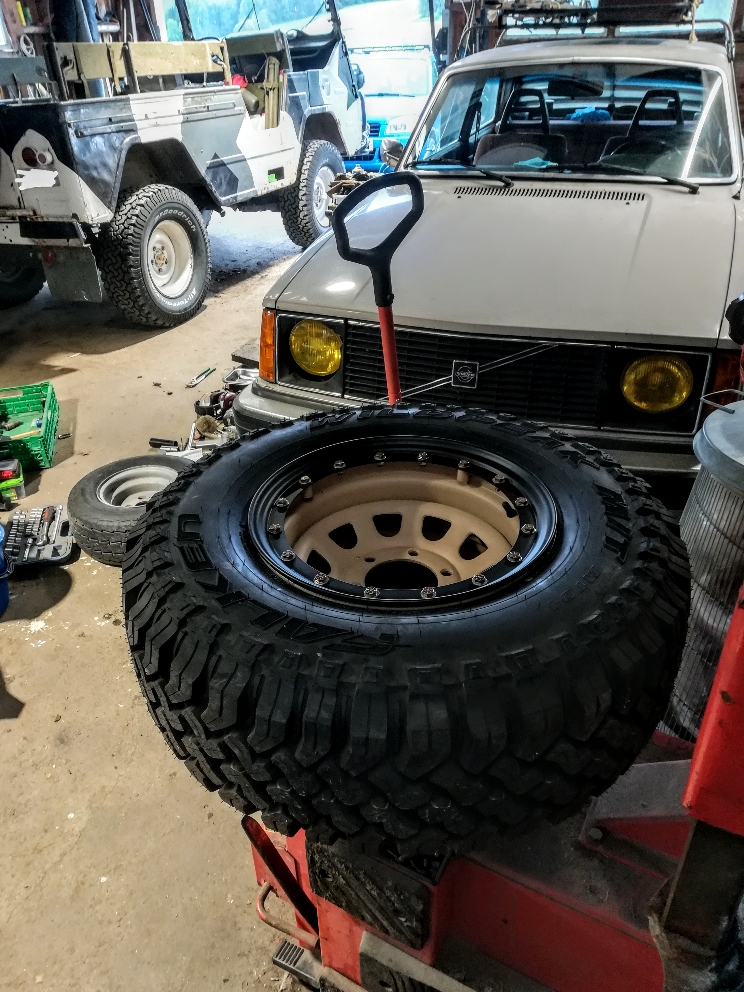

Got the tires today so visit my neighbour and borrow the machine to pop them on.

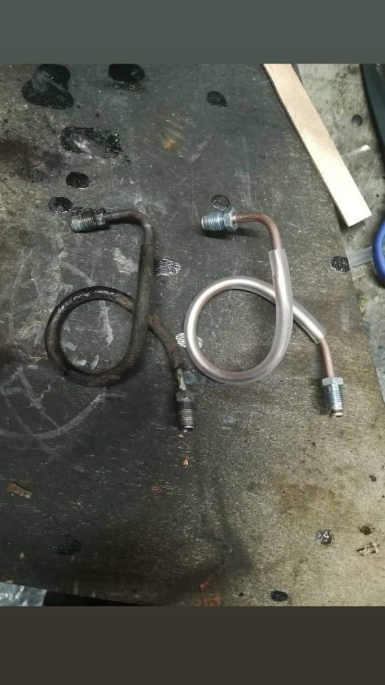

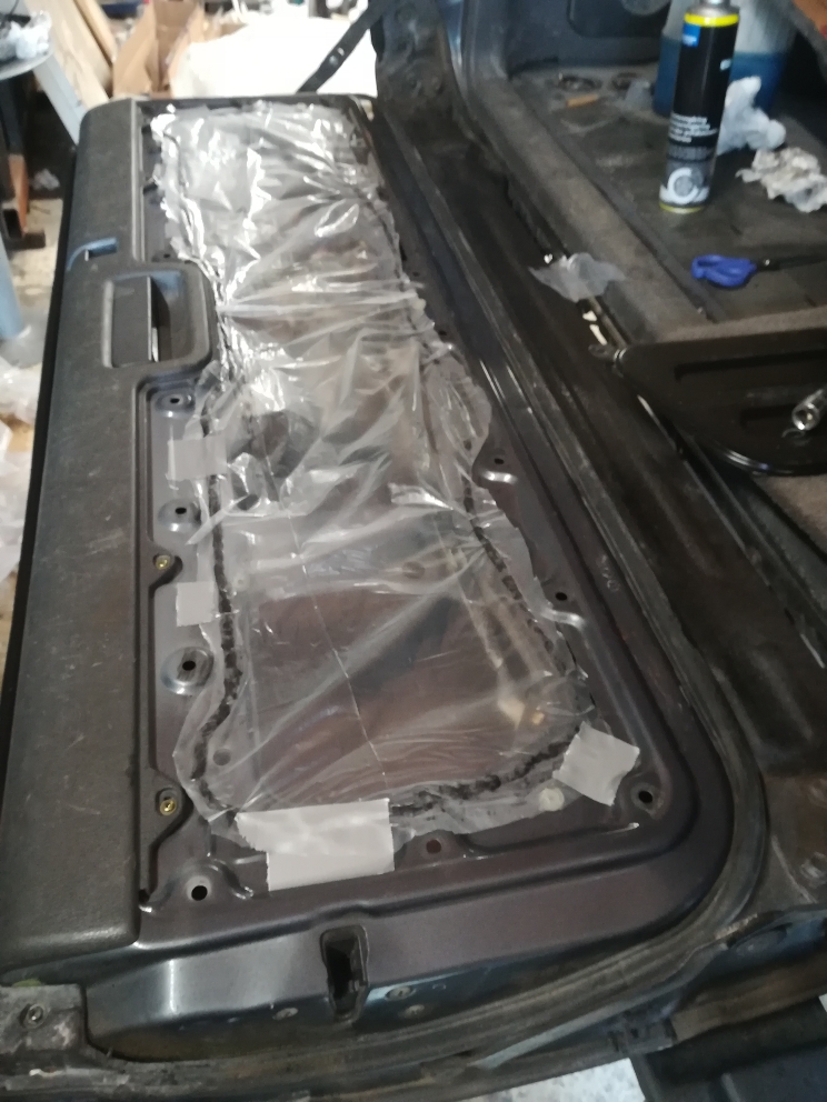

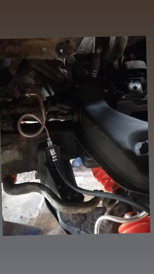

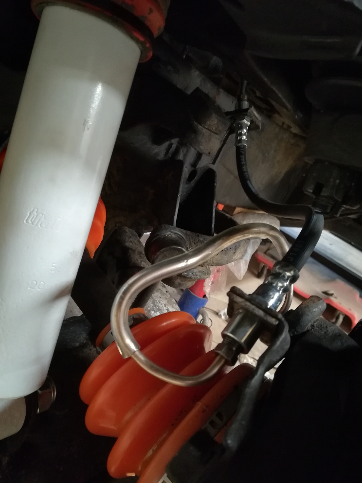

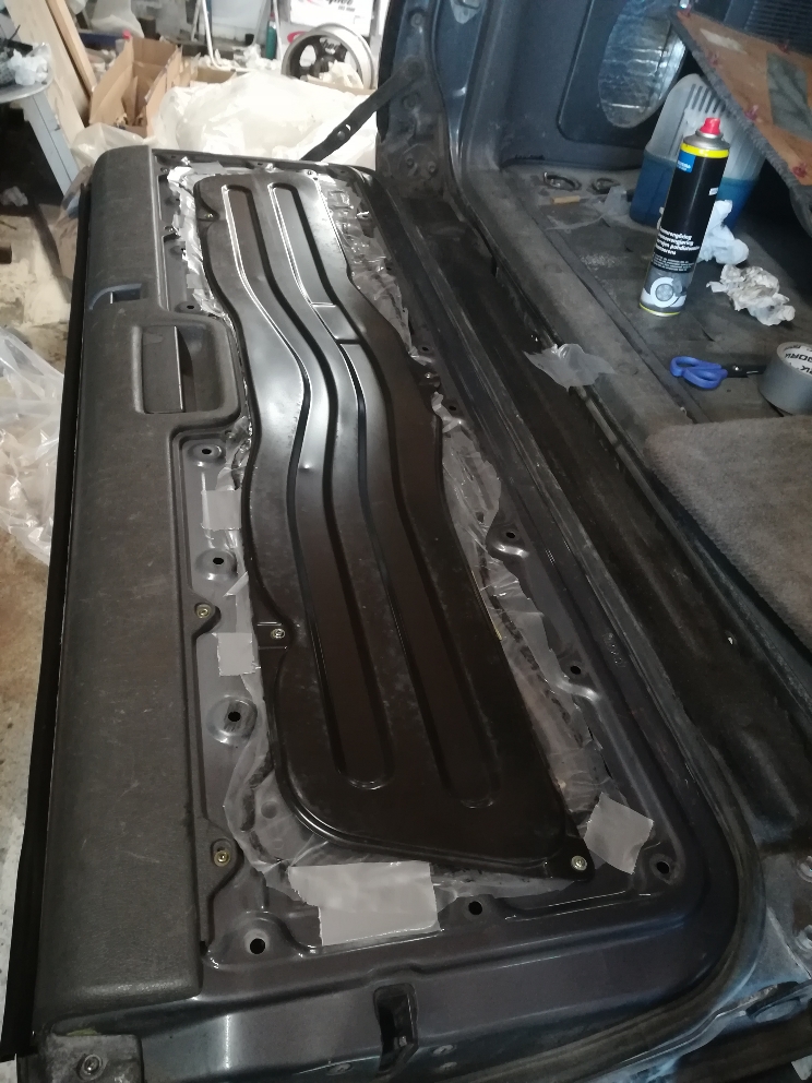

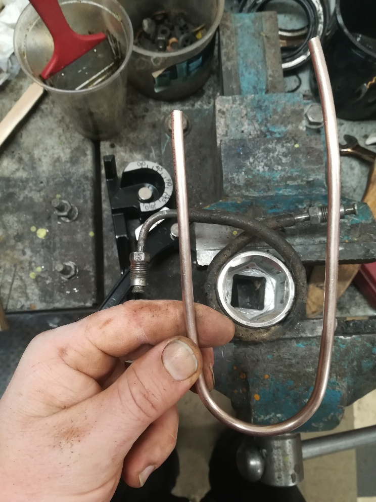

Yesterday i made another new brakeline for the passenger side. the original begun to get some rust so replacing it. made a new plastic cover for the tailgate as well and installed the rest of the covers.

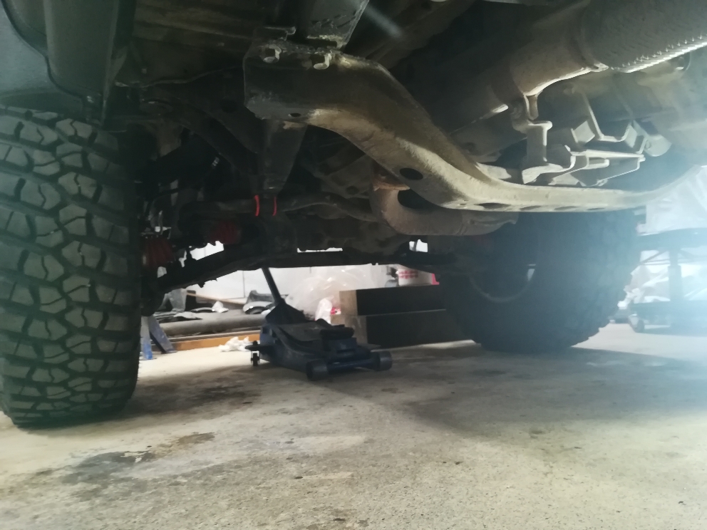

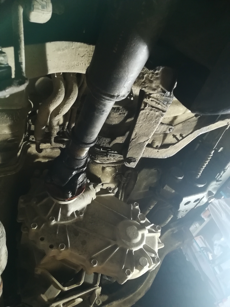

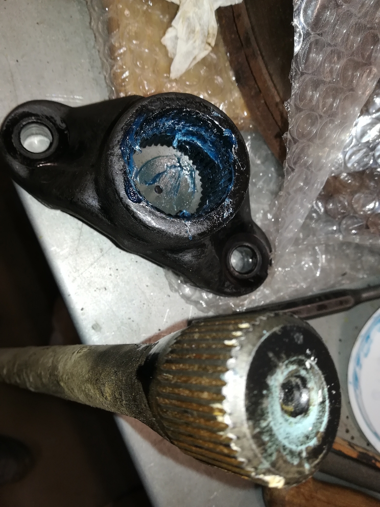

Well today i did some small stuff as well. driveshafts are installed. torsionbars are adjusted for now,need to take a drive first. I feel that it is a bit tall, i dont like the angle of the cv's in front.. will probably lower it 10mm or so.. will see if it sag a bit first.

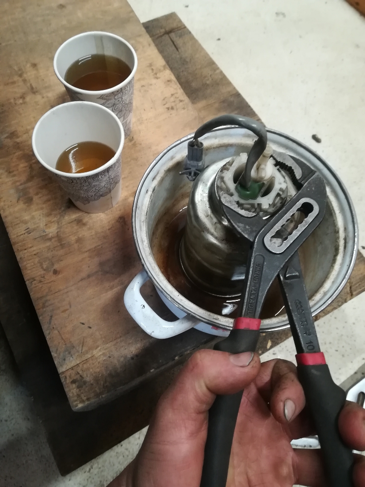

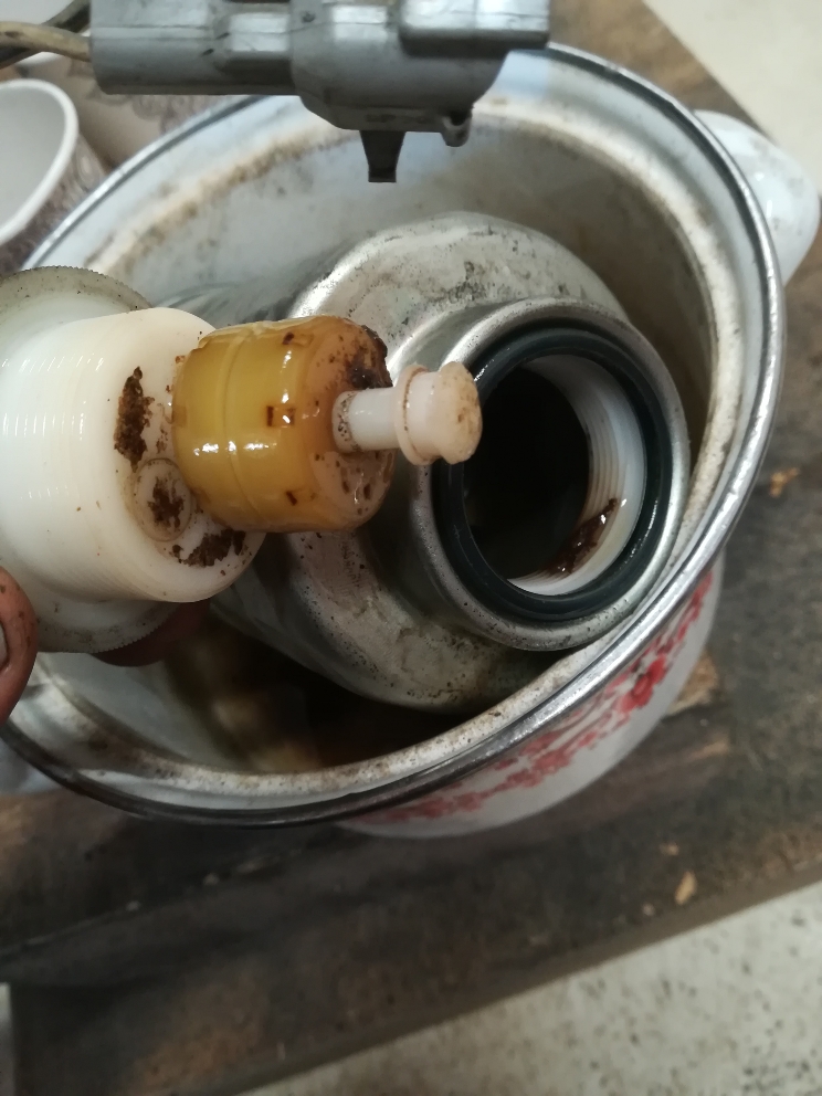

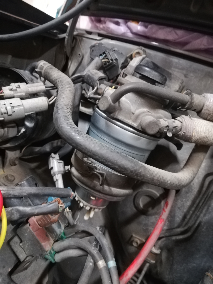

New dieselfilter installed, got some fuel on the fueltank allready aswell.. etc

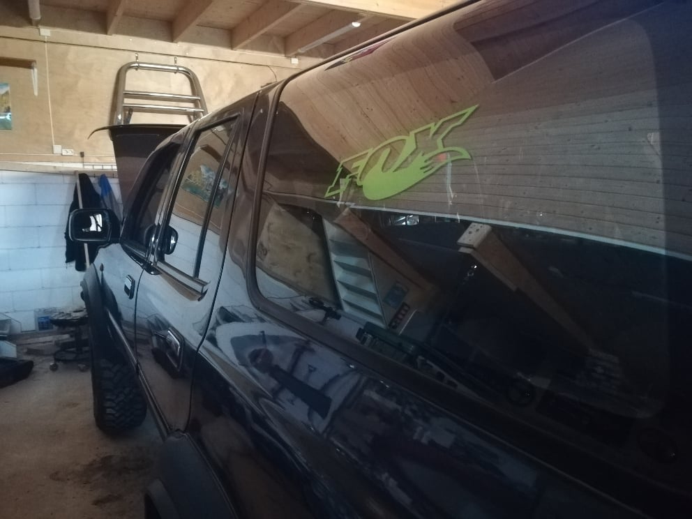

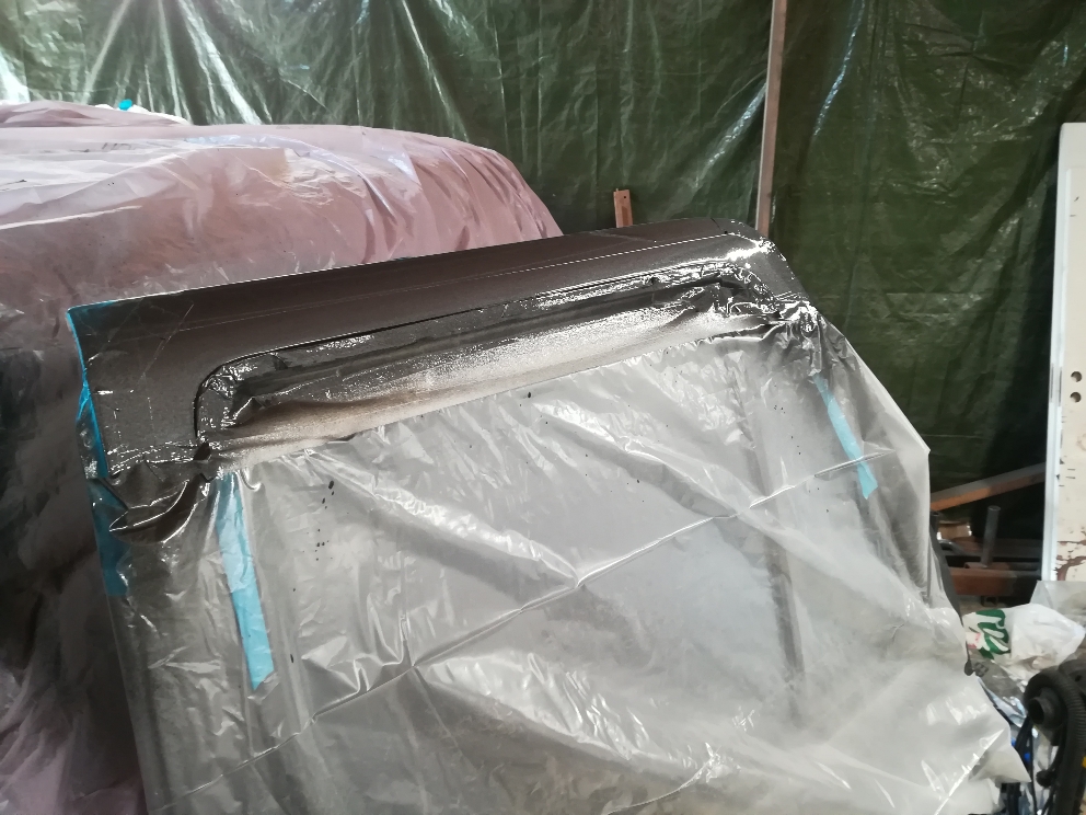

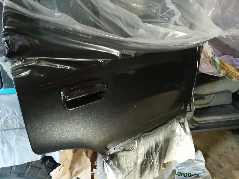

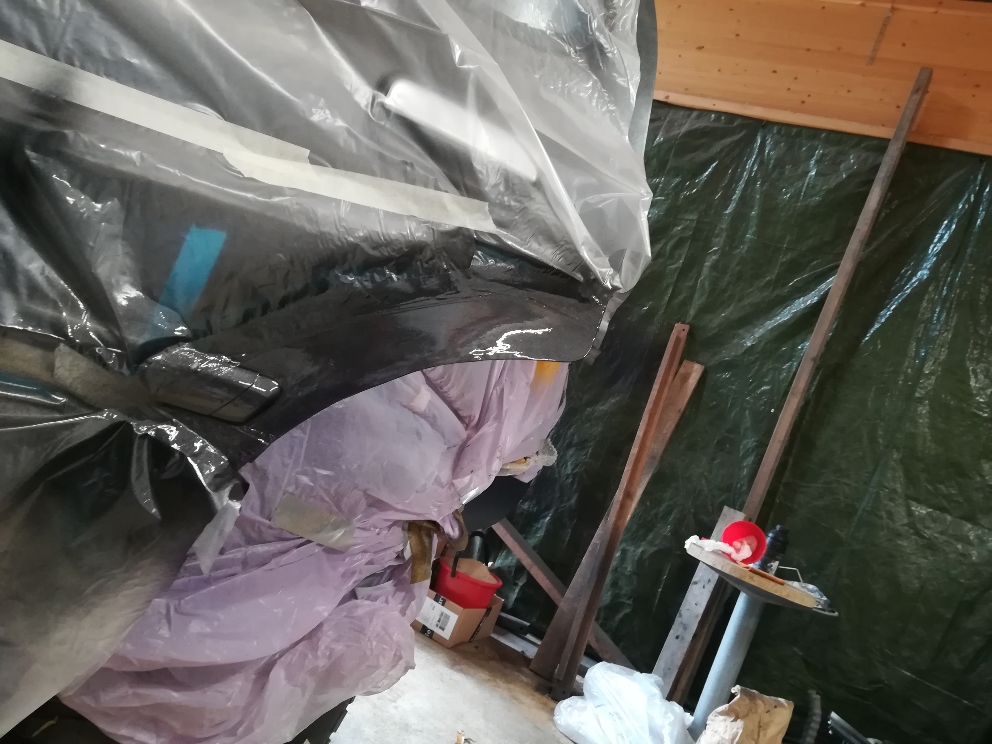

Some color yesteday and today. Not happy with the door, but dosen't matter. will try to polish the clearcoat when it is dry. Also the rest of the car later for sure.

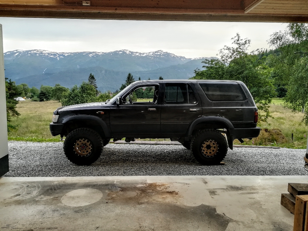

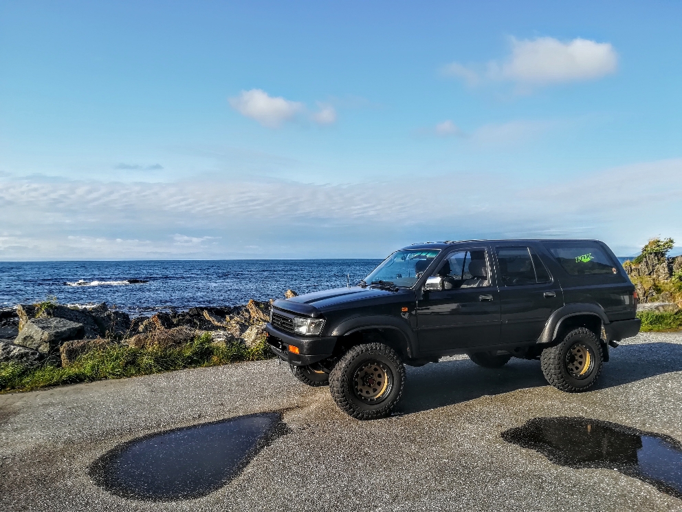

The 4R pass the license registration controll with no failure today.
Im pretty happy now.

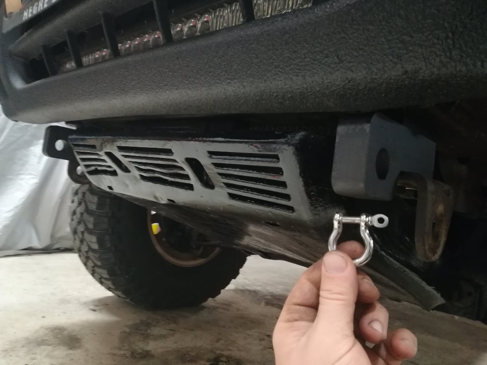

Installed the new heavy duty shackle mounts today.. and some stickers.. rear seat is removed and time to make a tempoary bed in the back. Need to find some led stripes as well to have some camping night lights.
