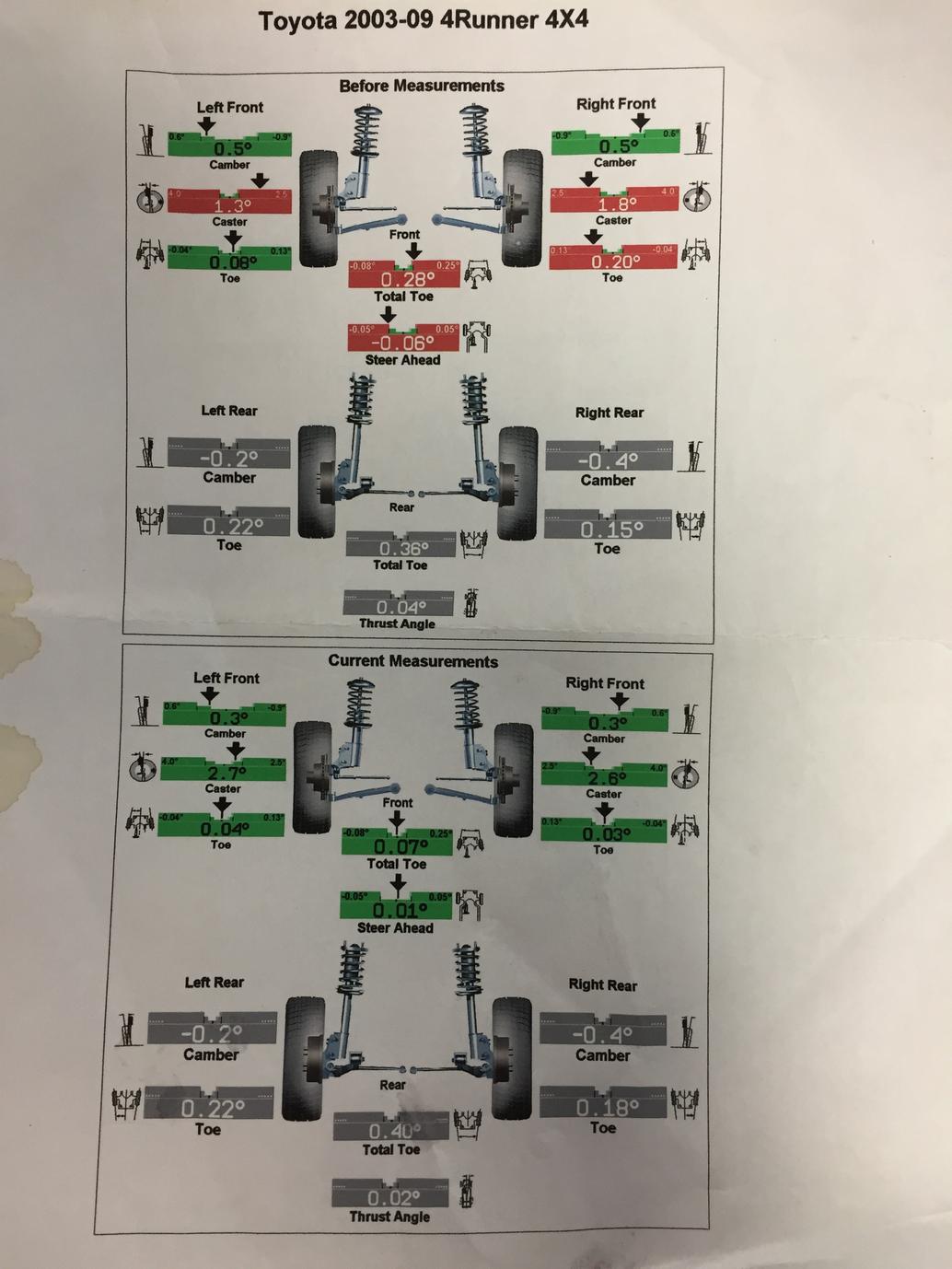

Here's some history, will attach last alignment sheet.
fj springs/5100s 1.75 in front and 1 inch cornfed spacer in rear
New C load Cooper AT3
spidertrax
Anyway what do I do?

IMO your alignment specs look perfect.

I'd try closer to 4* or a hair higher of Caster, lifting the J120/J150 platforms usually results in needing more positive Caster for better control.
I'd try for more caster as well.

Air pressure helped quite a bit. It still jumps a bit but not the death roll i was getting before. I will probably end up getting some camburg ball joint arms to correct the caster.
