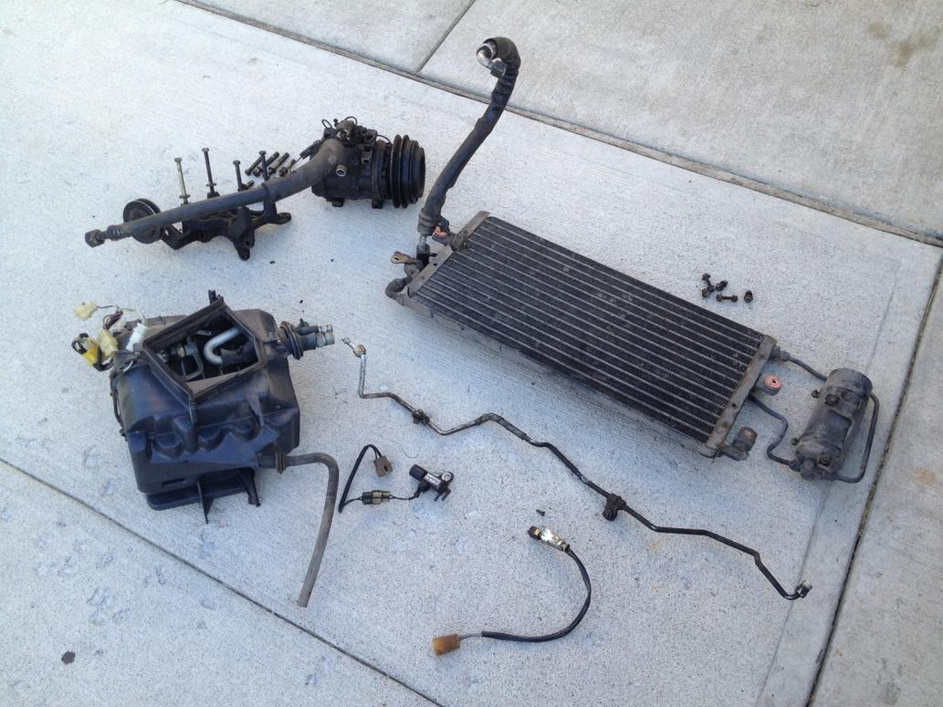

I confess I kind of scanned your post but I did not see where you live. The 1st gen 4Runner A/C was a dealer installed option. I paid about $450 for A/C on a new 4Runner years ago. The wire harness for A/C is lurking within all 4Runners. You can piece together everything from junkyard parts. There are lots of threads on yotatech. There's also very good information in the FSM online for the '88 4Runner. There are a couple of eBay venders that sell the parts from junk trucks. I could not find an auction on there right now but I stole a picture of everything you need from an earlier auction. You will need new O rings , a belt and a new drier if you buy used parts.
