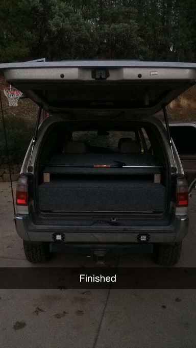

I'm wondering who else likes to sleep in their 4Runner when they're out camping. What are some of the mods that you've done to make it a more enjoyable experience? So far, I have built a storage platform for the rear, based on RamRod's thread (Link to his pictures)
Here's a picture of mine, before I stained it

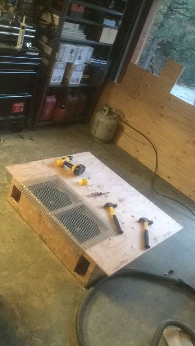

here is the box i built, the door is magnetic and it hold my two subs and all of my tools and other miscellaneous things.
