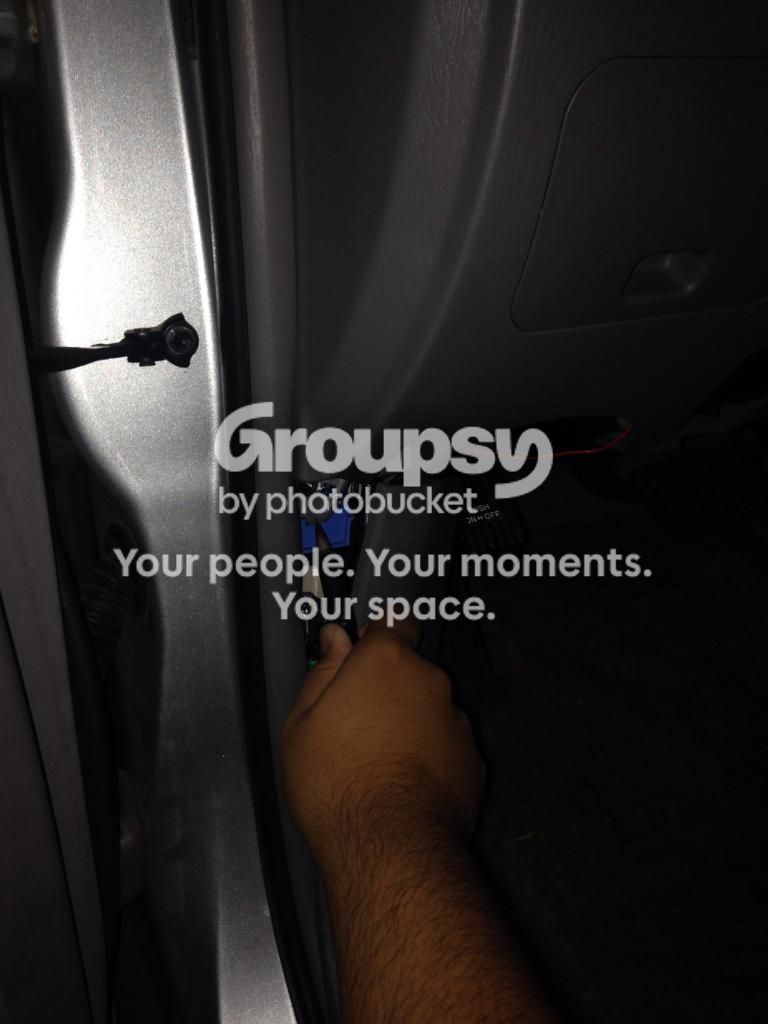

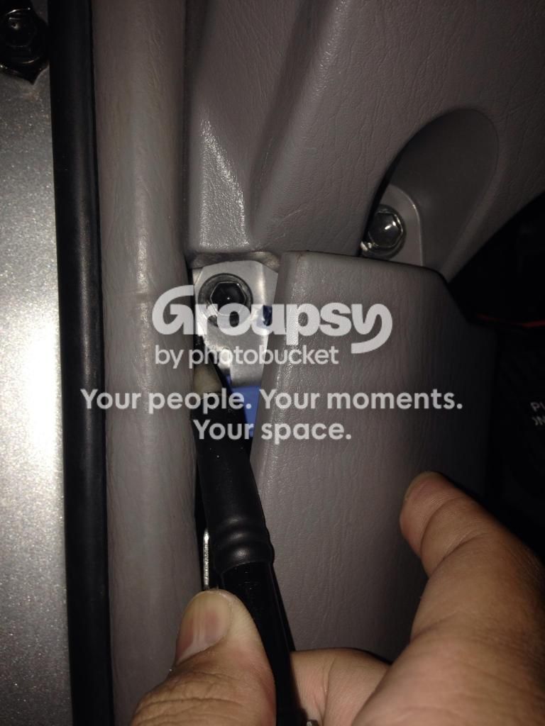

The ground point is behind the trim next to the parking brakes. I haven't checked the voltage of the fuse because I don't have a multimeter... Here is a pic of where the ground point is

I would first try and move your ground. I recommend grounding only to the body itself (for interior accessories), on completely bare metal. I usually try to ground to the body behind the kick panel. Even though the dash bracing is metal, this can be a poor ground.

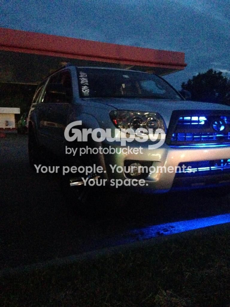

post pictures of the leds
2 LEDs strips from Autozone in the grill. One attached to the hood so when you open the engine bay lights up blue and the other strip attached to the bottom of the grill.
