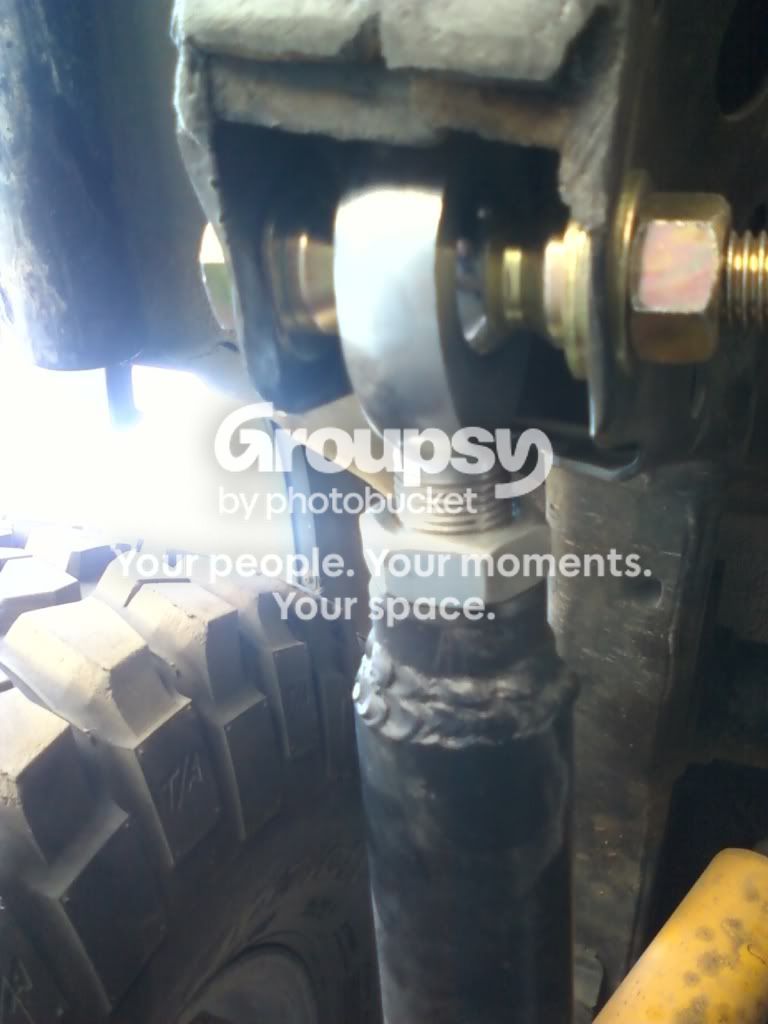

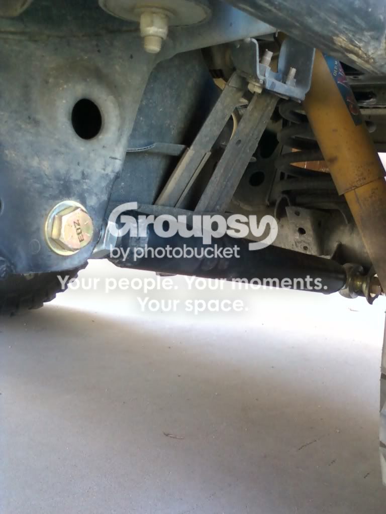

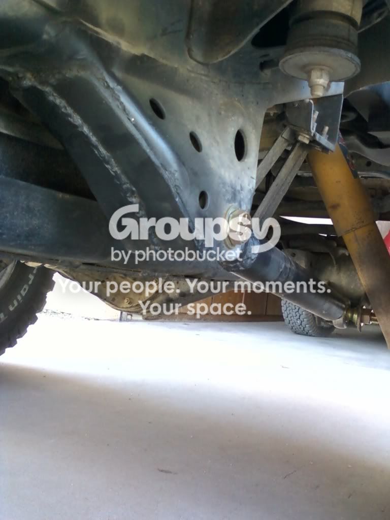

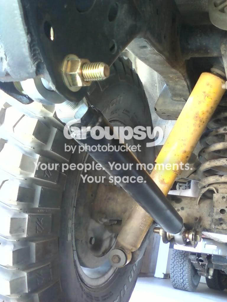

So Brian2sun and i decided to make lower links for our runners. I had a bent one, and Brian has seen a few bend.
We used Ruff Stuff Specialties 7/8" heims with bungs for 1.25" id tubing both right hand thread
As far as material we used 1.5" .120 wall dom and sleeved it with 1.75" .120 wall dom.
it was a tight fit. So basically it is 1.75" .250 wall dom, but the sleeved design was used to cut cost. ( i would have had to but a 20 ft stick for $250 !!!!) then we used all grade 8 hardware. We had to drill the stock mounts out to 5/8. It was a really easy build. If any one wants info on the setup. I can help you out.
I feel they are almost indestructible. The heims are rated at 42,000lbs. and the tubing would be hard to bend. Check out the pictures.
And on a side note we also added plate to the lower control arm mount. It was simple to do as well and i believe should help us from crushing our mounts. Both Brian and I had messed up mounts and had to do some work to fix them.

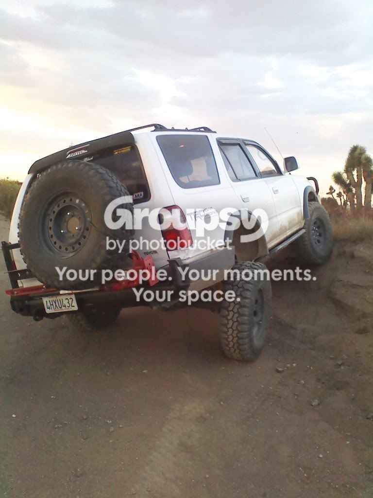

I'm extremely happy with the way they turned out, and they were surprisingly easy to build too. Not only are they nearly indestructible, but the heim joints put basically zero twisting force on the mounts too, unlike the straight stock rubber bushings which that's all they do. This means the chances of tearing a mount off the axle or frame is greatly decreased. We added approx. 22* more flex to the joints also which resulted in about .5-1" more downward travel also (because the stock arms have triangular stops on the top at the frame side) So now J-money$$$ and I need longer shocks to take advantage of the full range of flex. Here's a shot from right after install (btw, my tire is still on the ground here and getting traction)...
1015101800a.jpg~original
The other side (cameras are deceiving, it doesn't look like much, but ~ 3"+ of my tire is past the flare and up in my fender...
