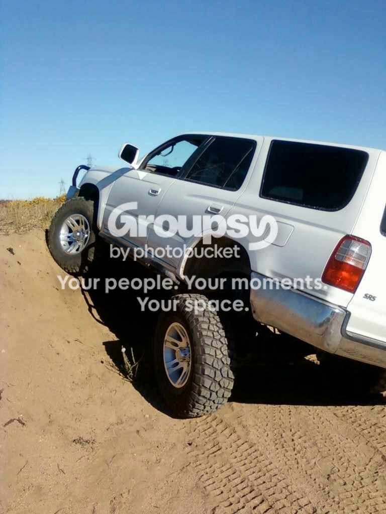

HERE IS THE NEW REAR FLEX
1102100944.jpg~original
Brian and I will be making uppers this week, and hopefully a panhard with hiems in a few weeks.
Its coming along great. we added way more rear end flex with some new shocks and links that will not limit articulation.
In this picture i had my rear spring fall out, and that with the cone. But Brian and i have discovered with a set of 10 mm spacers (2) per side you can eliminate this problem.

and LINY4runner just as a little warning, if you go flex your truck out with the new shocks you WILL stuff a tire so far that it will bend your stock bumper. Bevcareful if you care about that stuff. in that pic of my 4runner i have trimmed the rear bumper significantly

Our lower links add a lot of flex, I wonder if you would have still bent your bumper if you had stock lower arms but with the Tokicos. I think the arms add the big nasty extra flex because lots of people run extended shocks and don't push the driveline 1"+ into their gas tank skid like me. It's gotta be the arms.
On a side note, you were thinking of running LC coils until you get a rear bumper because of the big rake with the 891s + 20mm packers, but you'll have even more rake with LCs so I think you're better off just running the 20mm spacers and save the $. 7 wraps would probably be about equal to 891s +20mm.

Thats why Im not to into LC springs anyways. Im going to just probably run the spacers. And there is not way you can get that flex with stock links. They wont let it droop enough, and the rubber will just bind up. Wait until its all on heims...
