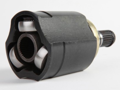

I have seen some long travel conversion kits for the 4runners out there that use the tundra axle shafts with extended control arms and coil overs.
The short one is the 4Runner and the other is a Tundra's
My question is, has anybody tried this - Using the inboard CV joint from a Tundra on a 4runner shaft and outboard CV joint?
Are the inner splines of of the CV joint the same between the two. I know that the the inboard diff shafts are the same as they have done the long travel conversions with Tundra Axle shafts.

I heard it wont work, they are too long, I believe Yoshida and Gerdo tried them, among other things...
What's too long - the actual joint or the whole axle.
It is obvious, just looking at the picture that the shaft is longer but i was thinking about using the 4runner shaft with the Tundra inboard cv joint...

I believe that the inners and the outers are the same on the two axles, just the axle length is different.

in your pics you show a 4runner inner and a tundra outer (which looks exactly like a 4runner outer) and why change the inner, that is not the problem. The problem is the ball and cage and they like to break.
Im with gerdo on the axles being the same (joint wise) minus the actual shaft. THats why you can swap the shafts for the lt kits. The only reason why the lt kit is easier on cv's is because they are significantly longer

I think that the CV joint locks up in full articulation. Meaning, when you are off roading and you have one front wheel off the ground, The joint binds up and when you drive it forward, something gots to give and something breaks.
My justification for this experiment is that with the 6 ball cv joint, it has greater angular operation. It shouldn't bind up in full articulation thus not breaking.
Unless you have increased the droop, the OEM CVs will not bind or lockup. Aftermarket ones have been known to lockup and not allow the tire to turn, with factory droop.
