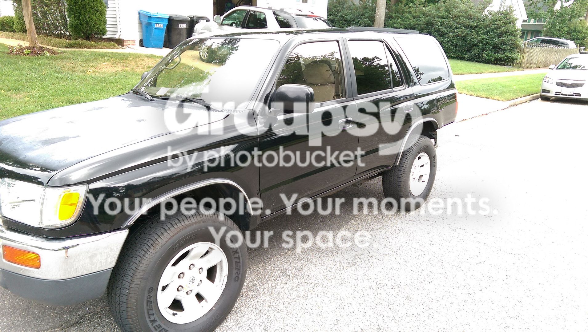

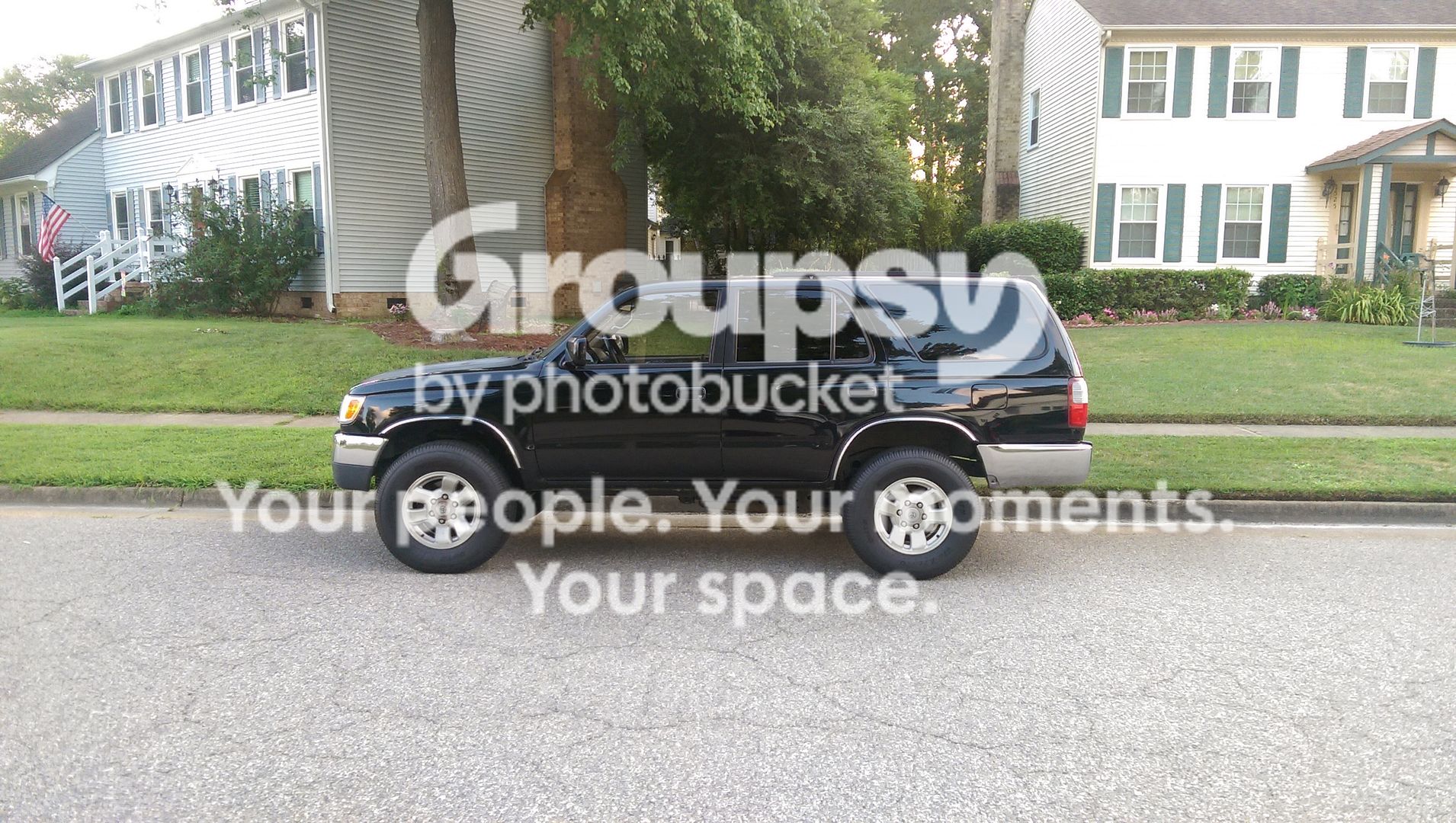

Side profile as she currently sits.

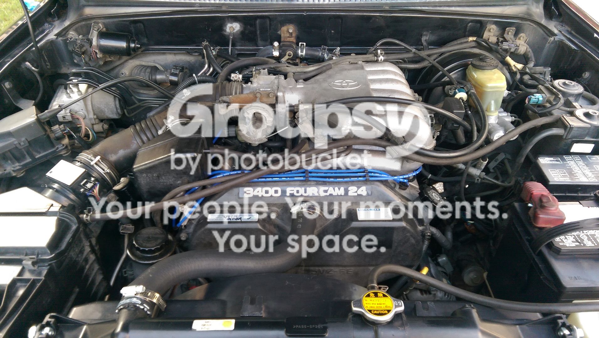

Engine Bay.

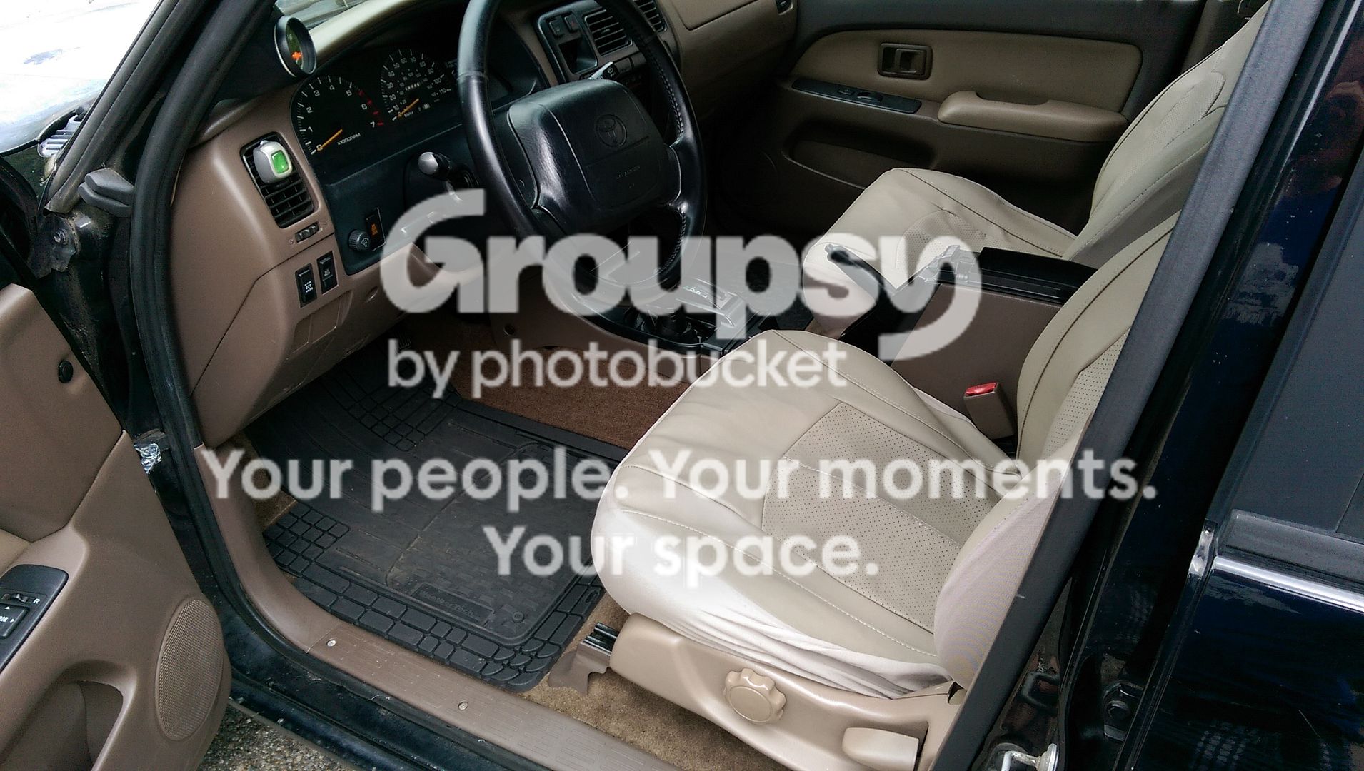

Updated interior shot with my Weathertechs.
The cargo area. (Haven't finished the seat backs)
I'm extremely pleased with the carpet from Stock Interiors as well as the seat covers from Advance Auto (of all places).

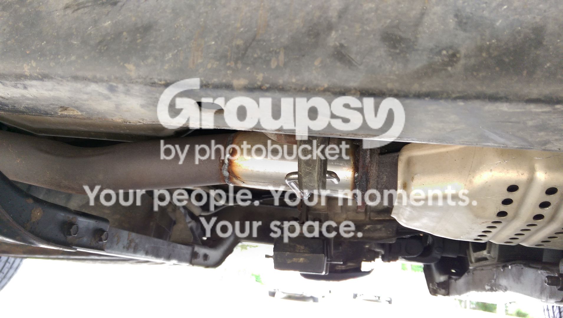

One thing I did have professionally done recently was replacement of part of the exhaust pipe. It had rusted through in one spot and the shop that performed the work did great work. Well worth the $80 dollars and 30 minutes I spent there.

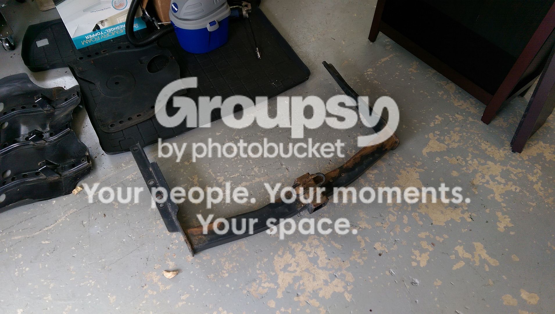

In addition to the fan clutch, my next project is waiting for me in the garage. The PO had lost the tow hitch somewhere and I always like having one. So....courtesy of [MENTION=109102]MattJakobs[/MENTION], I have one. Just have to hit it with the wire brush and a few coats of black paint.

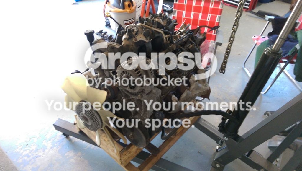

Well, my thread has been quiet for sometime now. And rightly so as I have been just driving and enjoying it. It did require a few maintenance items and upgrades, though. It had its first oil change, replaced the fan clutch, and a couple of radiator hoses. I also put in my non-existent radio, including Sirius XM, as well as a console lid.

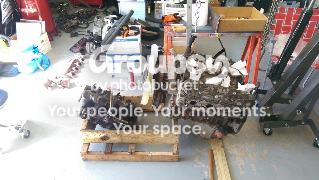

All that being said, I've always had big plans for it down the road which included an engine swap. I like the 3.4, but always thought it was a bit on the slow side. So.....yesterday I brought home a GM LM7 5.3 V8. Unfortunately, I have an addictive relationship with Craigslist. ( I can't seem to stay away! LOL) The engine was a steal at $700 for EVERYTHING. (Motor, accessories, wiring harnesses, pedal assembly) It came from an 04 Tahoe with about 160K. No way I could pass it up.
I chose the GM LS for its compactness, weight, aftermarket support, and general cool factor (haven't seen a 3rd gen LS swap, yet).

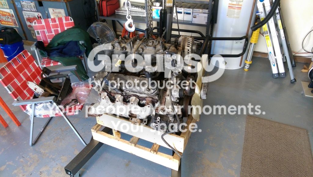

This will be a slow build up. Today I torn down most of the engine. Next steps are to get the engine squared away, start my standalone harness, acquire a transmission (4L60E) and a suitable transfer case (NP 241?).

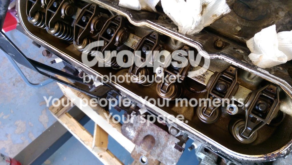

Valvetrain shot.
Disassembly done for the day.

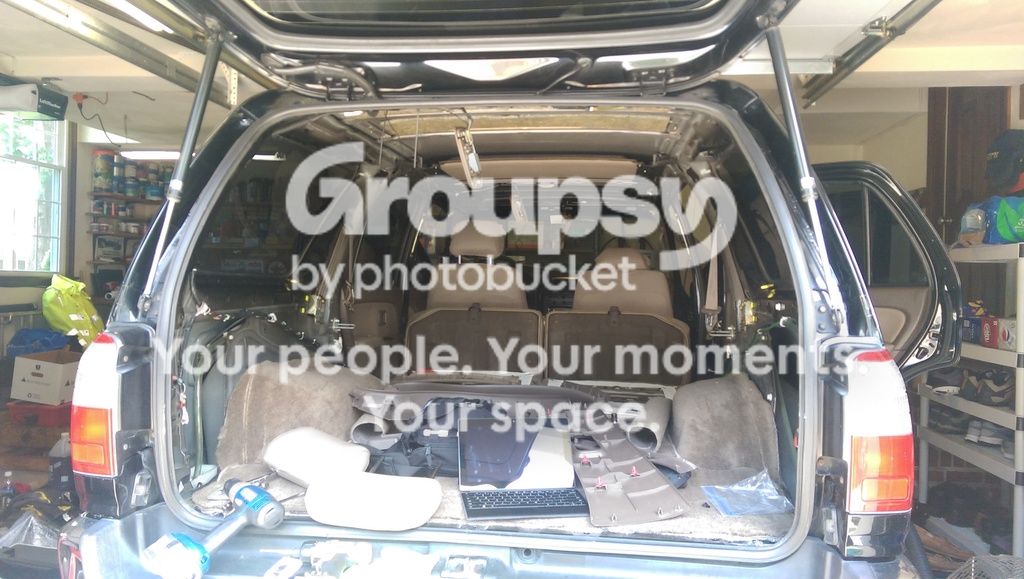

A giant pet-peeve of mine on our generation of 4Runners is the lack of sufficient lighting in the cab when the doors are open. Luckily, member [MENTION=89223]xcmtb83[/MENTION] created a solution for us 96-98 guys. He crafted a custom harness which turns on all of the cab lights at once when the hatch or doors are open. (Top notch seller btw!) His harness is exactly what I was looking for, so in it went.

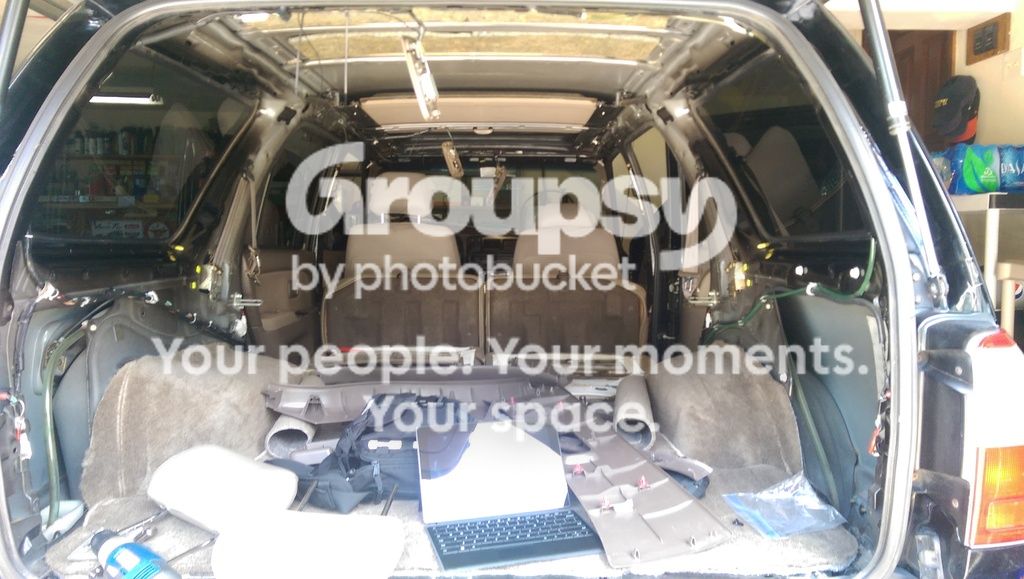

Removal of headliner isn't necessary, but I wanted to pull it down and do a thorough cleaning. Truthfully, the hardest part is not breaking the headliner clips in the back. I broke all of them and ended up buying probably the last of the Toyota stock at my local dealer (sorry).
Another shot. Using good ol' zipties to string up and "rough in" the harness.
Back together and the way Toyota should have done it originally.

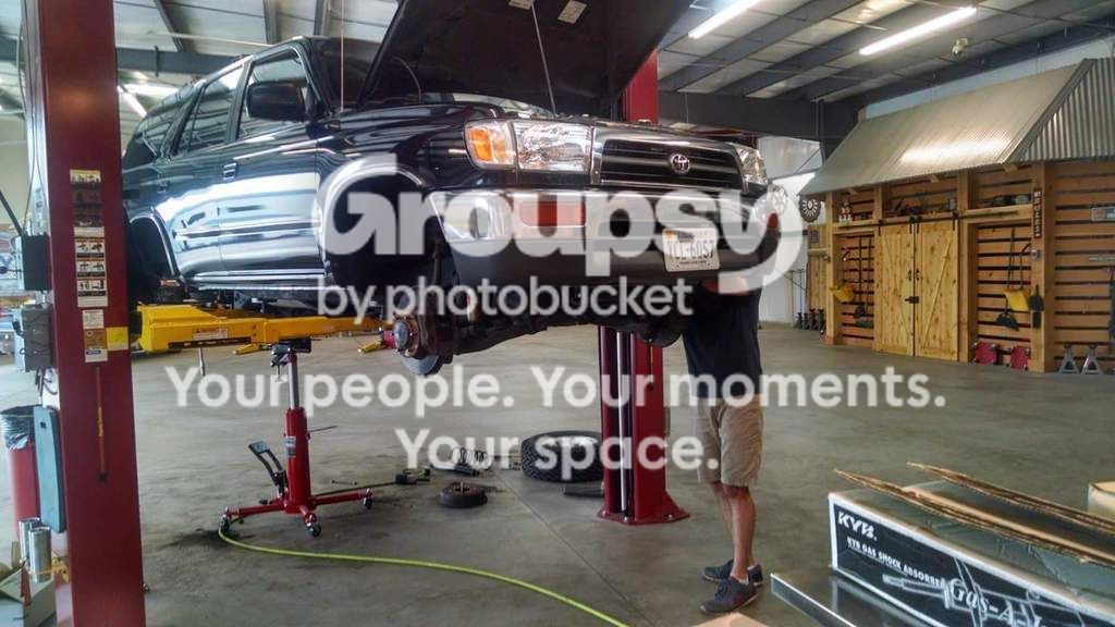

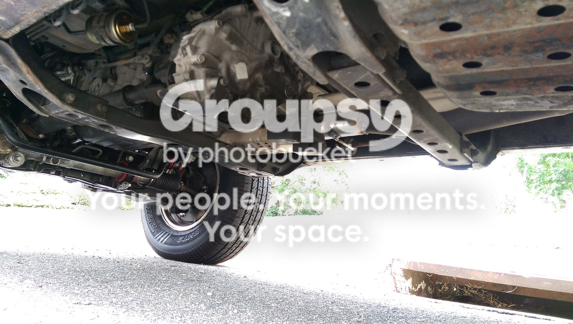

My 4Runner was definitely due for a suspension refresh. It currently has just over 312,000 miles and I'm pretty sure the rear shocks and springs we're original. When I bought the truck, the PO said he replaced the front springs. They rode OK but the shocks, I think, we're just tired.

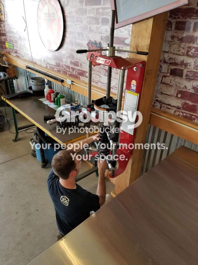

What I went with was MOOG 99 "tall" coils w/ KYB Gas-A-Just shocks. I wasn't looking for a "lift", but wanted to restore my truck to its original height. I don't wheel often and rarely have a ton of weight in the back. This combo seemed reasonable for my situation and the price could not be beat. I did, however, want to upgrade my tires. Wal-Mart, of all places, was having a special of General Tires. I grabbed a set of 265/70/16 Grabber AT2s for just over $500. On top of that, General Tire was offering a $70 rebate. Not a bad deal if you ask me.

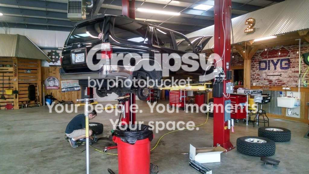

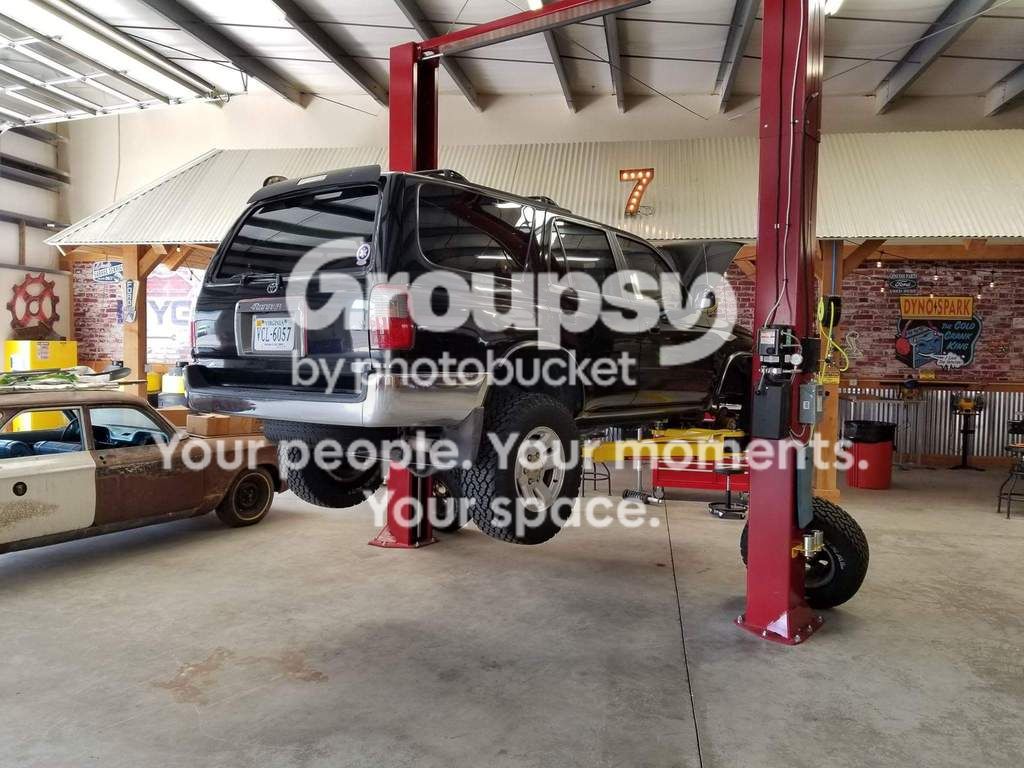

The pictures that follow were taken at my new favorite place to wrench. It's a DIY garage in my area. Basically I'm paying for the convenience of the lift and air tools, but it is so worth it. It made life so much easier.
As far as the lift is concerned, I ended up with a 1.5" all around. The passenger side, unfortunately, is definitely higher than the driver side. Not by much, though. Ride is smooth and I have no complaints otherwise.
