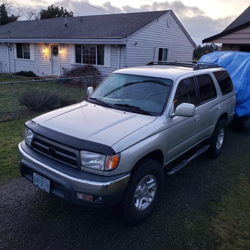

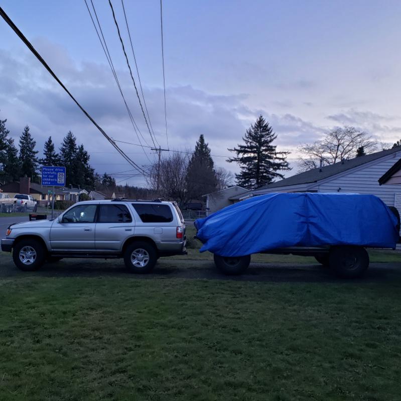

So, my old 2002 4runner was totaled. It slid on snow and ice and flipped on the driver's side. I found a replacement 2002 SR5 in Millennium Silver, pretty much the exact vehicle minus a sunroof.
I am looking to swap my build over and have been trying to work out a sensible order in which to do things. Some are obvious, some are less so.
I know a few of you have embarked on the same type of build swap and I would appreciate any input.
The good news is that most of the mods survived. What makes this a bit touch and go, is that my new 4runner is still my DD. Also, I will be doing most of the work at some of my friend's garages.
At some point, what is left of my old vehicle will go to scrap after I strip it as much as I can. But I plan on swapping the entire rear axle (it has gears and locker) over to the new vehicle. Same with the front diff. Is there another good option besides putting the new 4runner's axle back on the old 4runner that would give it mobility enough to get hauled off?
The plan as I see it now:

I am trying to figure out what all I want to strip from my old rig. It might be nice to have a spare tranny, interrior parts, (seats, surviving trim), door (well... passenger side anyway) to sell or to keep as back up should I need them in the future.
