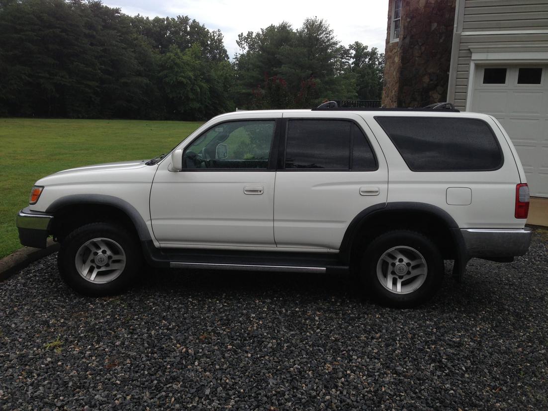

I have a 2000 2wd SR5 that I have a few (noobish) questions about...

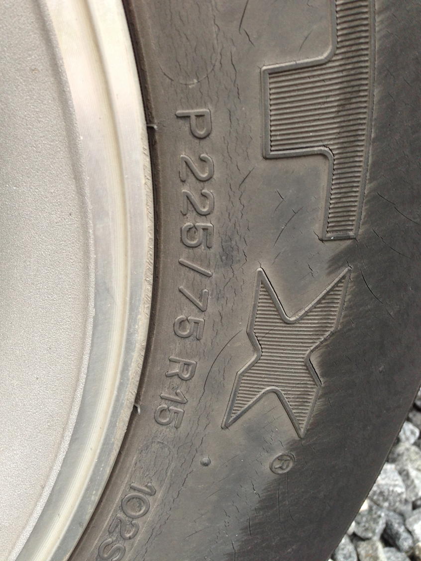

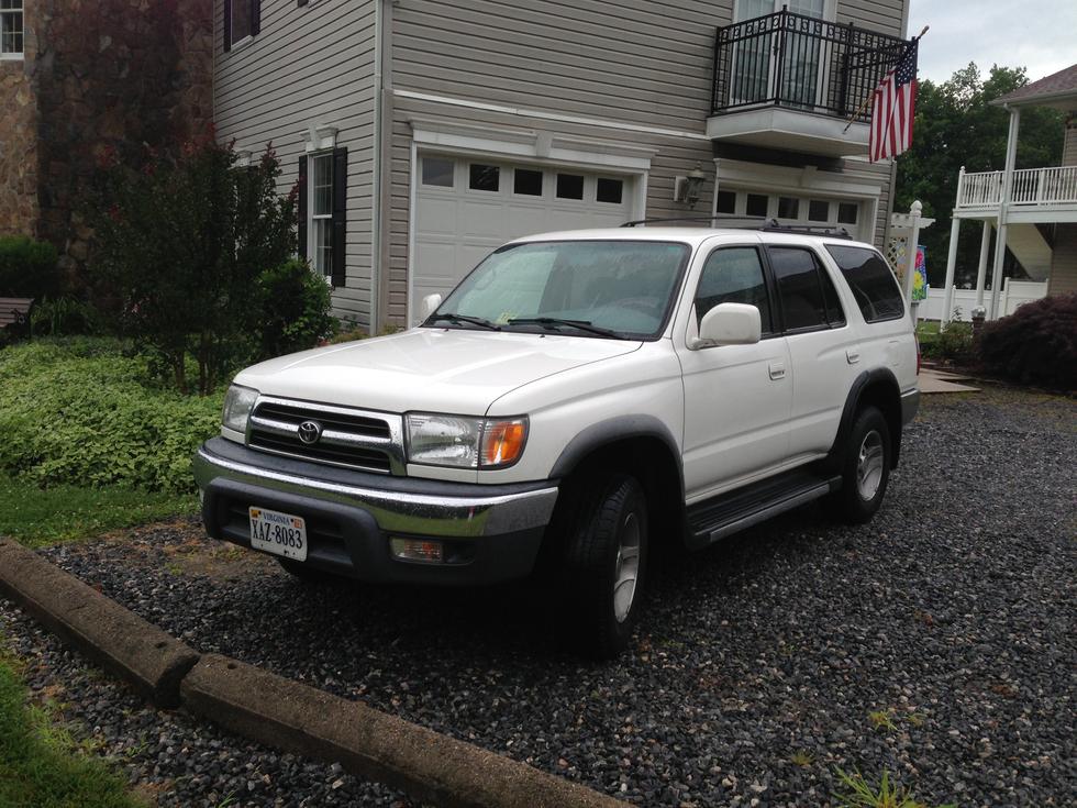

I've noticed that my 4runner sits a little lower than most 4 runners I've seen (that don't appear to have any major mods) and I was wondering if that is mostly because of my rim size or tire size. I have 225/75 R15 tires on there now. All of my tires are beginning to have sidewall cracking so I need to change them soon and I was wondering if there is any sort of tire size I could change to so it would lift the car up a little more without having a negative effect on MPG, handling, etc. I mainly just prefer the look of it sitting a little higher. Maybe getting 16" rims is the answer... Im not sure and that is why Im seeking consul!
Thanks in advance for replies!
Here are some pics...

The diameter of the 225/75/15 is around 28 inches while lots of 4runners will have 265/75/16 which are closer to 32 inches so they will definitely look higher compared to yours.
The a larger tire would also fill in the wheel wells which looks nicer.

If you put those size tires and wheels you will go from 28.3 in to 30.6 in of tire height. The 265's are much wider and I think they will look better.
