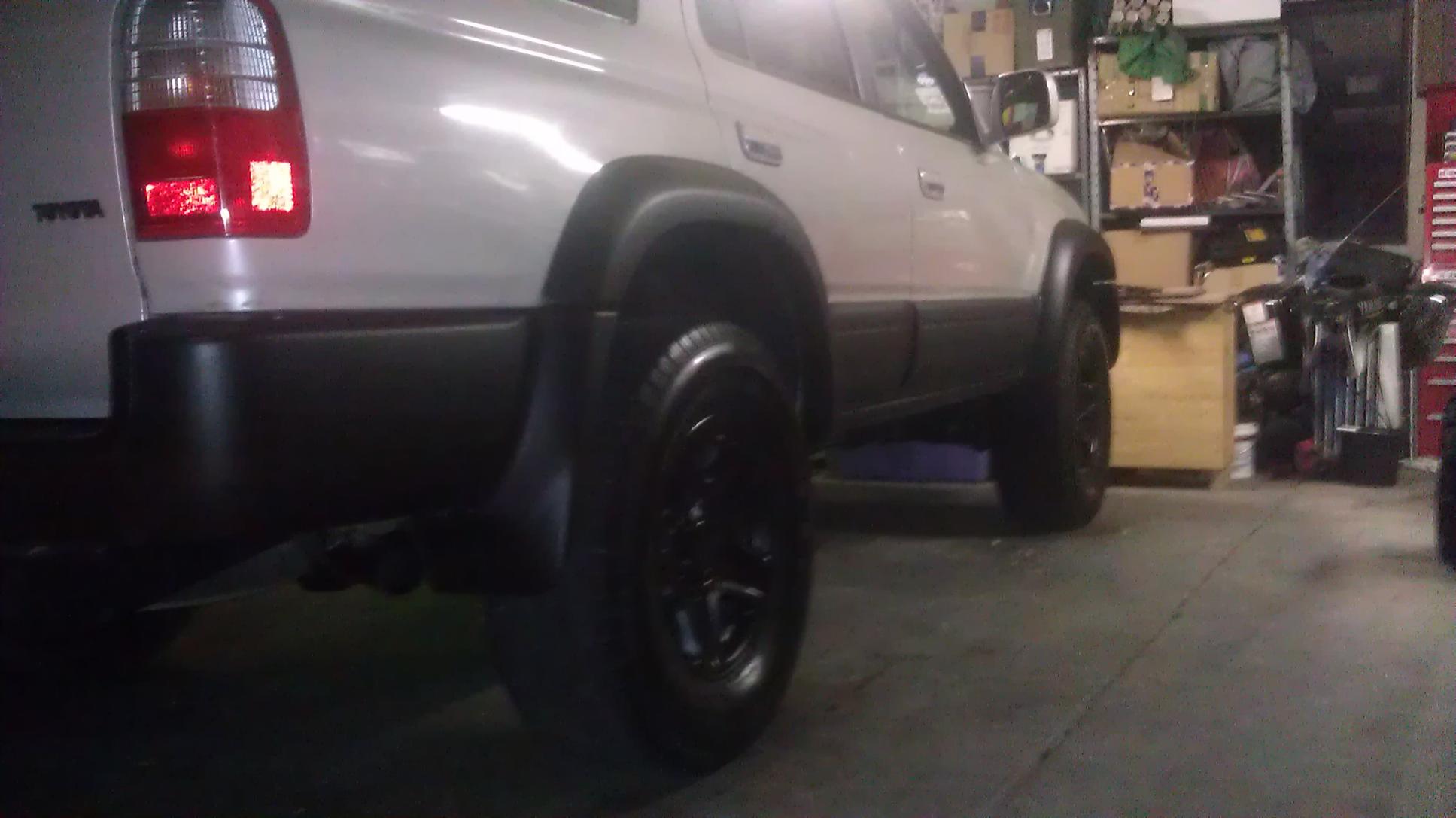

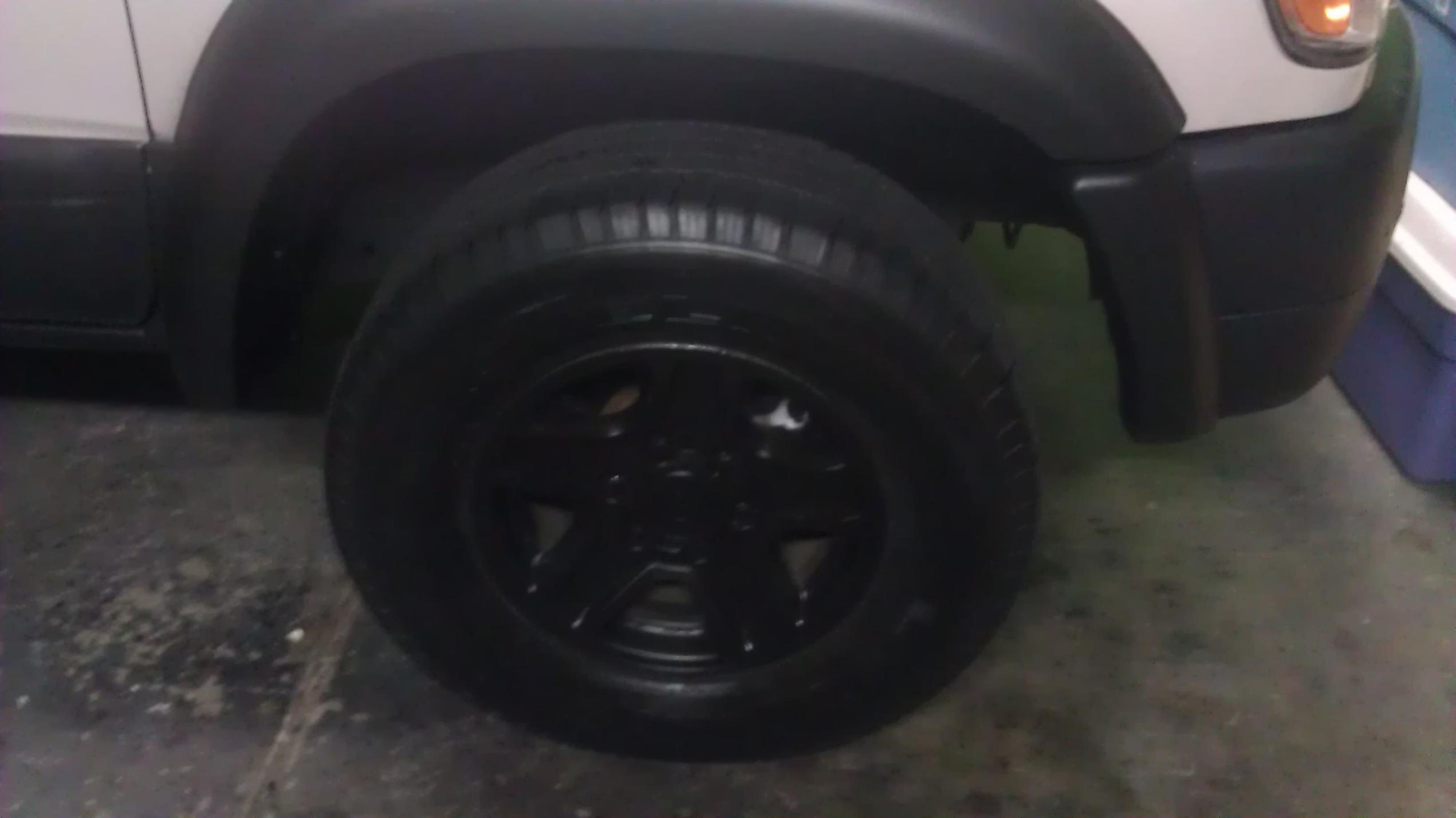

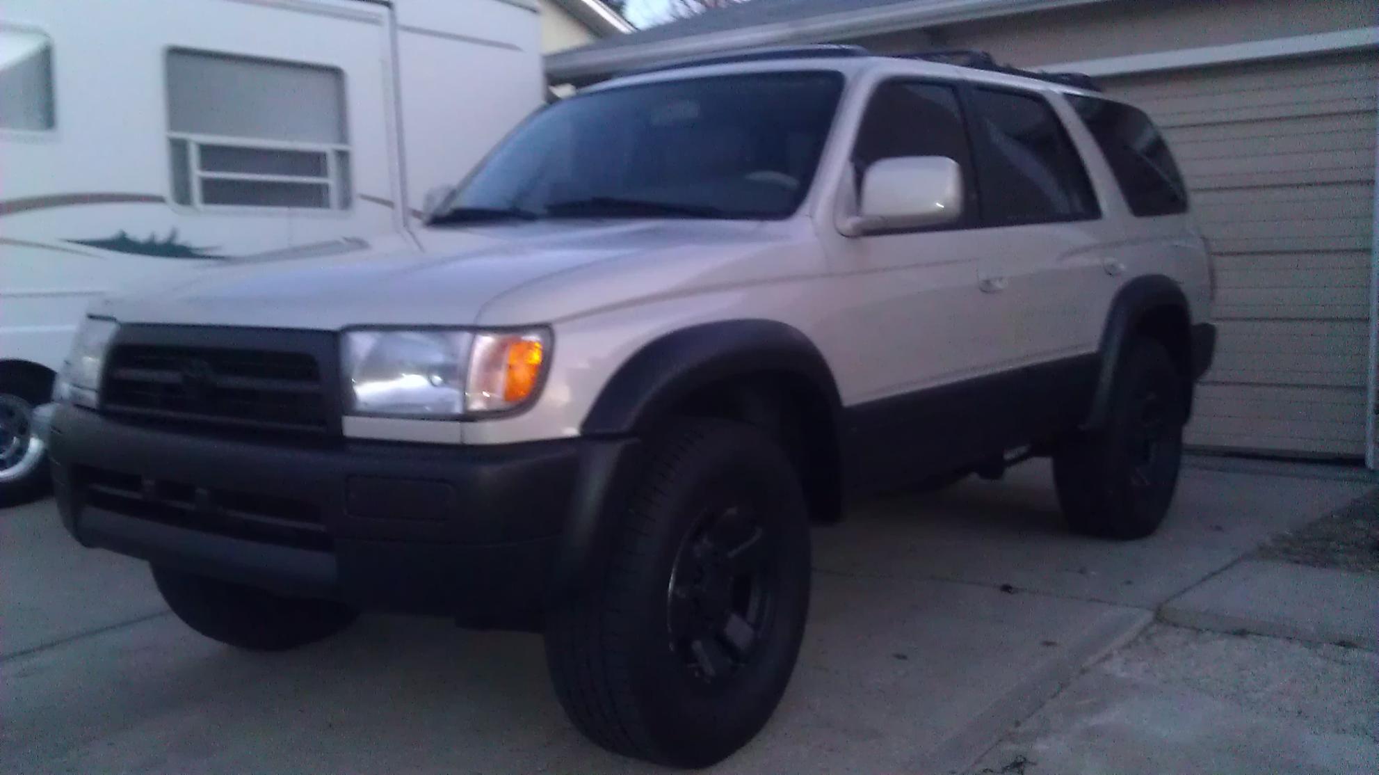

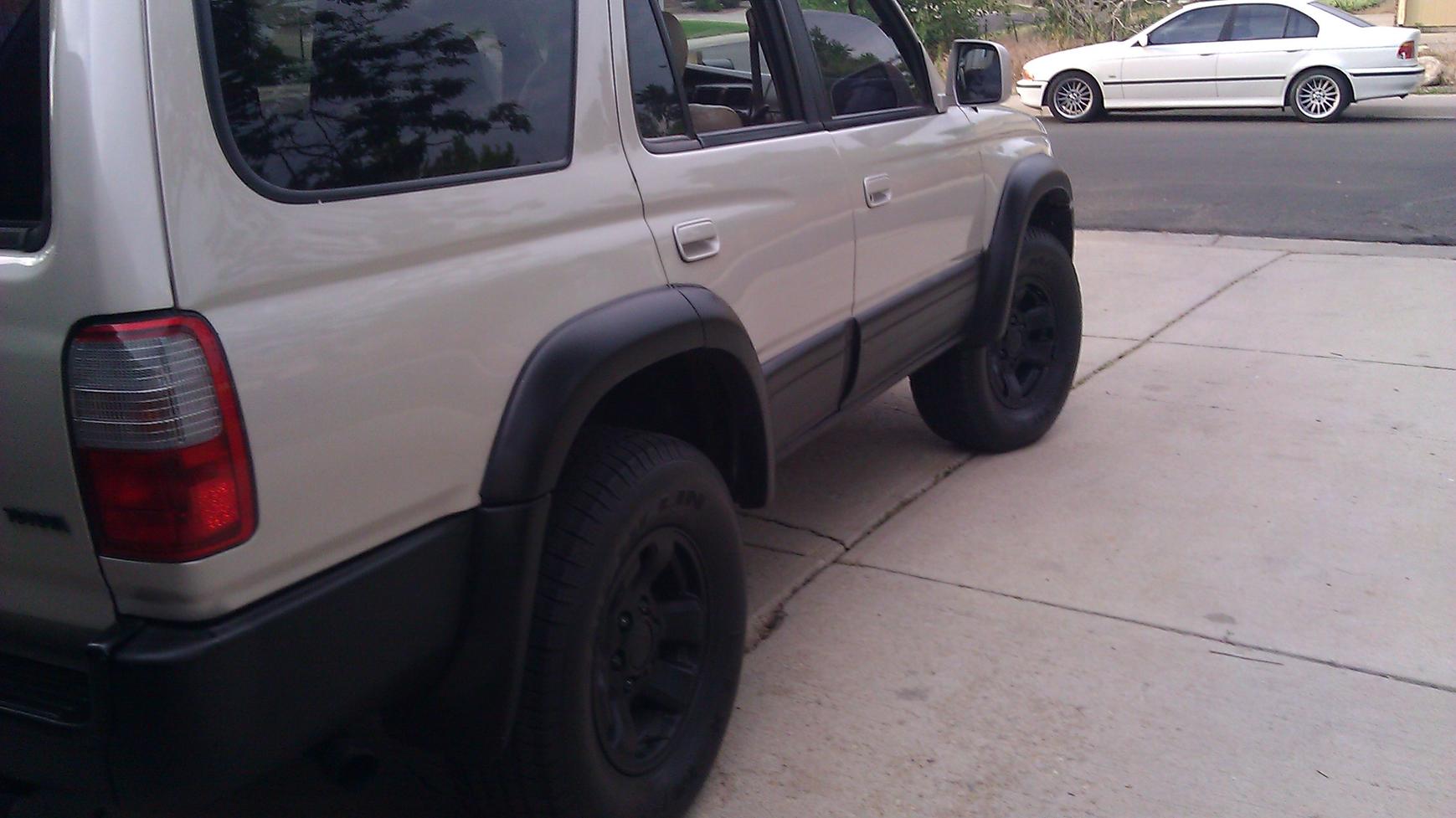

I did it to mine. I have the desert dune tan with black limited fender flares. Not sure how to upload a picture from my phone. I will see about sending it over to my computer.
Here are the pictures. I actually used plastidip which is an option and reversible. Its held up well aside from where passengers get in and out on the lower rockers. I went ahead and went over the grille wheels and chrome bumpers too. It adheres well to all surfaces, it even can take power washing.

Thanks for the pics, I think I am going to do it. I cant decide if I should do semi-gloss or flat. If anyone else has pics as well that would be great.

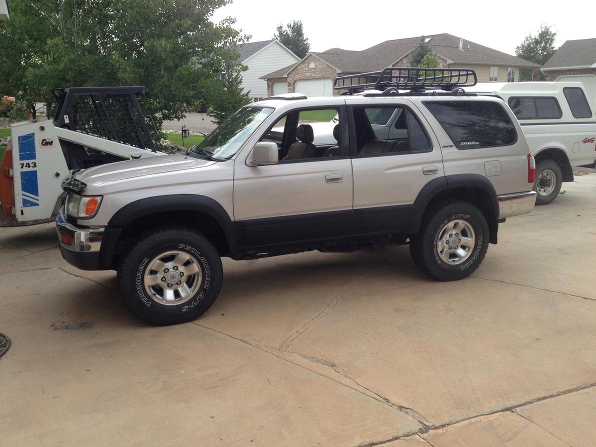

Here is mine I no longer have it but here is a pic of my black panels. I used a spray bed liner stuff in a rattle can from Home Depot. Came out very clean.

I have done mine with the Rustoleum bed liner. One tip I would have is to not spray the rubber piece on the trim. I sprayed it on the first piece of trim I did and the paint peeled off after about a week. You might have better luck with different spray paint but the bed liner didn't stick to it. I will try and post some pictures soon.
