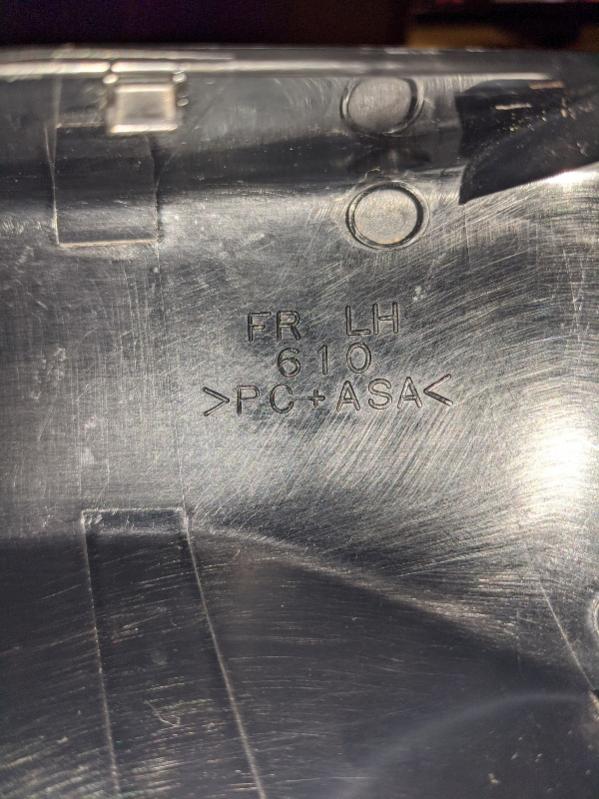

I don't know what the OEM plastic is since I haven't taken my caps off yet. There should be a code stamped into the inside of the cap identifying what it's made of. It should be located close to the part number. If I had to venture a guess I would say it'll be PP+E/P-TD20 sold under the trade name Xenopren.

This is only thing stamped in oem. Only changes are right hand left hand front and back

PC+ASA is the plastic.
Polycarb + acrylic-styrene-acrylate polymer. The PC is for stiffness and the ASA is for UV and weather resistance. Toyota made a good choice. And yes ABS is inferior to PC+ASA for this application.

PC + ASA
The acrylic-styrene-acrylate terpolymer (ASA) is an amorphous thermoplastic material that offers good resistance to both UV and moisture. PC/ASA is an amorphous thermoplastic alloy of polycarbonate (PC) and ASA that provides enhanced heat resistance and enhanced mechanical properties.
