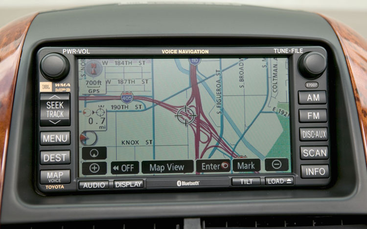

As uneek said, if there is a "JBL" label anywhere on your stereo, then can get pretty much any "toyota factory NAV". Just make sure it looks like the picture below. If you don't have a JBL, then you will need a NAV unit that is not digital (look for one that is from a RAV4 or Camry). It is basically plug and play, do a search and you will find a lot of information on how to get all the gizmos to work. If it were me, I'd stick to getting a 2006+ 4Runner (slight improvements over the 05, and doing this modification is easily to do (you can get the bluetooth to work without much pain).

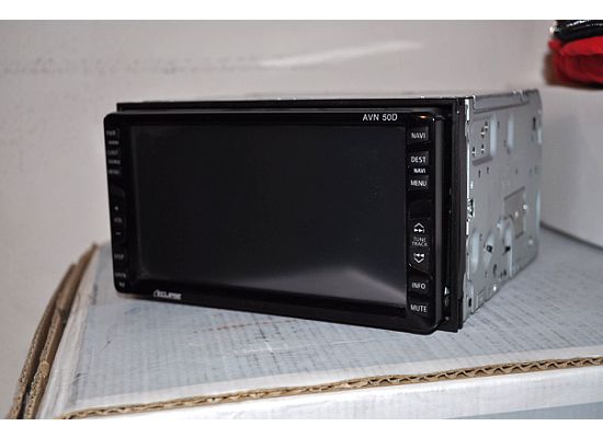

I am the process of installing Eclipse AVN-50D (I have a post just under this one: http://www.toyota-4runner.org/audio-electronics/81367-eclipse-avn-50d-installation-questions.html ) and I am still trying to find wiring diagram\info for wheel control for the 4Runner and AVN unit….
I installed an Eclipse 6620. The original radio brackets bolted right on to the unit annd all the connectors plugged right in without any adapters. Everything worked perfectly. Is the 50D a single DIN unit? Is it an older unit? The reason I ask is because I just figured all Eclipse units would be plug-n-play like mine was.
AVN-50D is double din, I am sure it is older then 6620. It was and probably still is very popular on this site… here is link where you see more pictures: http://www.toyota-4runner.org/class...vn50d-navigation-gps-dvd-6-5-touchscreen.html

Okay, that's definitely an older model than the 6620. Mine has a 7-inch screen and the buttons are on the bottom. Are you sure the radio brackets won't work?
Also, I'm confused about your connection problems. I opened the link and the first post says "This unit plugs directly into stock NON JBL radio harness. There is no wiring required. Pull your old radio out and plug this one in. Thats it!! Also has steering wheel control capability. Unplug your steering wheel controls from your stock radio and plug it directly into this unit and thats it. No adapter required."
But it doesn't work on your 4Runner?
Mounting brackets do work, I am taking about side trim panels that needs to be added to cover ½ inch gaps on each side of Eclipse (Front panel of the Eclipse is not as wide as OEM Radio).
Apparently that post is not 100% correct.. just as I said on my first reply (see above): power and audio connections are plug in play, but not wheel control…
Obviously if you do not have wheel control or you just do not connect them and you do not care about ½ inch gaps on the sides then AVN-50D is plug in play..
I am sure it is not just on my 4Runner.
