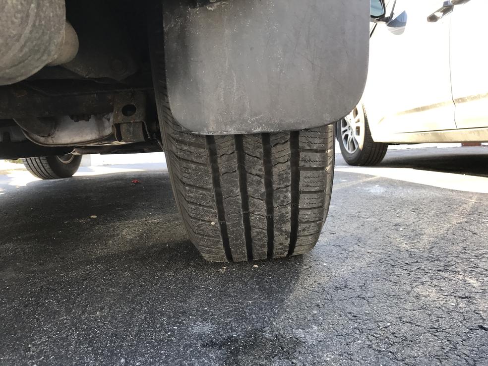

Picture of the tire

i'd
get all the tires balanced, and have the alignment checked and ask them for the tech sheet....and post it here
Picture of the tire
Could just be me, but that looks off camber. (top of tire pulled towards cab) (which is not a good sign on the rear axle) Negative? camber would explain why the outer edge is clean. If you have the 4WD V8, I would be worried about running a new tire with 3 tires with 18k on them. iirc, a good tire shop can trim a tire down to match tread depth
Take it in to a real tire shop or a trusted mechanic. Either one should point you in the right direction.
Does the new tire which is in the passenger rear
Whoa, I think many of us (incl me) are guilty of assuming you hit the front tire. Evidently not the case.
Is this right OP? MAYBE YOU SHOULD CLARIFY.
Agree with Ninja, that rear tire doesn't look right. I retract all those alignment comments I made. Still, something is wrong. Fix it before you have a serious problem.
