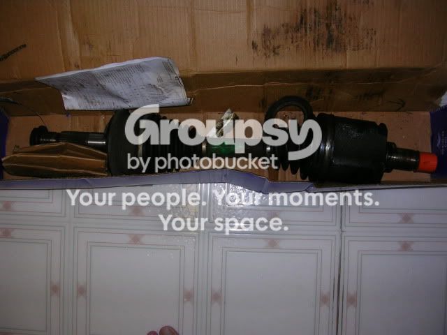

For future reference... in the taco world, for OEM CV shafts, there were two types, we called them:
The green label shafts (ADD hubs):
DSCN3936.jpg~original
and the blue label shafts (Manual hubs).
2m3po51.jpg~original
(Best pic I could find, bottom shaft)
On the the two 4runners I've owned (96 and 00), and the others I've worked on, they all came with CV shafts that had no labels on them. What I did notice about the ADD Tacoma shafts vs the ADD 4Runner shafts, is that the Tacoma shaft was straight all the way across (see top pic for reference), and the 4Runner shaft was necked down in the middle. See above shaft in the below pic for reference....
33700720019_large.jpg~original
I have no idea if one is stronger than the other, what I do know is that they are interchangeable between platforms, I currently run green label Taco shafts in my 4Runner.

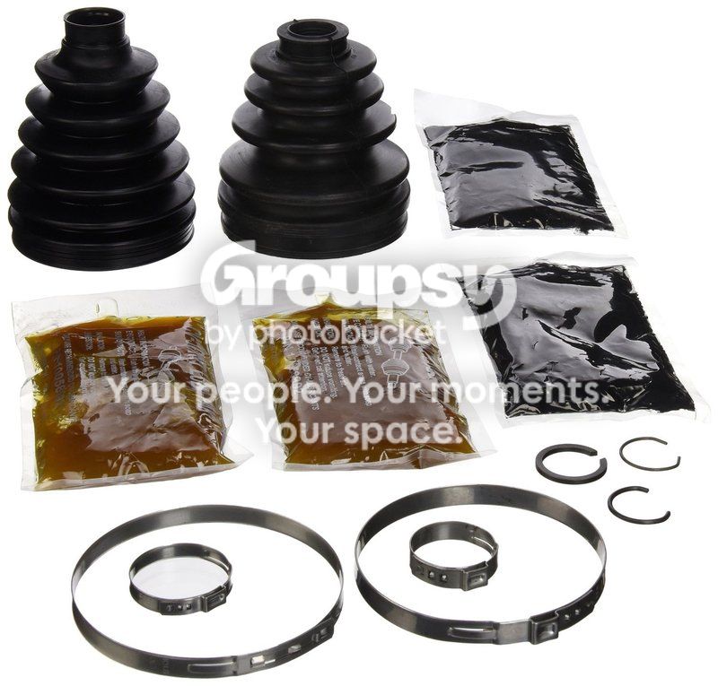

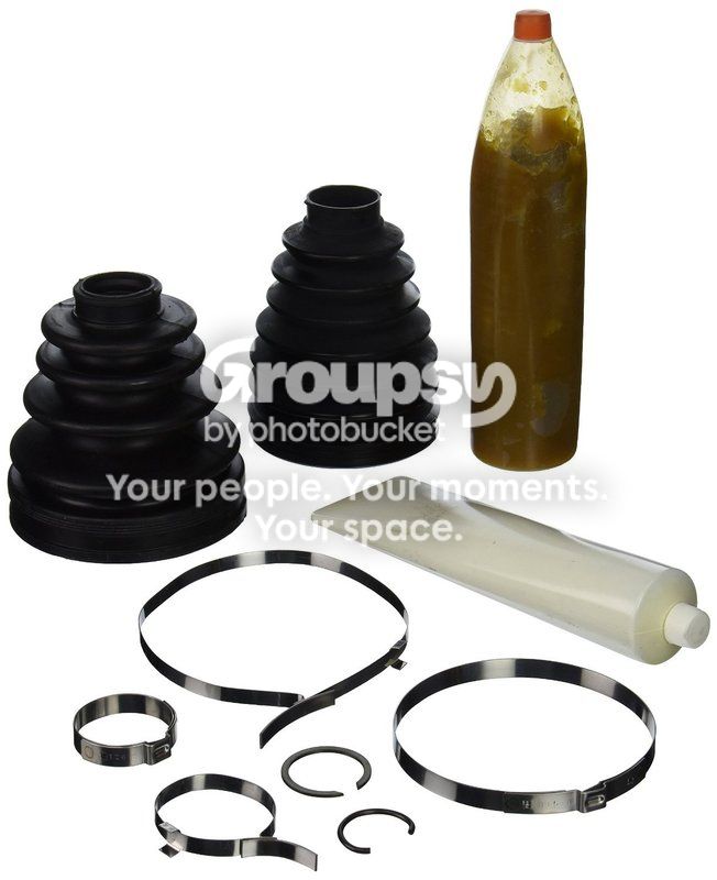

Ok here are some pics from Amazon showing the boot kits.
4Runner 04438-35060:
4Runner%20Boot%20kit.jpg~original
and Tacoma 04438-04021:
Tacoma%20boot%20kit.jpg~original
As you can see, the grease is packaged a little fancier in the 4Runner kit, and the Taco kit uses the squeeze band clamps for all 4 positions, where as the 4Runner kit uses 2 fold over clamps for the inner position. The Taco kit also includes an extra snap ring, but for what I do not know. Maybe what holds on the articulating joint that you could possibly smack off like in this video?
There is a price difference on Camelback, the 4Runner kit is $43.80 and the Tacoma kit is $35.02. The boots look the same though. Another problem with the 4Runner kit is as of 11/19/2015 it's still out of stock.
So I ordered a Tacoma boot kit and went to reboot a 4Runner CV. What I found was that the 4Runner CV is bigger around than the Tacoma. I estimate the tapered down area on the 4runner shafts are actually the same diameter as the Taco shaft, so really the 4runner shafts bulk up.
On the outer joint, the boot will stretch enough to get on there and the outer band clamp fits just fine. The smaller part does take some working and forcing to get on there but it will eventually go. The smaller band clamp is too small the way it come but I was able to move where it's held together after punching out the loosest tab and flattening the second tab so the clamp bit where it needed to and wasn't raised up by the second tab.
On the inner joint, the smaller part of the boot will fit but again, the band clamp will have to be modified. The larger end of the boot will be extremely difficult to fit over and get in place. The larger band clamp is too small and I couldn't figure out a way to modify it. Also the band clamp will have to be extremely tight to have any chance of sealing the rubber around the 3 indents. I tried using 3 hose clamps daisy chained together, as I didn't have a large enough one, but I couldn't get them tight enough. They were cheap Harbor Freight clamps so I wonder if using a better quality clamp would seal it tight enough.
The snap ring is very different. The 4runner ring is larger:
IMG_4783%20CV%20Snap%20Ring%204Runner%20top.jpg~original
and thinner:
IMG_4785%20CV%20Snap%20Ring%204Runner%20right.jpg~original
So in a pinch, the boot kit can work for the outer joint, but the fight for the inner joint is just not worth it. And you would need to reuse the snap rings instead of the ones with the kit.
