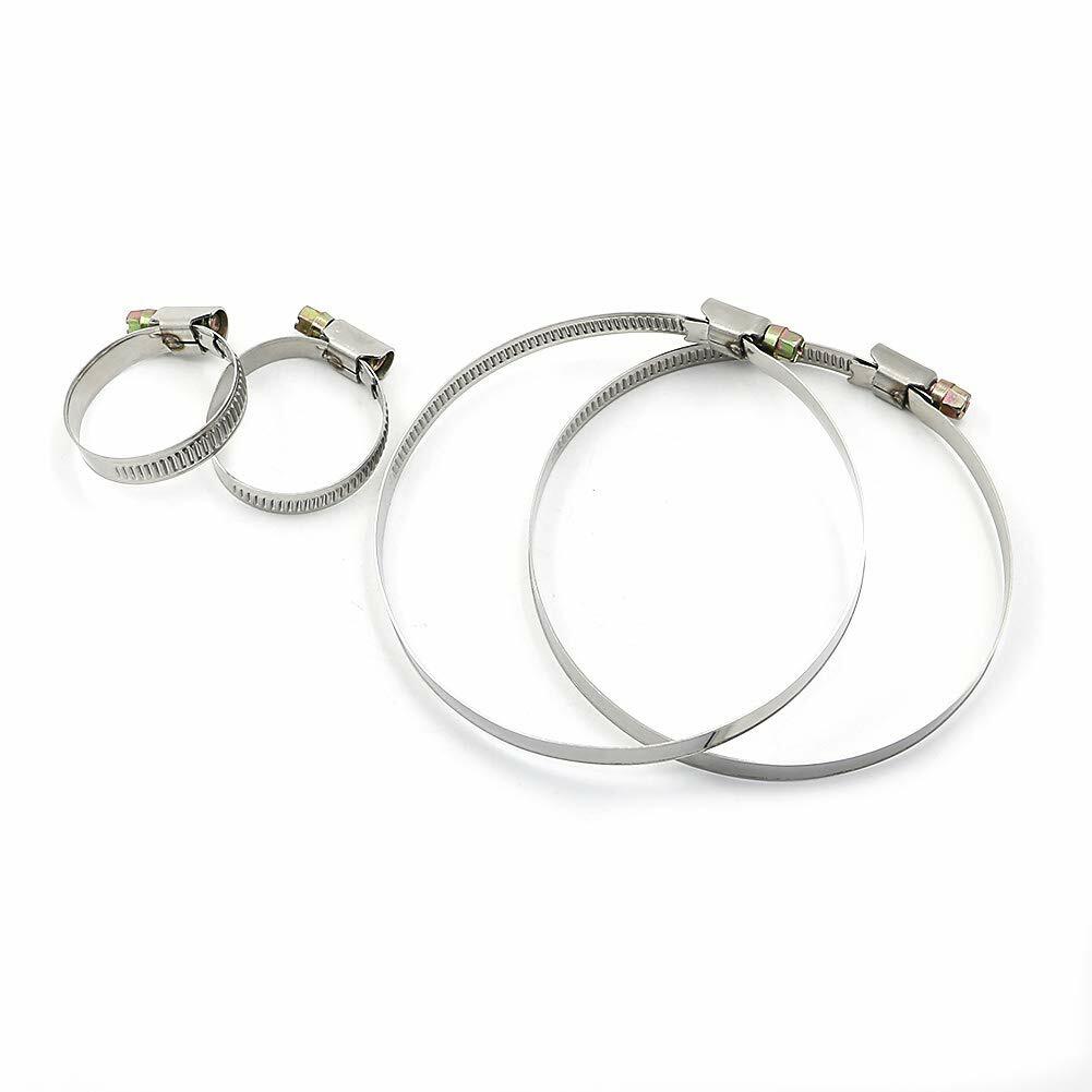

Anyway, it's a set of rounded edge worm-drive clamps like this:
*if the pic link even works...
I had only used the inners, but they've been holding for years.
I found one of the OEM clamps in a box from my re-boot-stretch mod.
It's yours if you want it. Just IM me when you get a chance.
