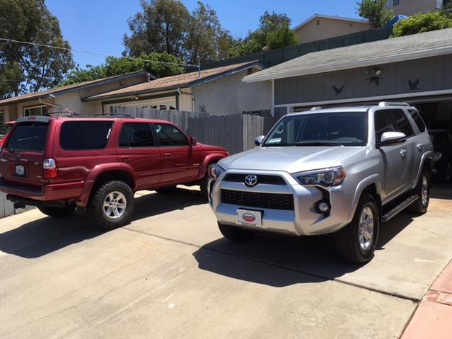

My wife has been looking for a 4-Runner, so we were out today looking at some. We did see a TRD Offroad in silver, we both fell for it, but the sticker said $42030.00, and another sticker saying dealer marked up $2999.00 so $45,000 + tax, lic. and so on. We did not buy this, but she did get a SR5 Premium 4x4 in silver so she is a happy girl, and that makes me a happy man.
