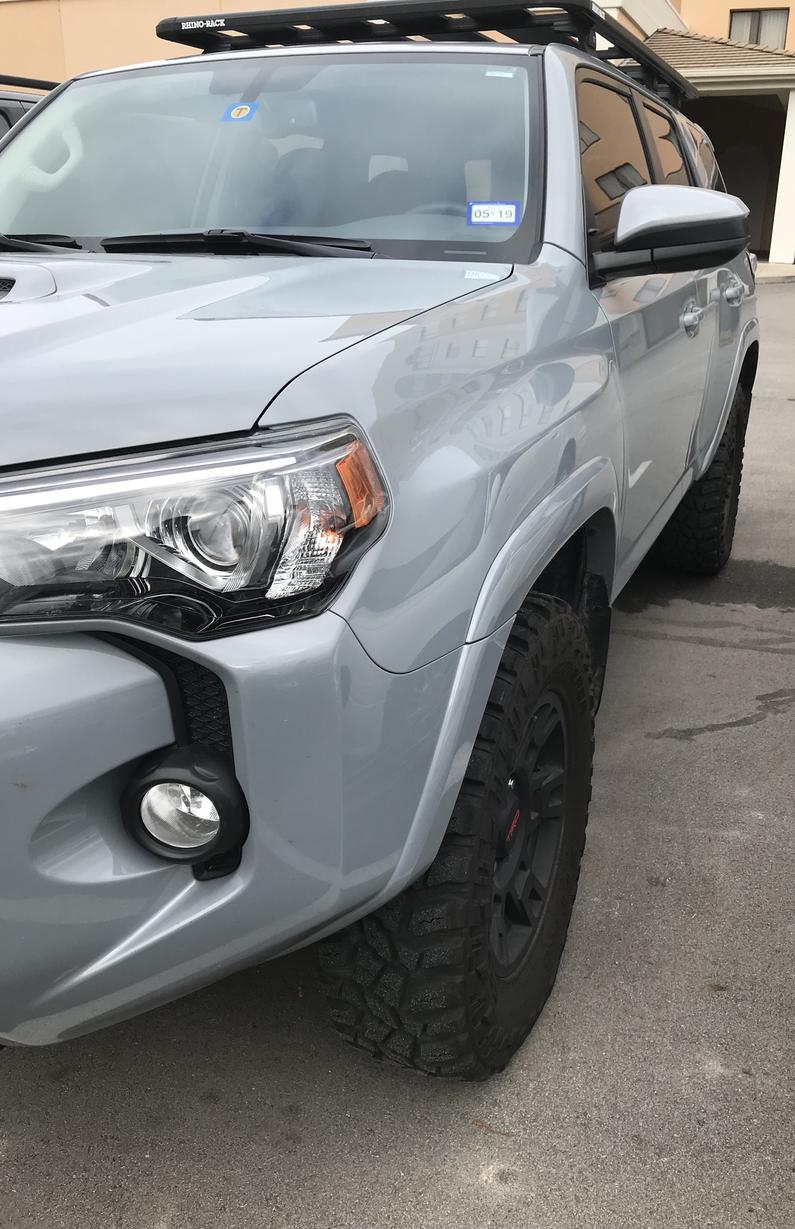

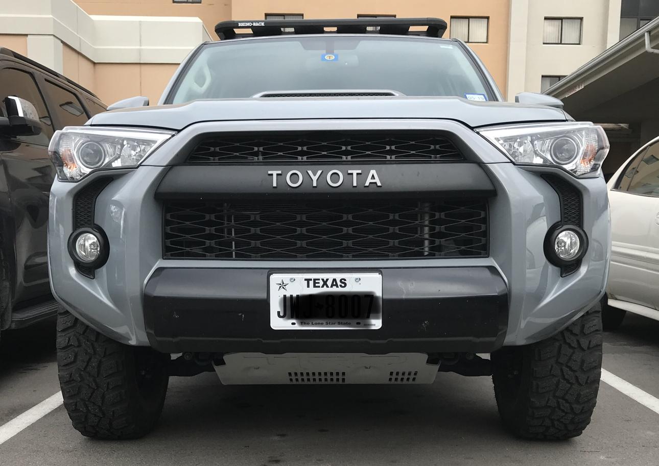

I have 255/75/17 Cooper stt pros now. No rubbing at all. That being said once I change out suspension I am going with 255/80/17 or 34/10.50/17. To get back to your question, the biggest difference will be in give width. 255 will not rub and 275 may at full lock. Just comes down to width and the difference is negligible.
Nice! Do you have any front and side shots of your truck? I always think the KO2s are beefier looking than the other tires even though they are the same in size.
Looks great. I think the biggest difference when it comes to stock wheels the trd off road wheels have more offset than the trd pro wheels.
Oh and here are couple of pics though not full side shot due to being in a hotel parking lot.
