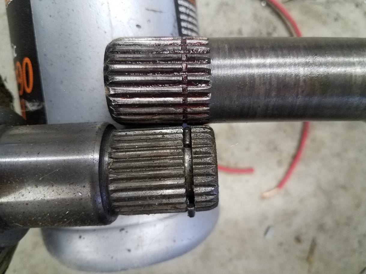

The axle shaft diameters are different but is that also the case for the splined ends? I am seeing that ORS sells a manual hub conversion kit that seems to involve installing your original ADD inner joint onto a new non-ADD CV (sold without the inner joint)
Which one is the non-ADD? I know - the picture gives away too much.
Covered in Prussian blue to try to find the fitment issues but here's what mine looked like. I guess it needs to look like the bottom on in your picture.
I just got done measuring 4 different CV axles - 2 OEM (1 4runner/1 non-ADD Taco) and 2 Autozone spares (1 4runner/1 non-ADD Taco. The Inner CV spline lengths and diameters are the same. In the pic the top is a non-ADD Autozone and the bottom is an OEM 4runner/ADD
