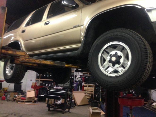

4Runter New member Dec 6, 2012 #4 Drained and replenished the oils, but ended up not dropping the tranny pan. Will periodically drain the tranny and add oil, repeat until it is cleaner. Also changed the fuel filter.

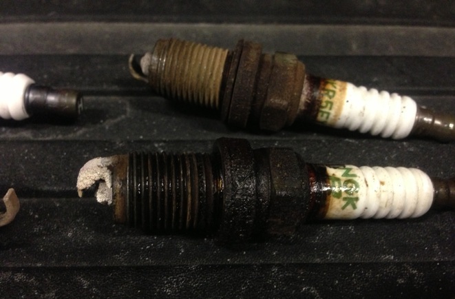

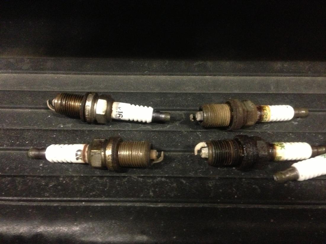

4Runter New member Dec 6, 2012 #5 Pulled the spark plugs. I'll let the pictures do the talking. Attachments spark plugs.jpg 89 KB · Views: 402 4 plugs.jpg 99.9 KB · Views: 364
