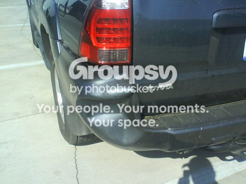

Long story short, I took my car in for a TSB, the tech backed it into a hydraulic lift arm and F'd up my bumper pretty good. They took it to their body shop, had it fixed, then the body shop tech took another whack at it and F'd up my rear bumper again. During this time, I negotiated a front spacer lift including installation from the dealer. When I got it back, it had a front spacer lift installed (including alignment). Below is a pic of the bumper after they had their way with it. My first question is if this is enough impact to create frame or alignment issues?

So for you guys out there, ARE my alignment measurements normal??? Is the spacer lift (even though the front end is now within specs) throwing off the rear end? Could this have been caused by the fender bender as seen above? I feel like I am caught between a rock and a hard place with my car still pulling to the right. Any help or advice would be greatly appreciated!!!
