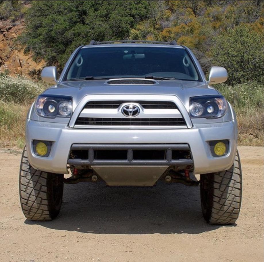

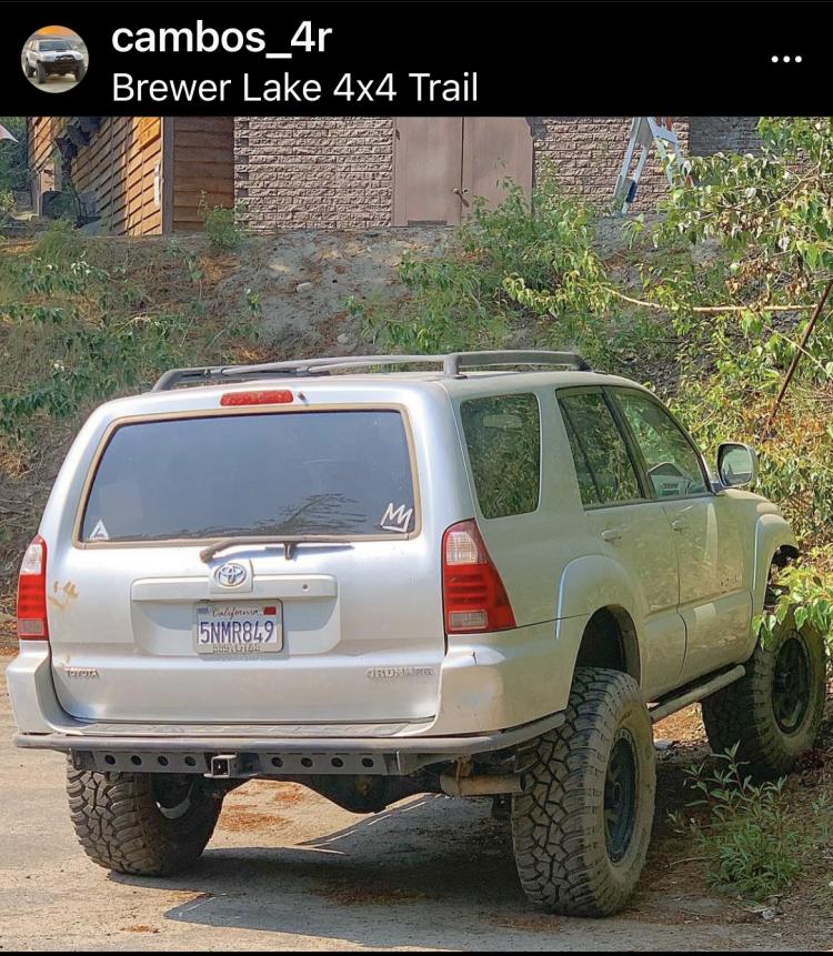

A couple of my favorites. Rear bumper is from True North Fabrications, front is custom made.
