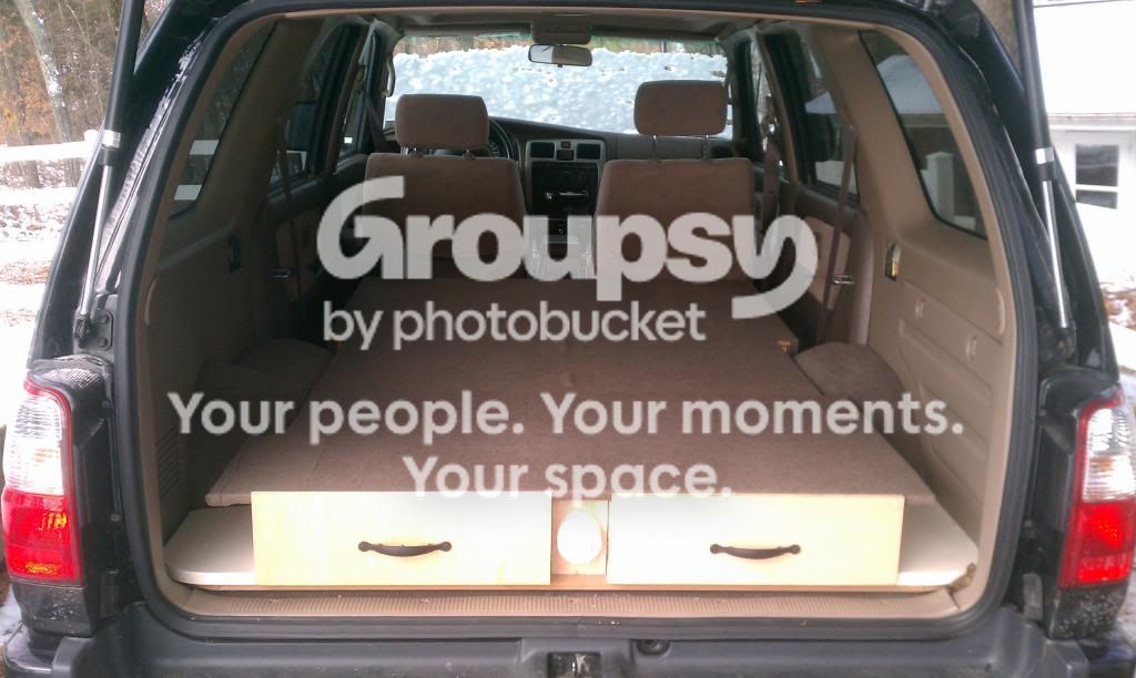

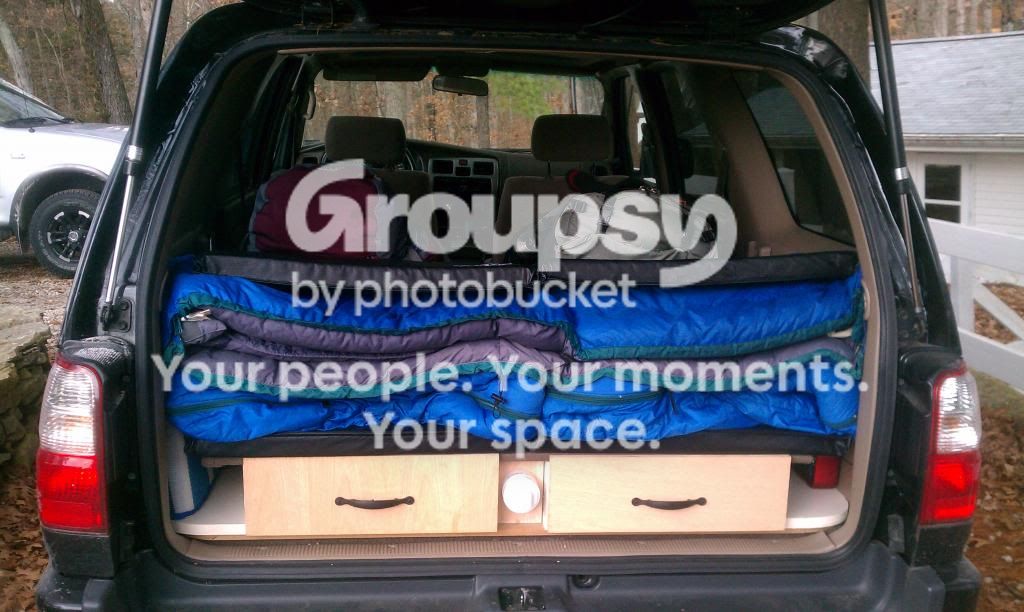

My sleeping platform was mentioned above so I figured I'd chime in. We also considered going between the FJ and a 4runner. I'm very glad we choose the 4runner for a couple reasons. First off, the ground clearance is comparable, but the head room with a platform is not. I'm 5'11" and my platform is the perfect length for my to lay down and not have to move the seats forward. The rear drawers on my platform are 4" tall, and the overall height I think is 5" in the rear. I wanted to get a low profile system with plenty of room to sit up if we were stuck inside.
When building your own, you have a lot more choices on what you can do. The only thing I wish I did differently was use 80/20 extruded aluminum rather than the free mdf board I used. I have two slide out drawers in the back, one if the perfect size for a two burner camp stove, and the other is for the wife's stuff. Two smaller hatches directly in front of that holds camp fuel, cook set, paper towels, and so on. The two front compartments are quite a bit deeper. The drivers side can hold over a weeks worth of food with no problem, and the passenger side holds our tent, sleeping pads, and other small backpacking gear. As far as sleeping goes, plenty of room. That being said, I do have a 3rd Gen, and not a 4th Gen. Basic measurements of my sleep area is a full size bed. I have two MMA wrestling mats side by side with a full size egg crate on the top of it. My wife and I have two zero degree down bags that we zip together. The bag fills the platform perfectly, and has plenty of room for the two of us and our small dog.
You also talked about the wheel arches in the back. My platform is well below the top of the arches, and it doesn't cause any issues. I thought about notching the sleeping pads around them, but there was no need to do that.
...could 2 people (up to 6' tall) sleep in the back and still be able to sit upright? I thought I read that the rear seats do not fold in the 4th gen but in pictures they look like they do. In any case I could remove them if necessary.
The roof is low and being able to sit up is going to depend on torso length and what you have under you for sleeping. I'm 5' 9" with somewhat long legs for my height and sitting upright leaves very little room above my head, although I'm missing about an inch or two of height due to the double decker (OEM) storage system which makes the entire area flat when the seats are folded down. See here. The distance from the (removable) folded seat backs to the tailgate is 5' 10".
I can't sit completely upright under the moon roof area which takes up a solid 2+ inches of headroom and extends rearward about as far as the rear door handles. If you can find any, you may want to look at some trucks without a moon rooof. I still love having one, though, for the ability to cover it with a screen and have instant access to bug free ventilation.

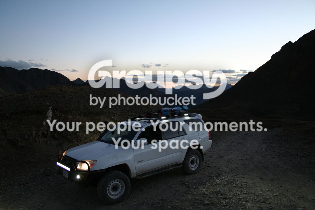

I just completed an 11,000km trip with my 4th gen and I couldnt ask for more!(maybe an awning) . I have a sleeping platform with a fridge integrated in there and I slept better than I do at home. The 4runner took me everywhere I wanted to from the high country in Colorado to most of the difficult trails in Moab.
Here is a pic of the truck. I'll snap one of the inside set up.
Pics aren't showing up? I created an account on that site hoping they would show up, very interested.
Hmmm... I just tried in different browsers without logging in, and they do show up for me. Were you able to see them after registering for Expedition Portal? Please do let me know if you still have trouble.
Thanks for the reply, just tried it on my phone and was able to see them. Must have been blocked by my work firewall originally.
Whoa I'm diggin the white steelies! What kind of snorkel you got on there?
