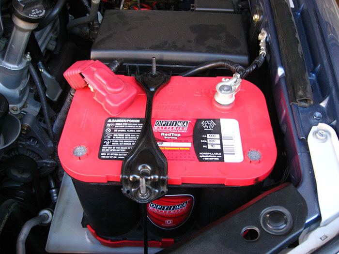

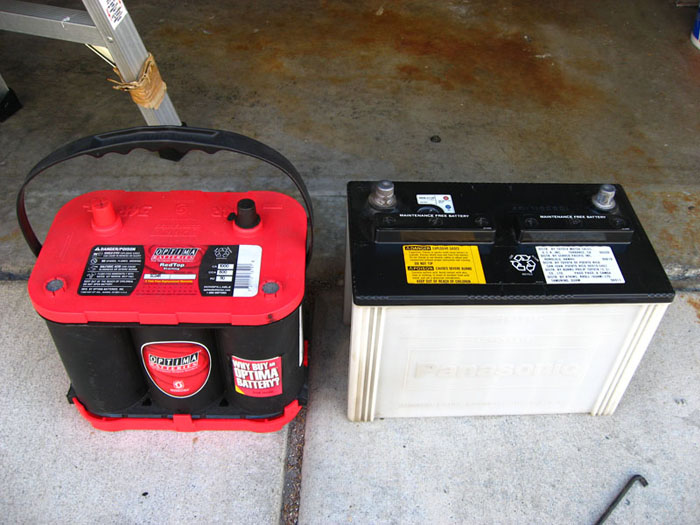

Got the new Optima Red Top 34R in. Took me a few trips to different places, but found an Interstate Battery distributor that carries it.
The fit is okay, it's pretty small compared to the stock battery. I used the cover and put it on the bottom to get it up to the same height as the stock battery. The terminals on the Optima are located further away from the edges and made it difficult to get the negative side onto the terminal since the ground wire is so short (which is why I had to mount it off to the right).
Should I be worried about problems with having the mounting bracket off center or the ground wire being very tight?

Looks fine to me, but I'd be concern with the metal bracket being closer to that positive terminal...in some sort of accident, if the bracket comes in contact with the positive terminal...it could create a short and cause a fire.
I guess this is an issue with the stock OEM battery as well, but seems like you have less of a safety margin with the Optima battery.
However, is the metal bracket grounded? I never looked but is the battery try metal or some sort of plastic composite?
It is just me, but I'd feel better with a plastic/composite battery bracket.
J
Wrap the bracket with electrical tape and you should be fine...The Optima may be smaller but is definitely more formidable!
