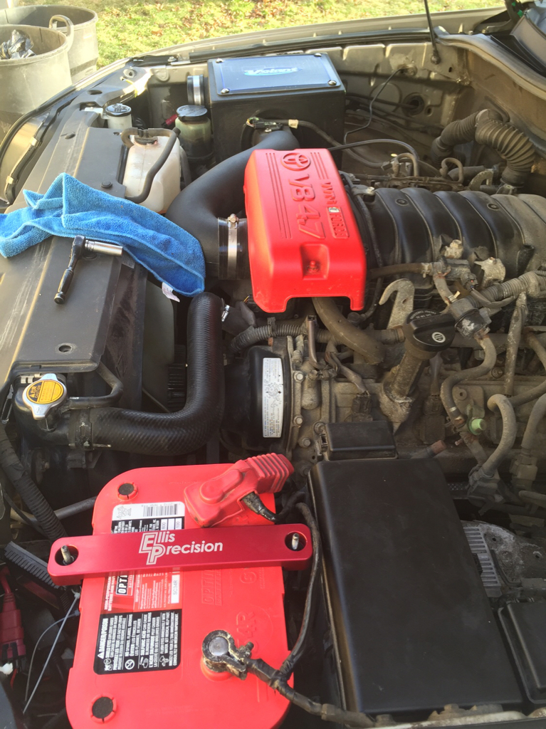

I just bought an Optima 34R red top to replace the 24F in my 2008 4Runner.
Elevation wise, it fits well on the shim block that comes with the battery. You do have to push it far from center in order to get the short ground terminal attached, and then you end up having to pull the positive cable terminal a little harder than I'd like to attach it. But it fits.
I cut up an old bicycle tire and used the rubber U shape of that to wrap around the mounting bar that goes across the battery, because it was maybe half an inch from the positive terminal.
Or you can get one of these bad boys from Joel [MENTION=139559]Ellis Precision[/MENTION]
Finishes it off nicely imo
