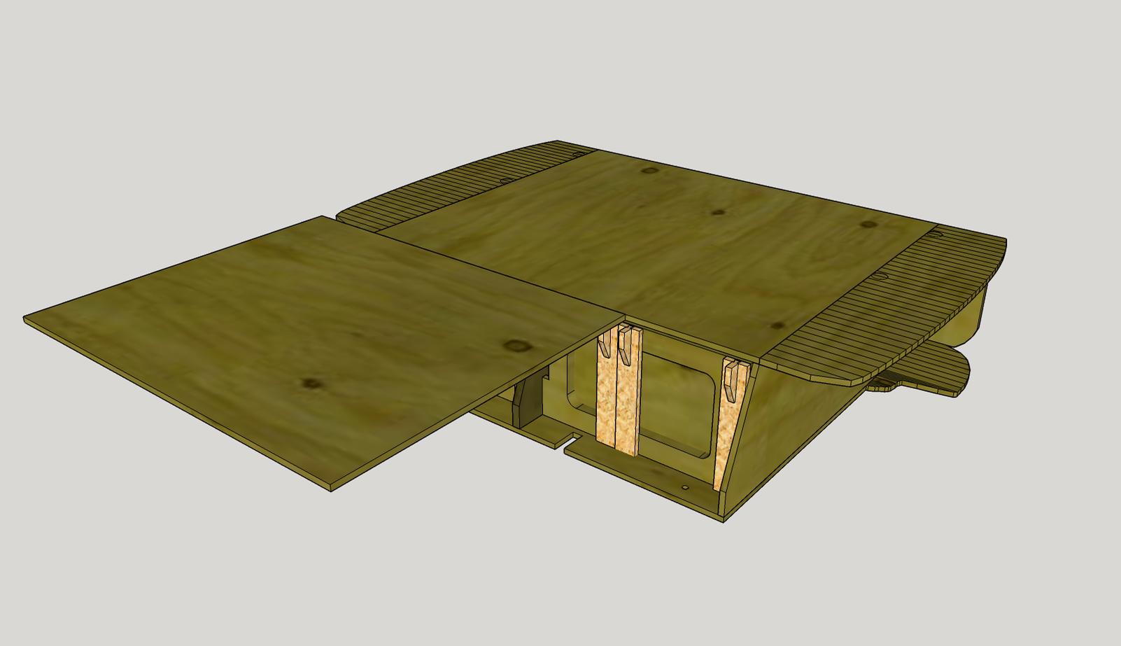

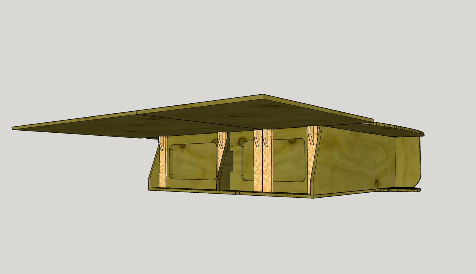

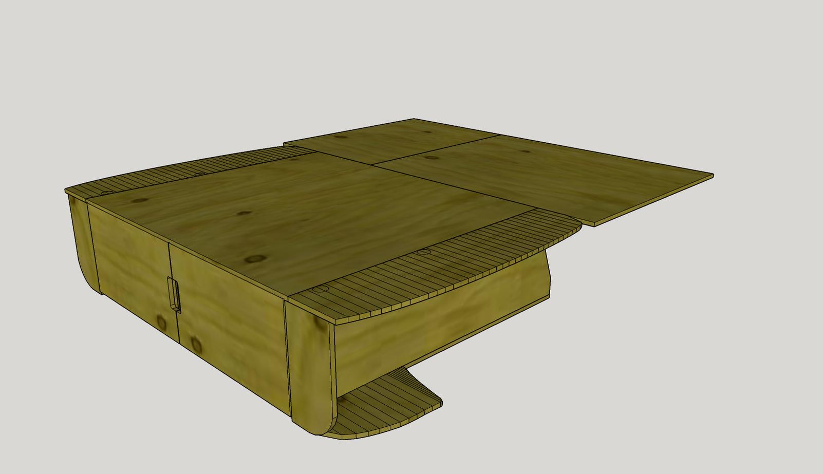

Yes I've added sleeping platforms to mine. Installed 5 extra Threaded inserts in the front of the drawers (behind the Back seat), then made 5 "legs" that sit on bottom plate where the drawers are mounted to the Truck and screw into the the inserts. 2 1/2" plywood platforms to match the 60 / 40 seats that rest on the legs and on the flipped up seat bottoms. Sleeps 2 adults no problem.
See Below for some shots from my Sketchup design based on the Adventure Index Plans, showing the Sleeping platform and legs.
I can run with either side seat up or down, or both up/down depending on who and what I'm running with on a trip.

That's awesome! I love that you kept the ability to use the back seats.
Question tho,
What's all that hanging plywood being supported by? When you go to lay down.
Question tho, What's all that hanging plywood being supported by? When you go to lay down.
Would it be possible to get in truck pics?
Thank you.
I did not model the interior of the truck so that is all missing from the pics for clarity. The hanging plywood seen above is supported by the Rear seat bottoms when they are folded up against the back of the front seats. The area under the hanging plywood offers additional storage on the flat backs of the folded down rear seats. I can then use the Child Restraint hold downs and the 2 D-rings that hold down the drawer system to tie things down.
