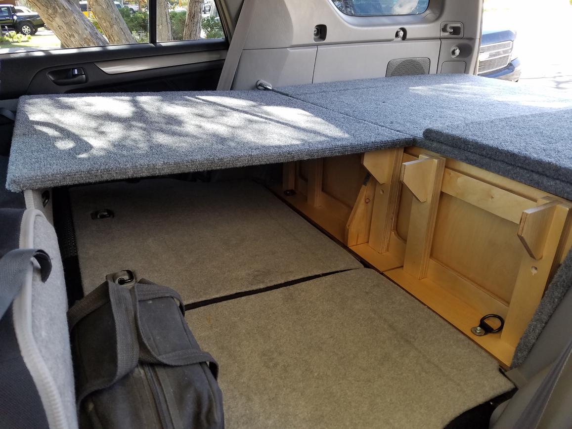

Look at Sleeping platform supports installed on front of Drawer system from Passenger Rear door both Rear Seats folded down:
http://www.toyota-4runner.org/attachment.php?attachmentid=317264&stc=1&d=1541383411

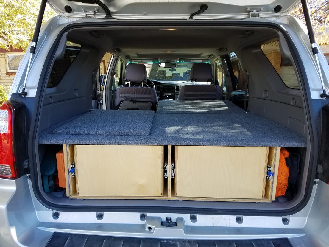

Look at Sleeping platform supports installed on front of Drawer system from Drivers Rear door with Passenger Side Platform installed. This view is similar to one of the Sketchup renders I posted earlier.:
http://www.toyota-4runner.org/attachment.php?attachmentid=317265&stc=1&d=1541383411

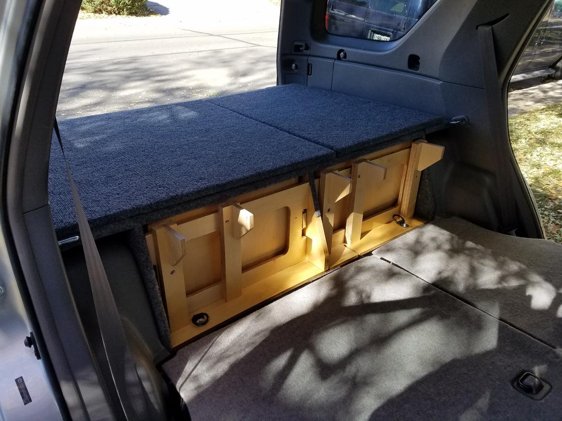

Look at Sleeping platform installed on Passenger Side Platform from rear of Truck (Drawer Fronts and side Panels removed for measuring some improvements for next year):
http://www.toyota-4runner.org/attachment.php?attachmentid=317266&stc=1&d=1541383411

Fantastic! Looks great. I went your route and put carpeting on the top of mine as well. I am really going to consider making these platforms as well, at least the 60 portion as I have a 4x4 piece left from the project yet...
Do you have any sort of latching mechanism? Any issues with the pieces sliding forward?

Thank you.
I find that I use the 60 portion most of the time as the cooler fits nicely in the 40 spot with the seat down and the 60 leaves me plenty of room to sleep when I'm out by myself.
No latching mechanism between the platform and the supports, just gravity. so far no problems with the platform sliding. Each of the supports are held upright by 1 screw just to keep them stable. It's hard to tell from the pic (2018_132943.jpg) but the supports are longer than the room the piece has to slide before hitting the back of the seat. Normally this gap is about 2 inches smaller as I move the front seats back and slightly recline them, pushing the seat bottoms rearwards, closing the gap. If I ever have to remake them I'll go buy a bigger piece of plywood and make them each 2.5"-3.5" longer front to back. These were made from the left over ply from the drawers and I did not want to go buy another sheet.
