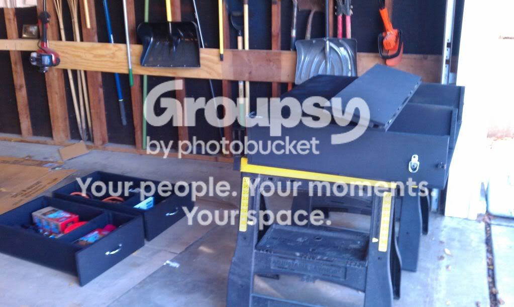

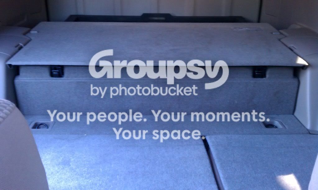

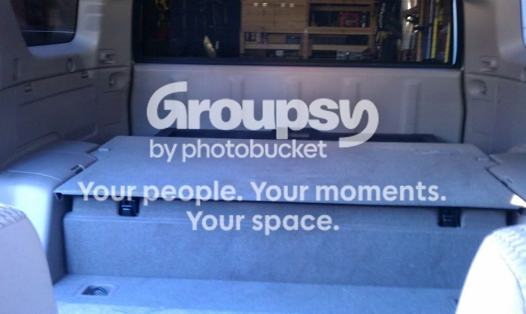

Here are more pictures with the seats down and outside the vehicle

As I mentioned before, I'll need to build a separate unit if I want to incorporate a sleeping platform, or remove the double decker shelf system so I can tie them in together.

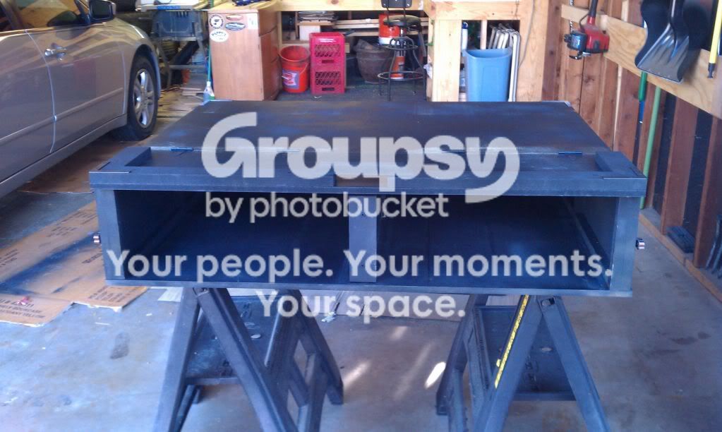

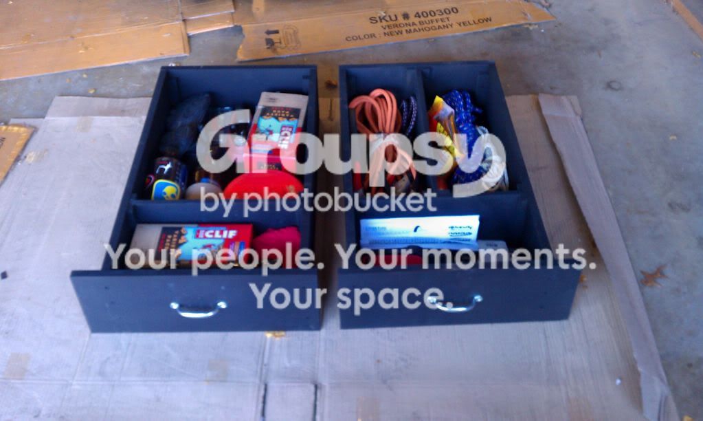

Drawers
IMAG0260.jpg~original
Shell
IMAG0261.jpg~original

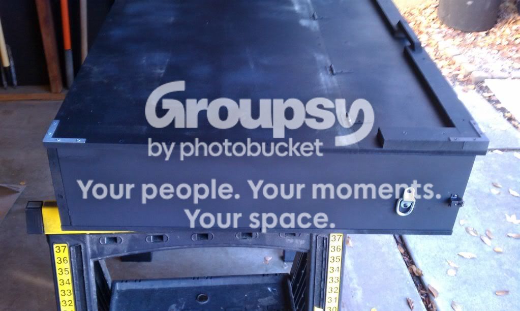

Flip up lid
IMAG0263.jpg~original
Side Detail
IMAG0265.jpg~original

Hey AWESOME build. I was wondering what you used for your drawers to slide out on. Rollers of some sort or just drawers sliding on frame? I literally went out a few hours ago measuring and got almost the exact measurements you posted earlier in the thread haha. Im just going to make mine 12in total height to accomodate some of my needs better.
Just drawers sliding on frame for now. I have considered beefing it up and adding drawer sliders, but there doesn't really seem to be a point to that since it works just fine the way it is. I've also considered removing the DD shelf all together and making a larger unit for more capacity, but haven't really needed anymore room than I already have, yet...
