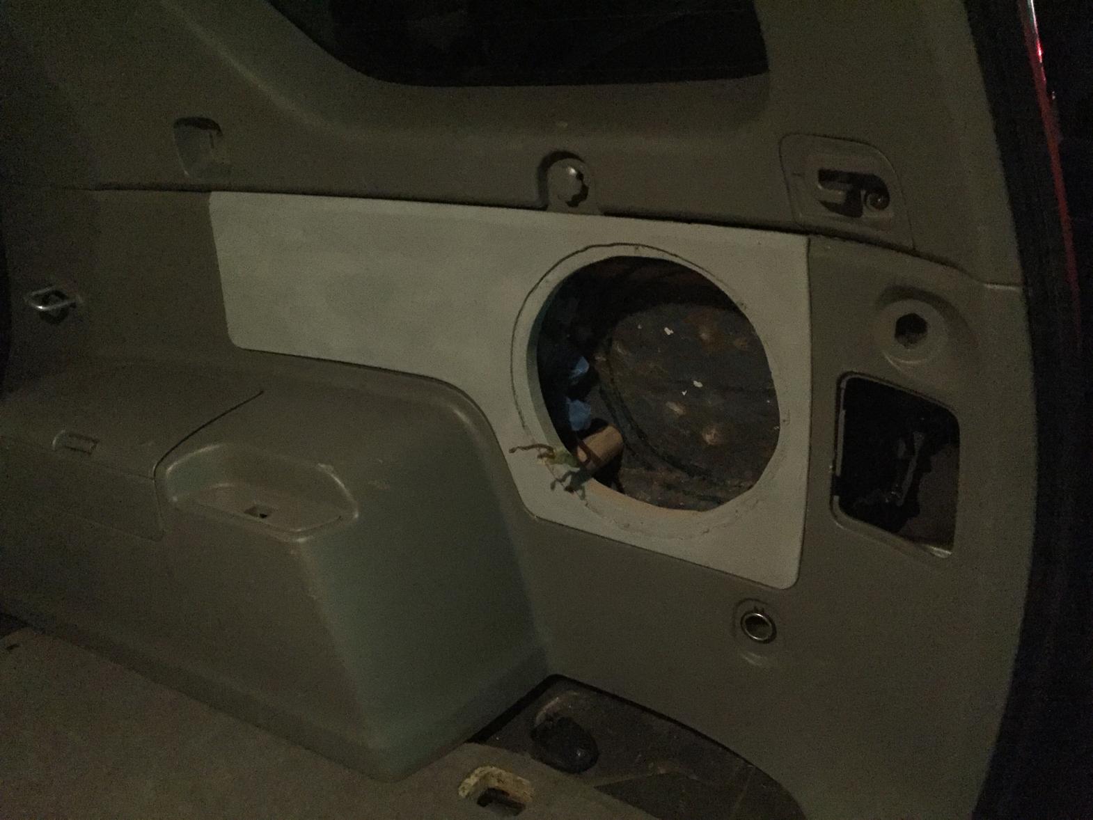

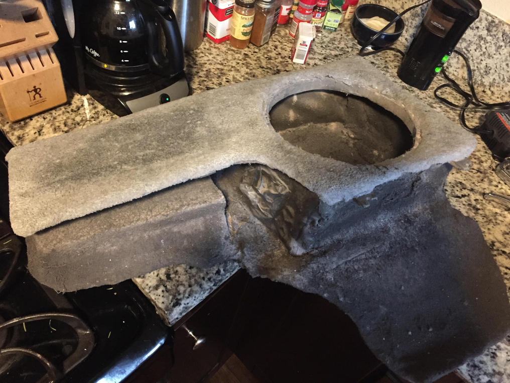

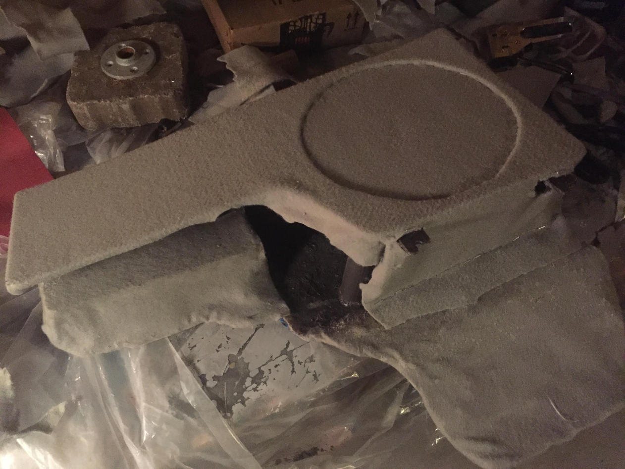

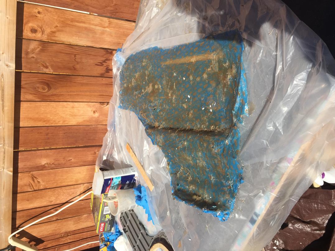

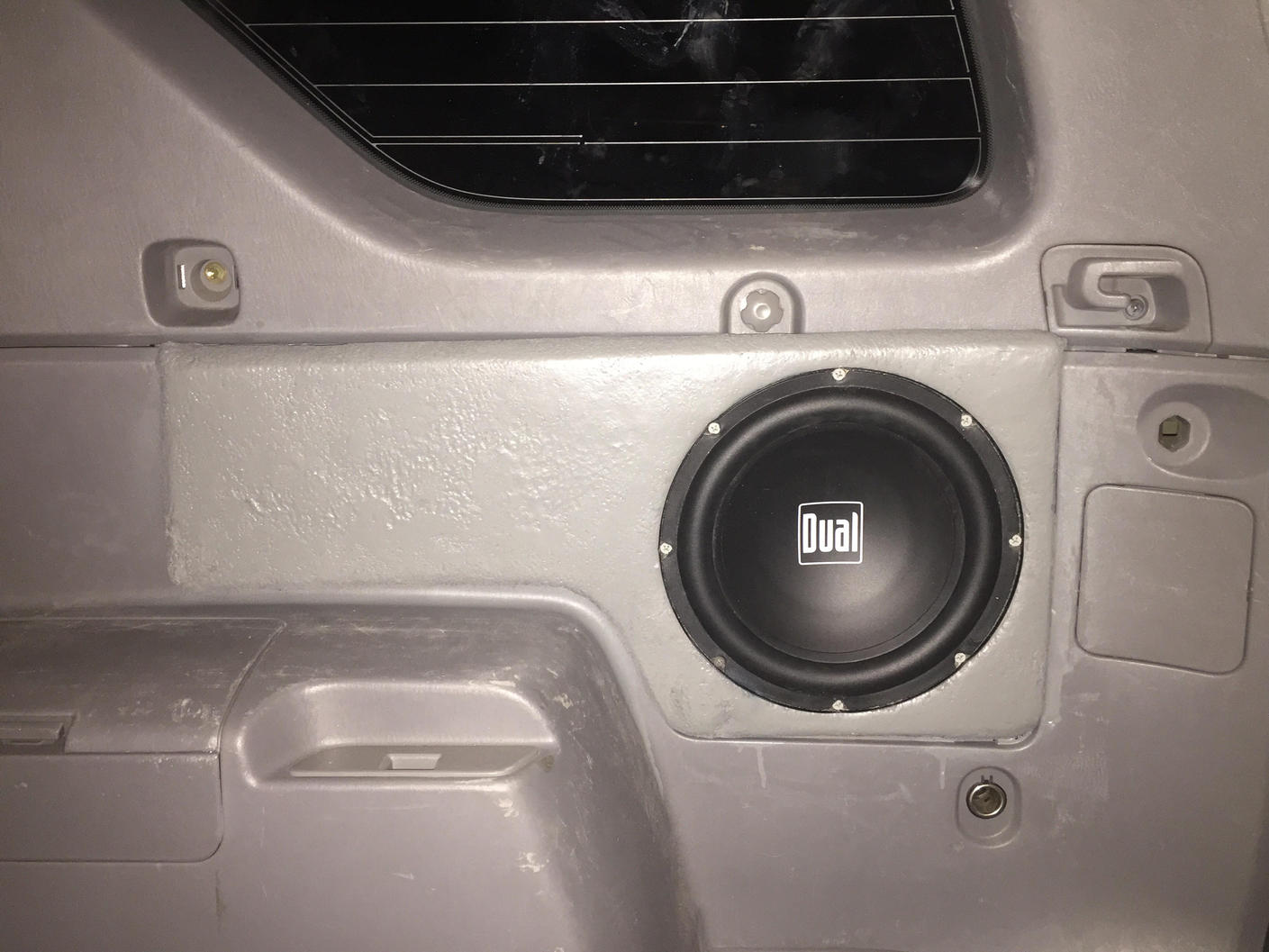

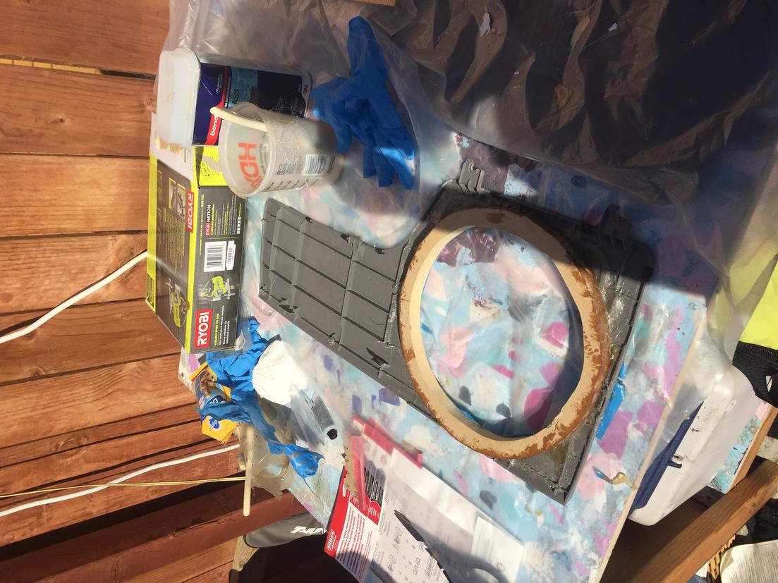

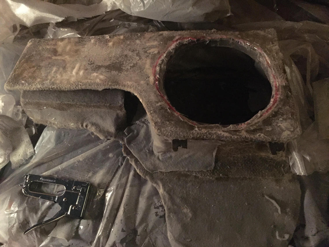

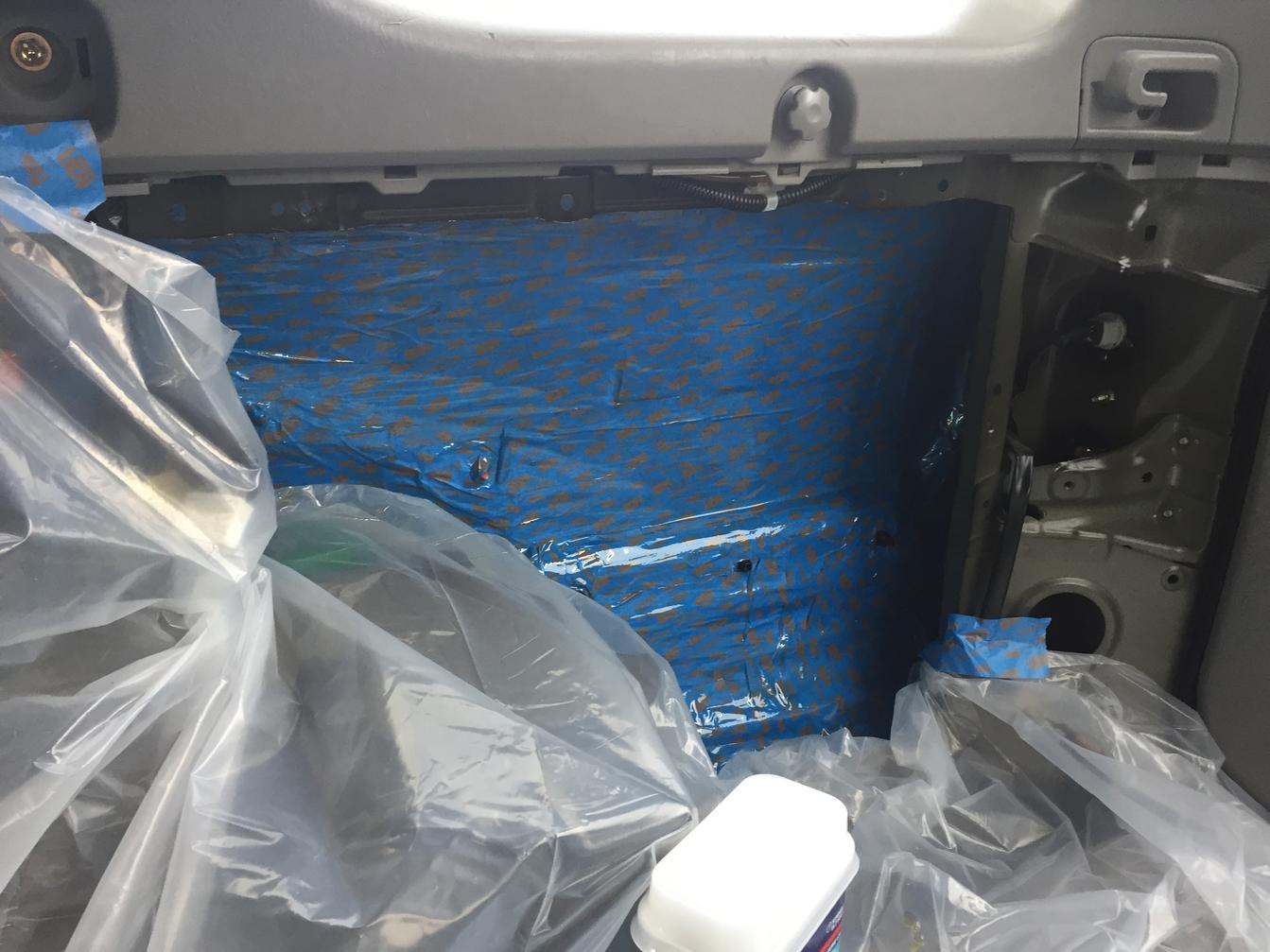

sub box build for my '04 4Runner Limited
This was my first attempt at working with fiberglass. Hope you guys like how it came out!
Supplies used :
-(2) Quarts of Fiberglass Resin
-Fiberglass Mat
-Various grit sandpaper (60, 120, 180, 300, 400, 600)
-Grey Fleece Fabric
-Contact Cement
-Staple Gun
-Wooden Dowels
-MDF for counter sink
-Jig Saw
-Spray primer
-Vinyl and interior car grey spray paint
-Painters tape
