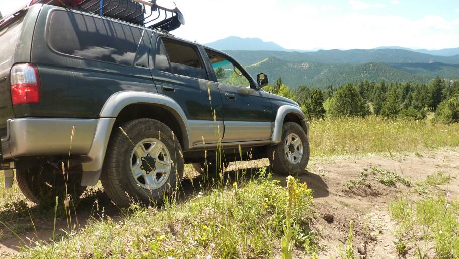

Well as it seems that I am in need of starting a build thread. The base rig is a 2007 4Runner dubbed ExpoT4R (quick Google search says the name is open) I got the rig around a month ago from the stealership with 117k on the 4.7 v8 and with it being the sport package it also included black interior and Xreas suspension (soon to go). This was to replace my beloved 97 Grand Cherokee also built as an overland travel vehicle. It had been on many trip including moab and all around Colorado there was not a county this had not been in, it had also been in almost 20 different states.

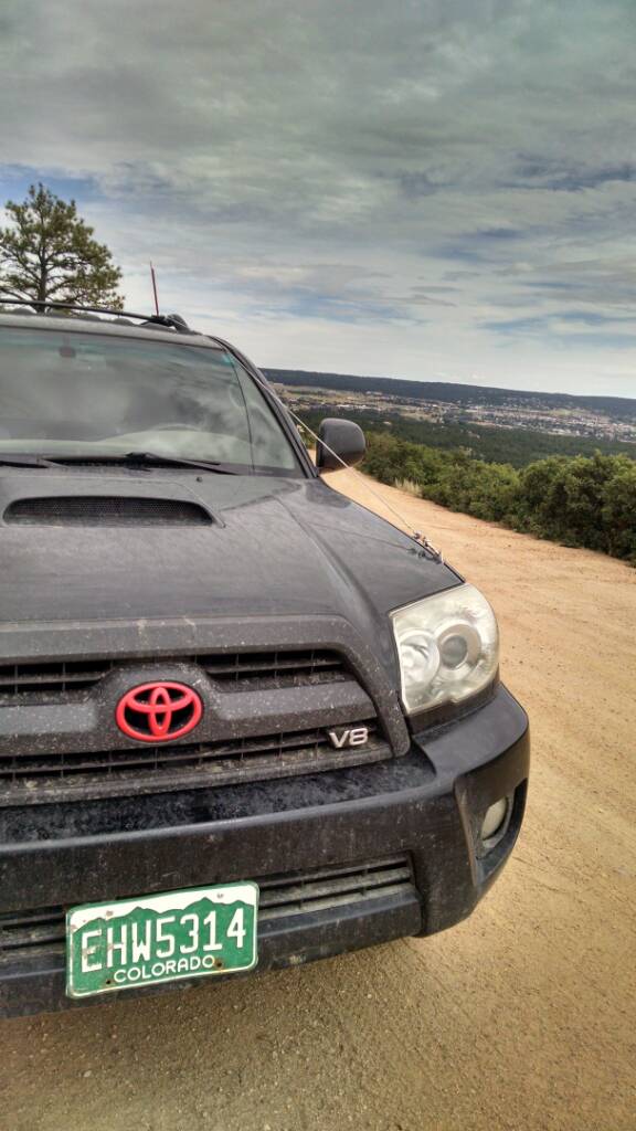

Get rid of the chrome on the grill. While keeping the Toyota badge and v8 badge clean became the Colors of this vehicle are gonna be mostly black but with white accents around on certain parts/ sections of the vehicle.

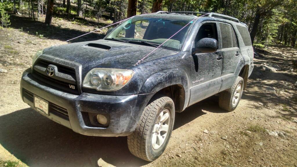

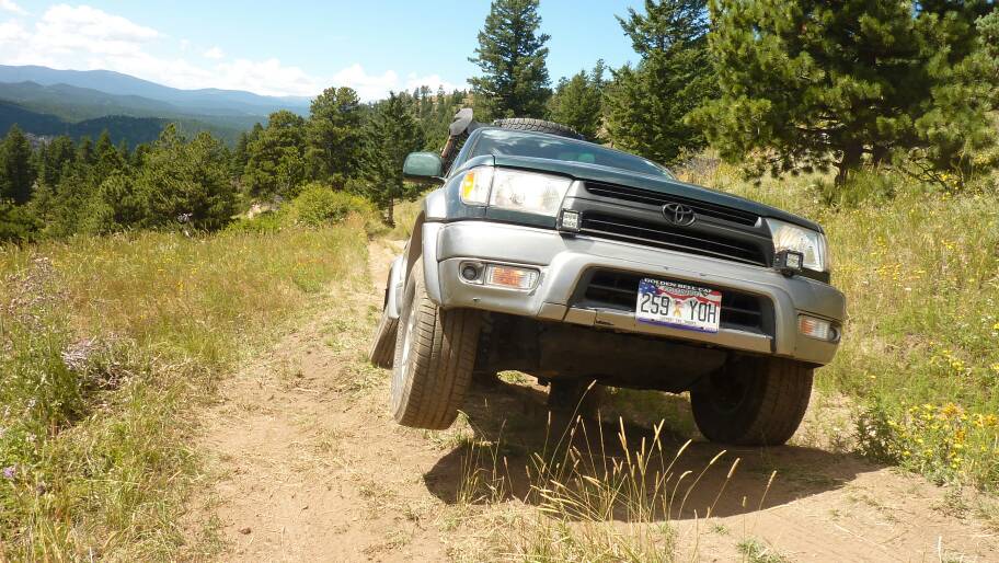

Second thing was to test how much suspension articulation it has with that sport suspension.
[/IMG]
Not to impressive compared to my old vehicle.

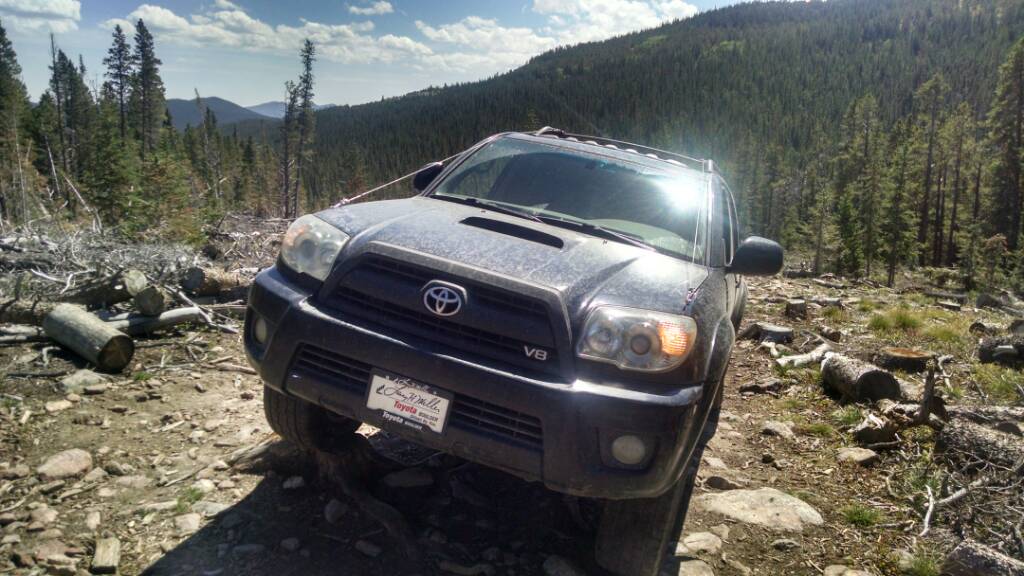

But non the less a good start. Then with in 48 hours took in off into the mountains to test how well it does on the same trail I took my Jeep on when I first got that.
[/IMG]
No picture of the rig but a bit of scenery from Colorado's rocky mountains. (Foothills area). Did very well did everything I asked it to and even made it out of my tests for it including finding the deepest ditch from past rains and trying to get 2 diagonal tires off the ground to test atrac. Sadly it was late enough at night that pics really weren't an option for the back 4runner.

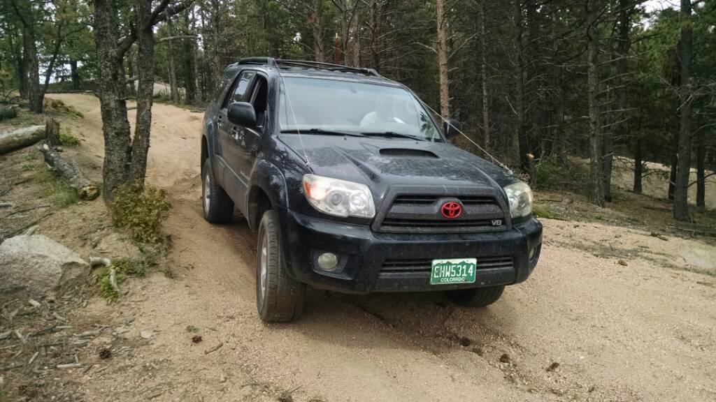

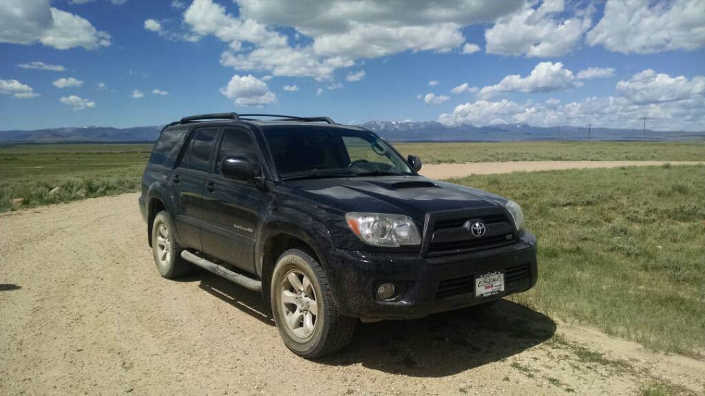

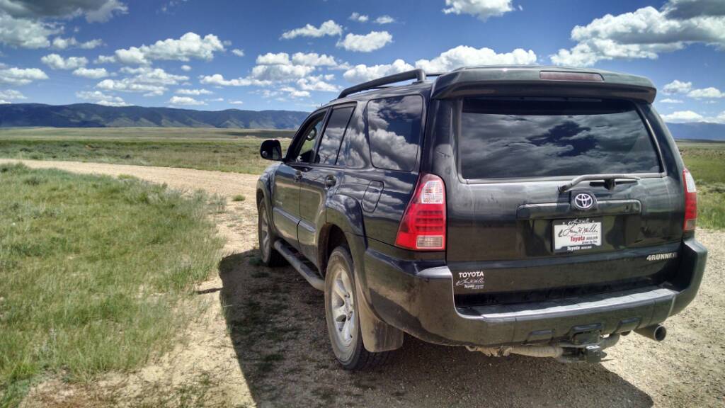

I did in the end make it to the dunes and drove on them. ExpoTR4 did great nice wide tires and lots of power in 4hi with the center diff locker it blasted the Dunes and never dug in. And with a trip total of 411 miles and refueling half way the overall average was around 19-20 MPG and there was around 300 miles of sort and 4x4 roads in all. With no major highways/interstates. Have to say very impressed and with the black paint I managed to nail this awesome photo

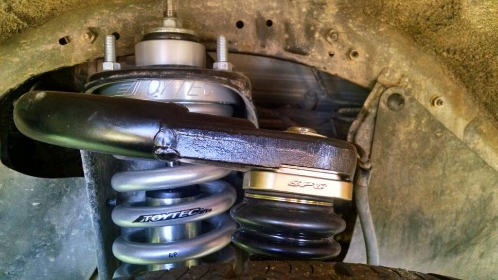

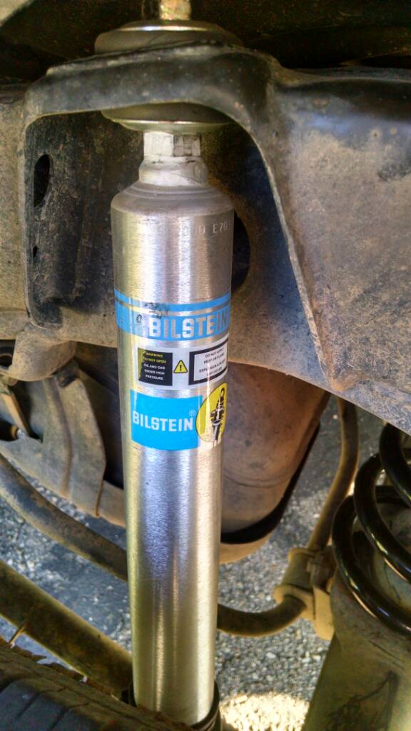

Well it time for update #1 on the build of ExpoT4R. The pictures from above were as it sat when I brought it home as for the current changes, these include a 3'' front lift using Bilstein 5100 front coil overs and toyotec 3" front lift coils.
A 1" front differential Drop kit, to keep the cv shafts at a good angle. Then to correct the alignment issues that these 4th Gen 4runner get when lifted more than 2.5" I also used Light racing mid-long travel upper control arms.
In the back was a similar case with the Bilstein 5100 shocks and toyotec 2.0 2" lift coils to try to get rid of the front end "rake"/ being lower than the back.

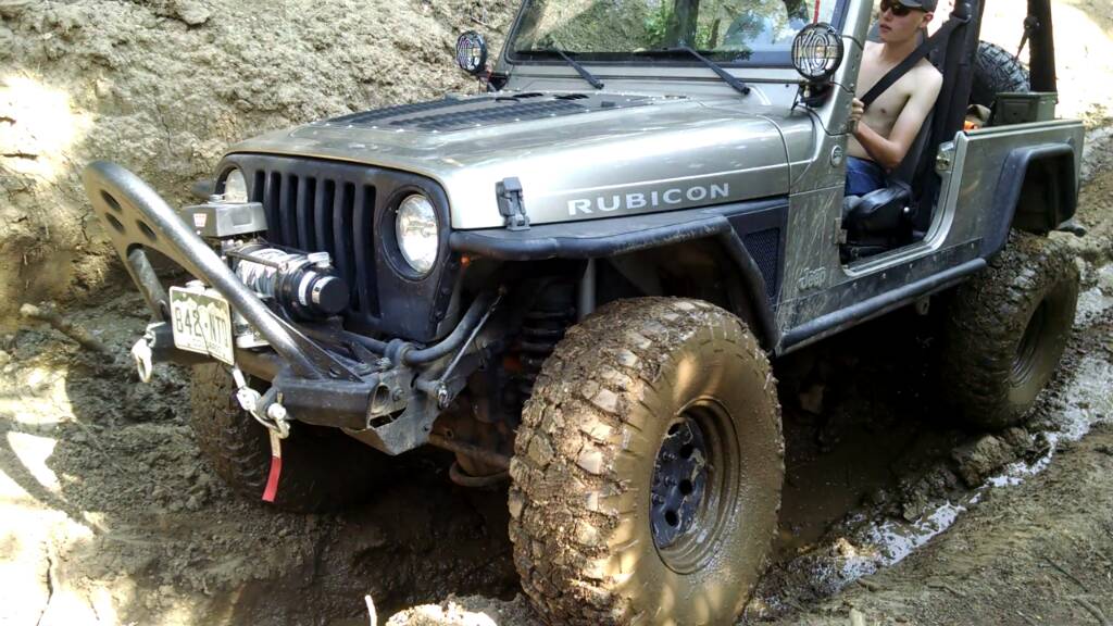

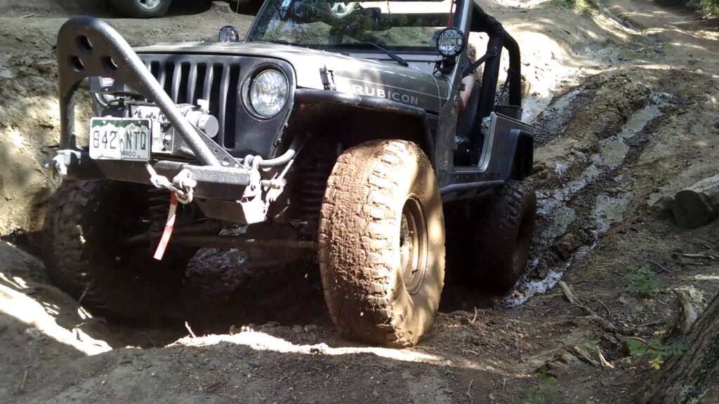

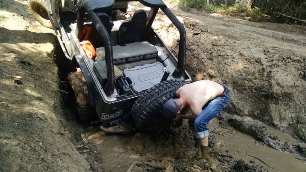

Day one was a quick little trip up to the Nederland Area and to do Gordon Gulch again because I have started using this trail as a good base measurement of the ExpoT4R's build capabilities in which I failed to take many pictures of. But i did get pictures of my friends 05 Lj on 35" Mud Terrains finally finding a obstacle that would stop it dead in its track.
Pic Insert
little back tire lifting .
What had happened is due to the amount of lift on the Jeep he has a 8" drop hitch to be able to tow a trailer... He left it on for the trip thinking that it's an easy enough trail he wont be hitting it on ant rocks. Well turns out the climb out of the mud hole was at such a steep grade that after winching up his from tires up even the Lj didn't have enough clearance to clear the top of the hill so as he was trying to back up out of the obstacle. Bang!!! he hear his hitch smack a rock under the rock, and its not planning on going anywhere soon. Luckily I brought my trusting LifeLine recovery shovel.
Let the Digging commence

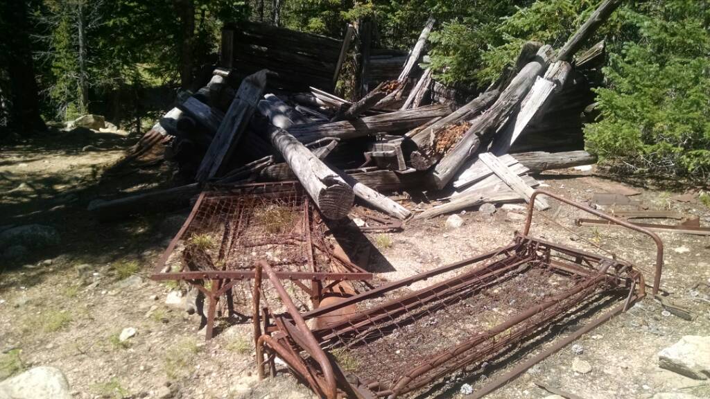

Old mining equipment is scattered around the area on most trail.
Looks to be a old wood shove for the cabin.

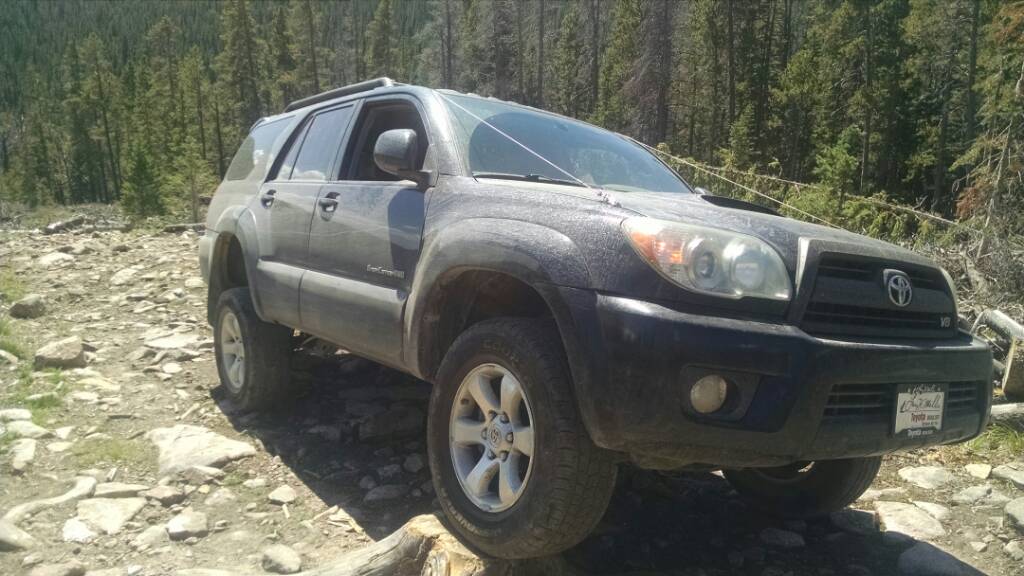

Poser shots of course
[​IMG]
Note: don't be like me the information is correct this trail can be a bit tight for a full-size vehicle like ExpoT4R. A tree was a little close for comfort while climbing a rock ledge, rolled back, and dent the bumper (easy fix) but also broke the taillight. Should be getting the new one in Tuesday ( Fedex may shine through), will be posting about the change and doing a small update then.

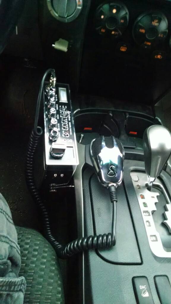

Got my order from Cbi off road on Friday (9/4/15) afternoon and due to it becoming alter and a little to windy to paint I decided to tackle the CB radio in the mean time.
A cobra 29ltd chrome fullsize CB was in store and installed with in a couple of hours.

Then of course taking highways all the way down was too much pavement for me. So my dad and i decided to see how far we can make it back on dirt. We took a connection road to rampart range road to took that as far as possible. Of course stopping on one of the many 4x4 roads down in the area.
A little wheel lift action but nothing to difficult.
