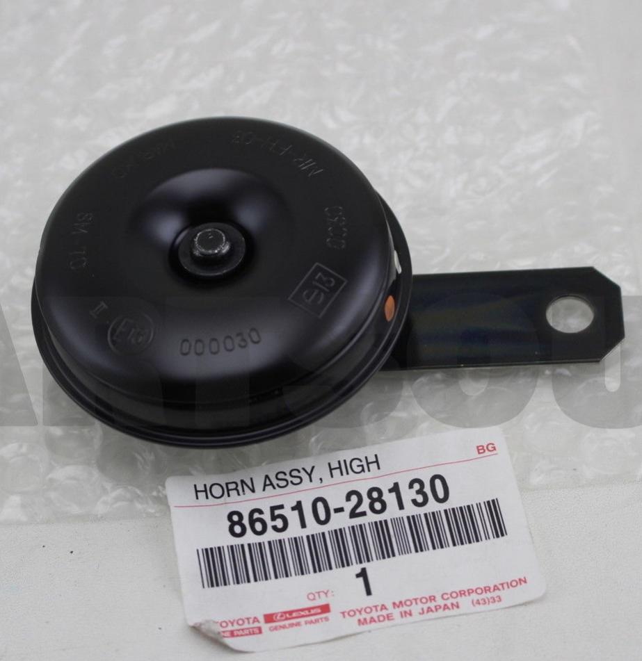

I did a part lookup on the 2010's and for some reason Toyota had two versions depending on what edition the T4R was. Just note the T4R comes with two identical looking horns (high tone and low tone) but I'm only listing one for comparison between editions of T4R.
I'm guessing you have the round version?
The wimpy horn is the round one below..

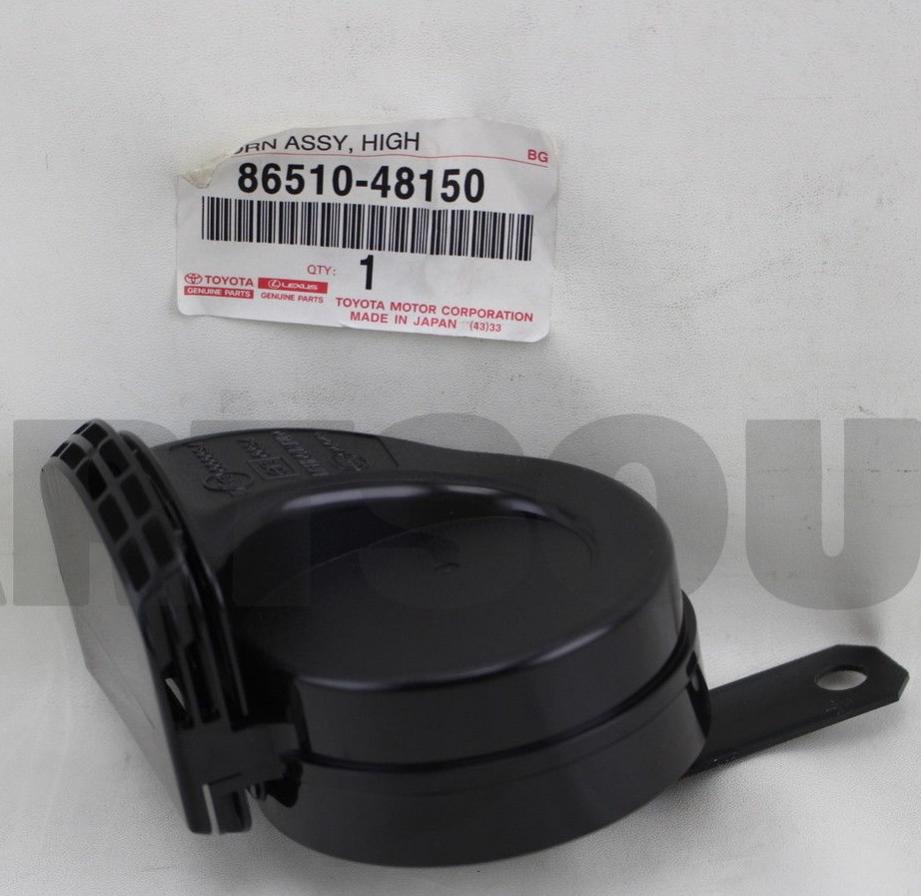

There is also a Limited edition version of the horn as well for the 2010, shown below. Looking up the 2018 T4R, it uses the same limited edition version of the horn, same part number. I think the 5th gens have an option of the round basic horn or the plastic premium horn.
Wondering what the differences are between the 4th gen horn and the 5th gen premium horns...i see they changed the design of the plastic cap that goes underneath between 4th and 5th. Wonder if that muffles it more or redirects...

The horn on my 4th gen sounds tough and is loud. I feel like its louder after I removed the covers on the bottom.
Have the same ones and love them. Wondering if the 5th are better or just a slight revision of the covers? Wonder if the covers come off on the 5th...maybe too many people were taking them off and Toyota got in trouble LOL
I'm definitely going to take them off and give that a try...

I checked the parts listing for the 4th gen, and there's only the option regardless of trim to have premium horns. 5th gen had two options which was dependent on trim level. The regular round metal ones or the premium plastic ones.
So for those who have 5th gen with the regular round horns, you can simply upgrade them to the premium ones. The connectors are the same between the two. Simple swap.
