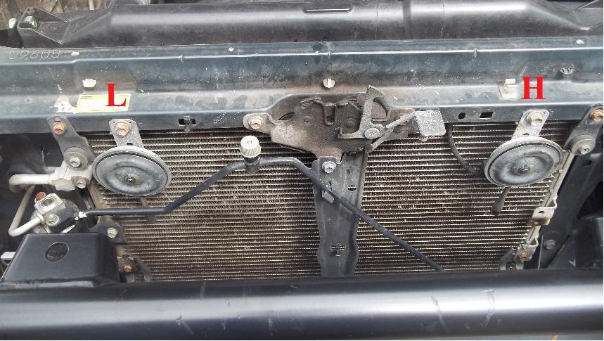

I'm not sure which 4th gen horn is the high tone or low tone so does it matter which side I mount them? I'm thinking it wont but just double checking.
All questions were answered this morning when I installed them.

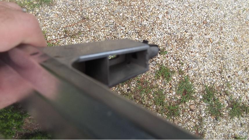

I took a pic of where to push your grill clips downward for easy removal (ppl seem to have trouble with these clips) It's not a great pic but hopefully you get the idea.
3rd gen horns Labeled with (L) low and (H) high

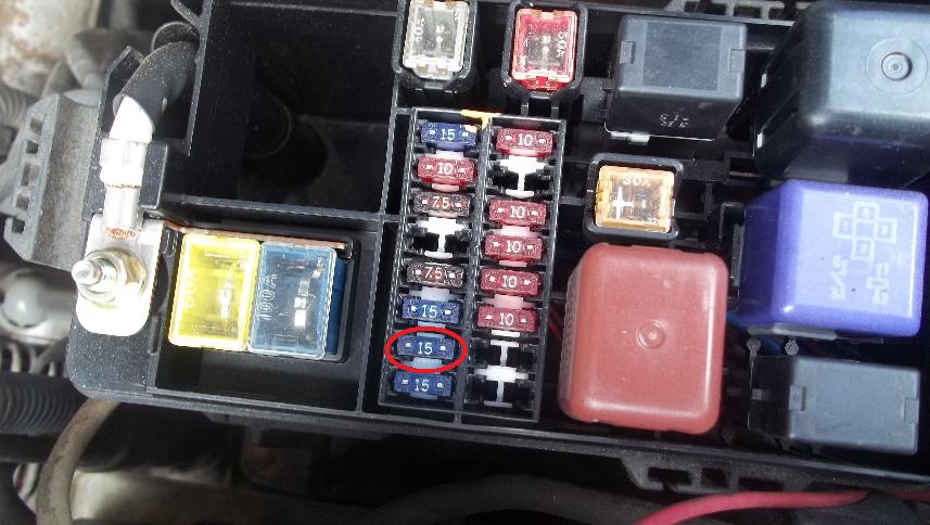

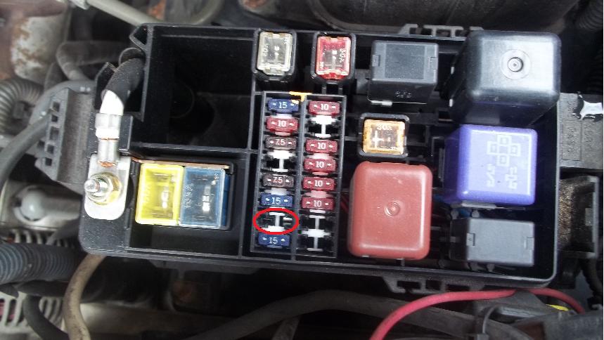

Remove horn fuse.

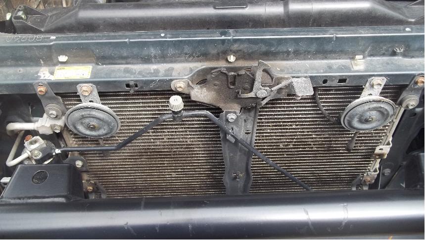

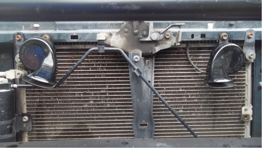

Pic of old horns in place.

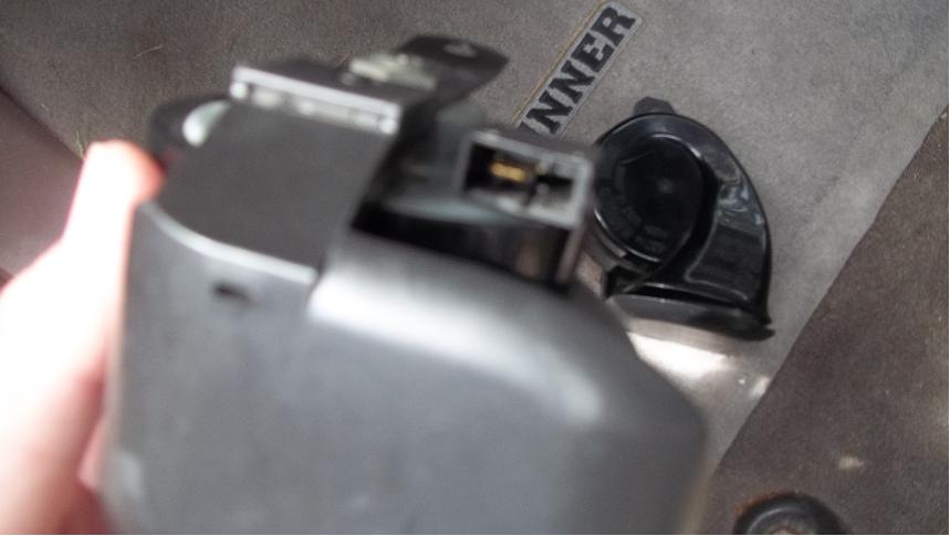

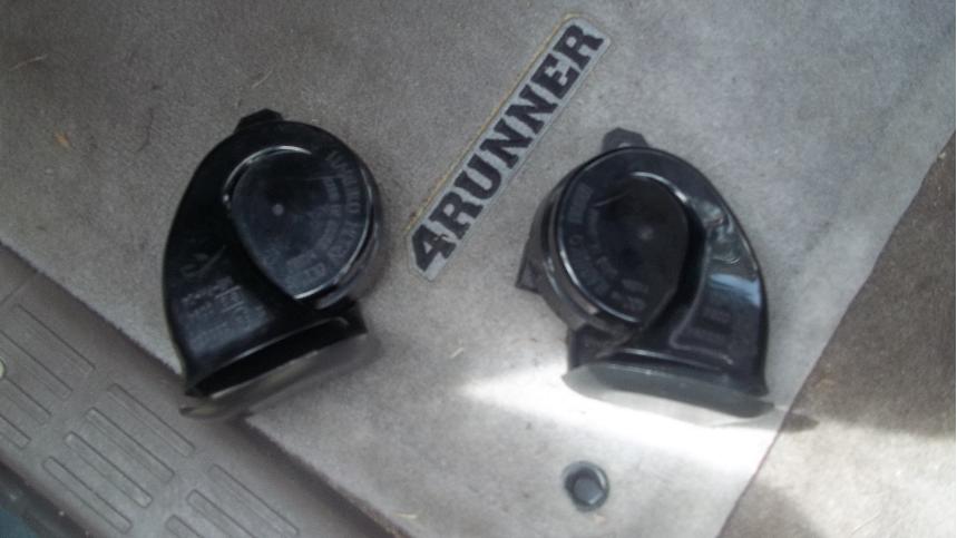

Here are the 4th gen horns
and the plug that accepts the 3rd gen connector

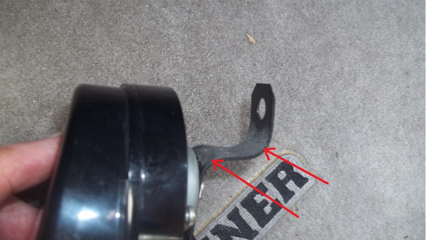

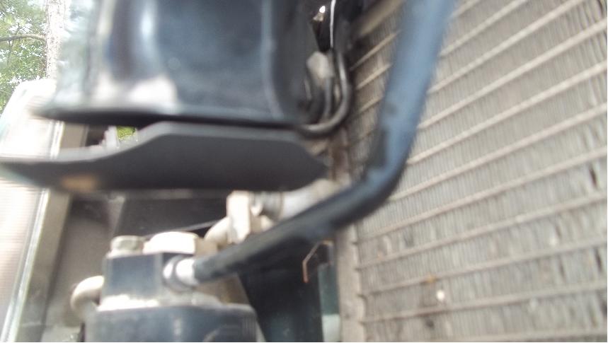

Low frequency horn bracket modded to miss AC line.

Here is the gap created by bending the bracket.
Horns mounted
