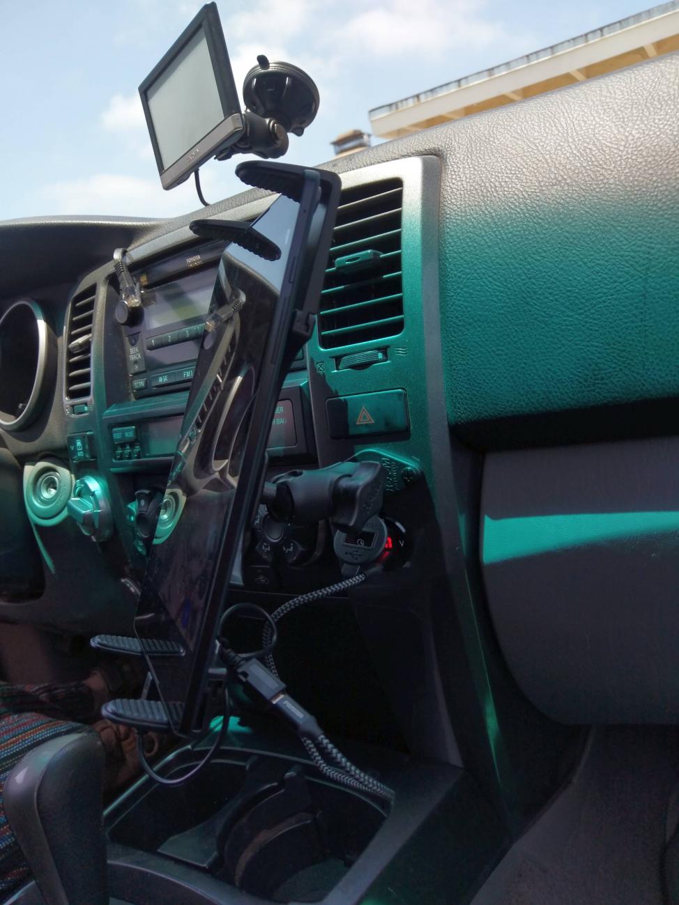

I previously posted a few pictures of a recent mount that I installed in my dash for an iPad or a Tablet and received some inquiries on how I did it. So, here's how I did it:
Mounts
RAM base plate adapter-
Amazon.com: RAM Ball Adapter with AMPS Plate: Electronics
2 of these
RAM double socket arm-
Amazon.com: RAM Double Socket Arm: Automotive
RAM X-grip-
Amazon.com: RAM X-Grip Universal Holder for 9"-10" Tablets: Automotive
Go to the RAM website and it will help you figure out what iPad/tablet mount you will want. I picked this one and it works for me, but there are cheaper options that will still have the same function.

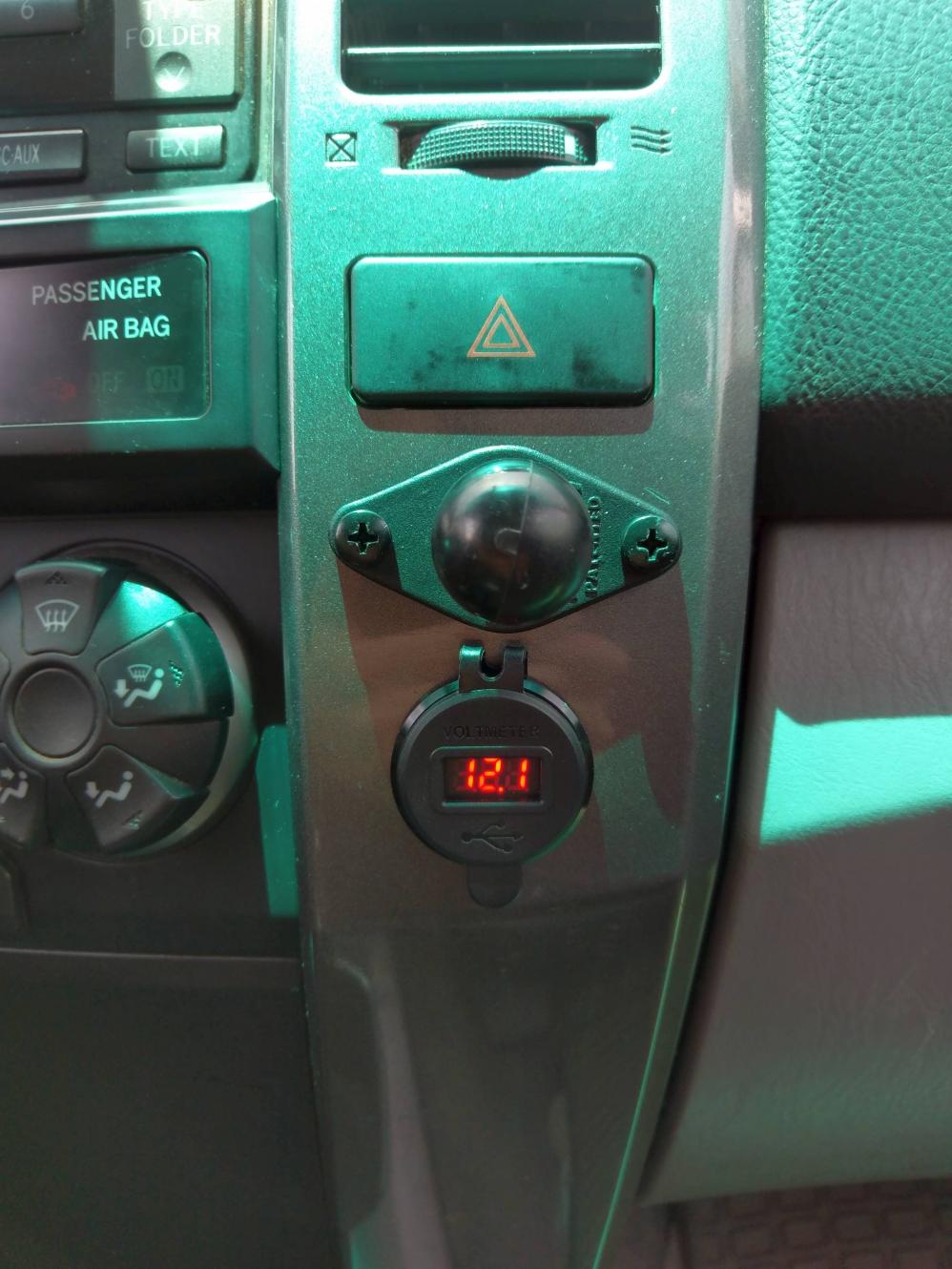

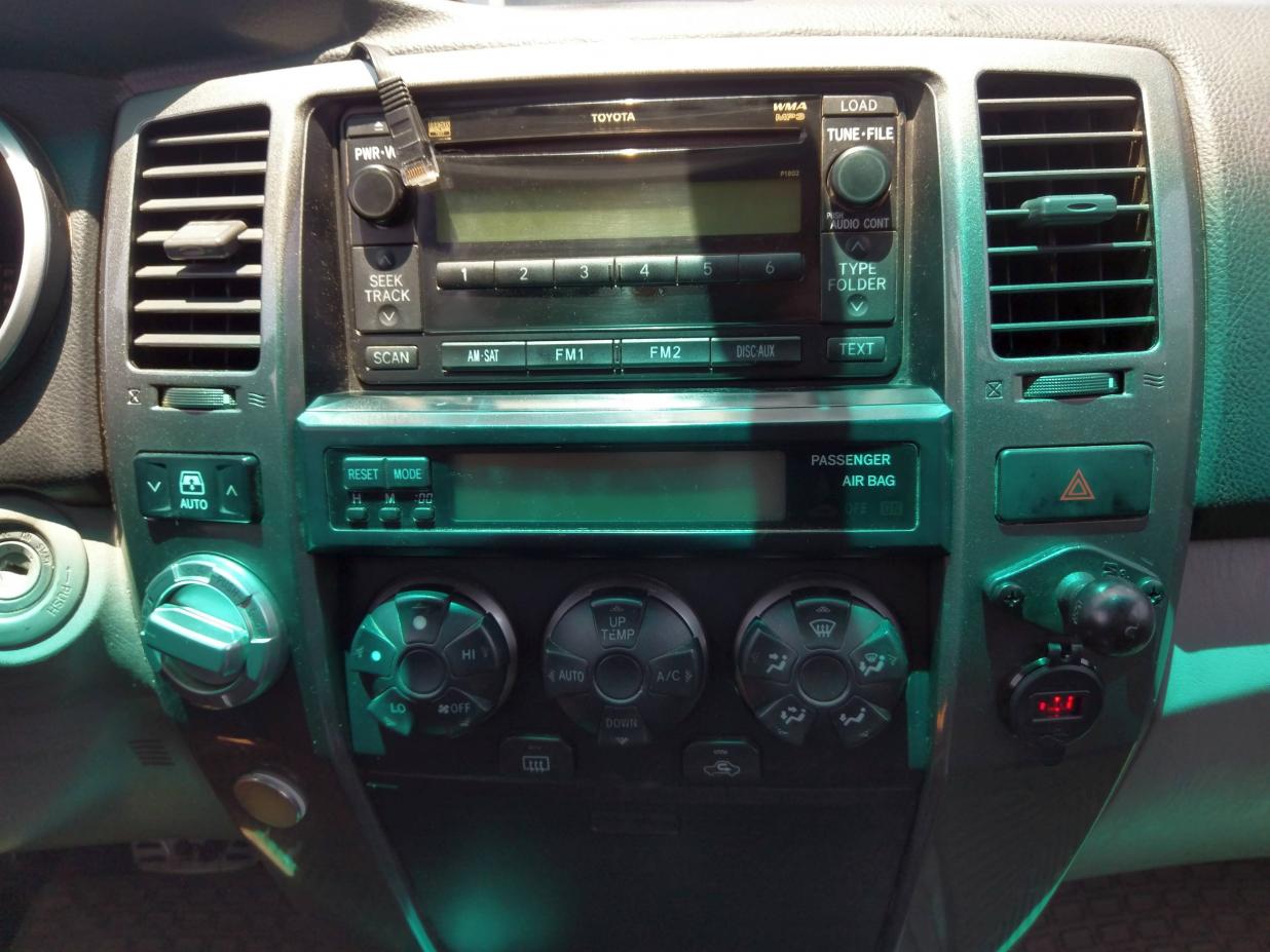

2. Line up your base plate adapter just under the hazard lights. I used a punch pin on one hole, drilled that one out, then bolted it to the dash. Then, I continued doing them one hole at a time until all 4 were done, while attempting to keep the base plate as straight as possible.
Here is what I used:
#10-32 x 3/4in Round Head Combo Machine Screws
#10-32 Stainless Nylon Lock Nuts
2 washers that fit (lol)
You have limited room on what backing you can use here, so I did two larger washers and two smaller washers. My buddy used a rectangular piece of steel for the backing, use whatever you can with the limited room. Obviously the stronger the backing, the better chances you have of how sturdy this is while driving on bumpy roads/trails.
3. Put it all back together, you're done.

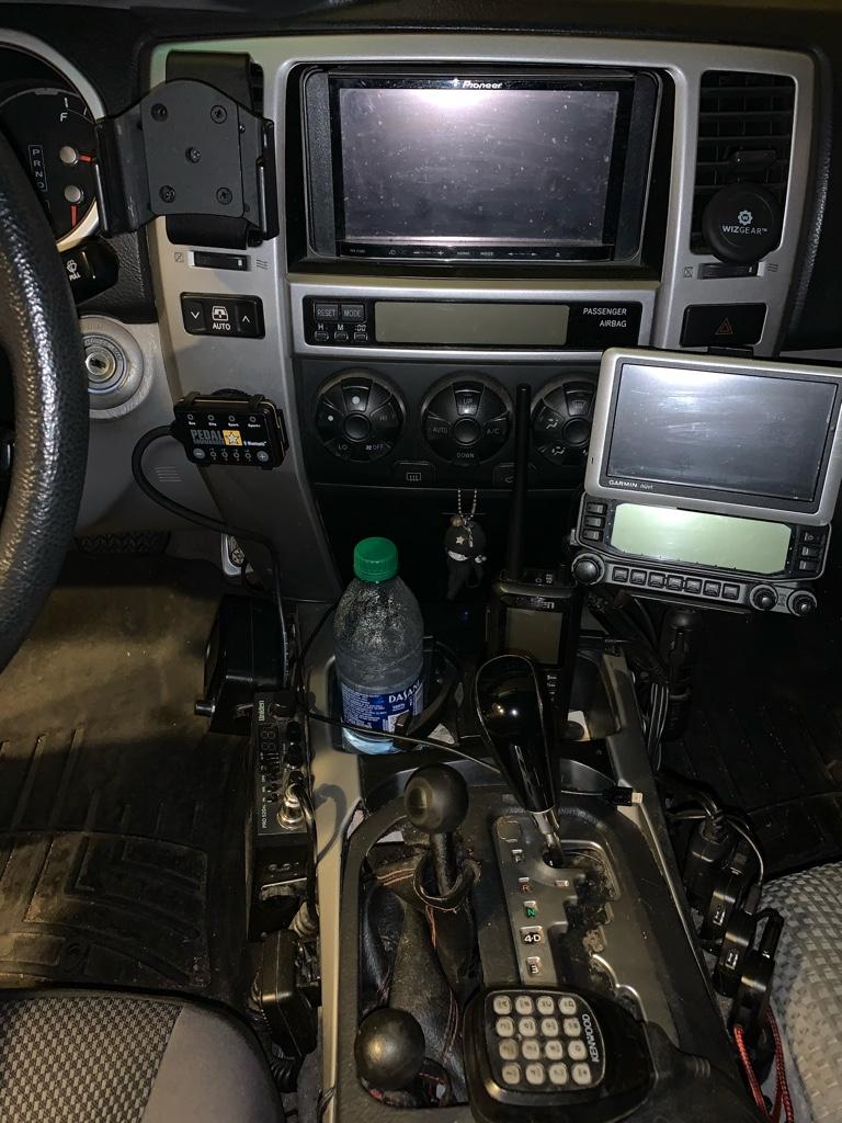

I have a RAM mount on the lower part of my center console for my ham radio setup and it handles everything its been through from high speeds in Pismo dunes to crawling the waterfalls up Big Bear.

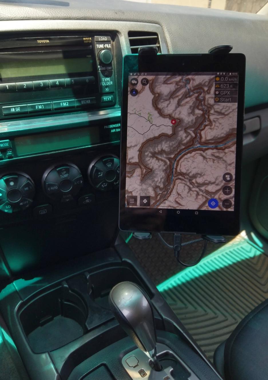

Update on durability:
I have not driven off-road with it yet, but I did drive 2hrs 45mins to the other part of Florida today and back. 0 noticeable issues, one part around town had a road that was probably 1.5 miles and was bumpy as hell.
No complaints thus far. We are going on a trip to GA in two weeks, will update with the strength of this mount after that trip.

I don't recommend the floor seat RAM mount, I currently have it set up to hold the head unit of the ID-5100a. It wobbles far too much and the only solution would be using a bracket to secure it to the center console but we'd be back to square one with drilling. If I were to do all over again, I would have just directly mounted a different RAM mount to the console.

RAM mount and charge port
This thread reminded me that I have been wanting to add a RAM mount to that location for a while. I also added a double USB port with a volt meter to charge the tablet without running long cables. I first saw that design by [MENTION=63060]rickashay[/MENTION]
https://www.toyota-4runner.org/2590276-post16.html
There is no need to disassemble the whole dash. After taking out the HVAC controls you can drill the holes and put the screws in with the large cover piece in place. Much easier. I put a metal plate on the back to re-enforce the plastic a bit. Rock solid.
This is the charger I used:
https://www.amazon.com/gp/product/B07DGNQNLR/
