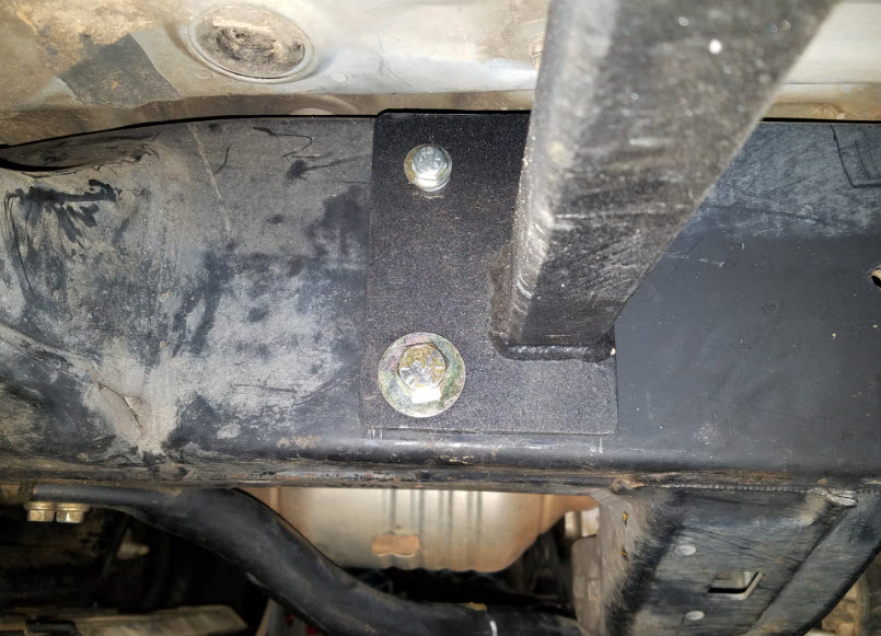

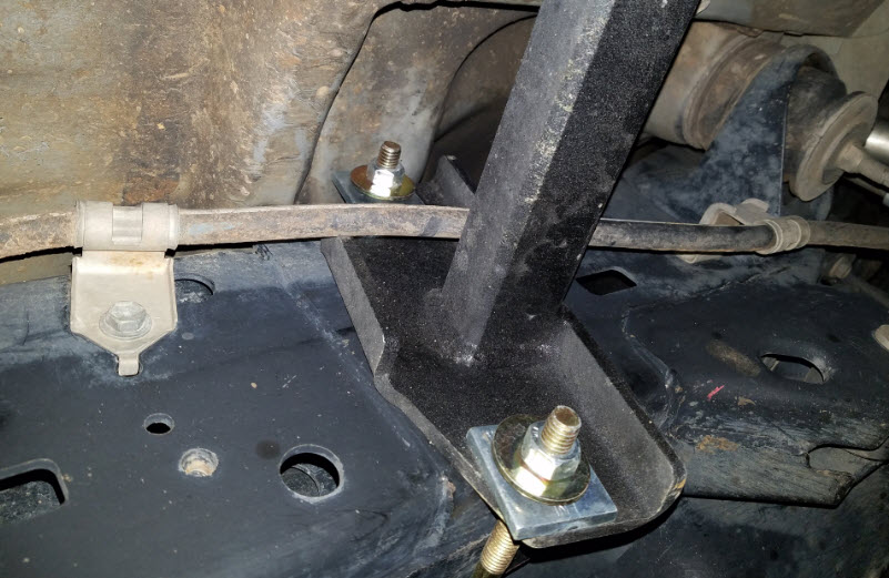

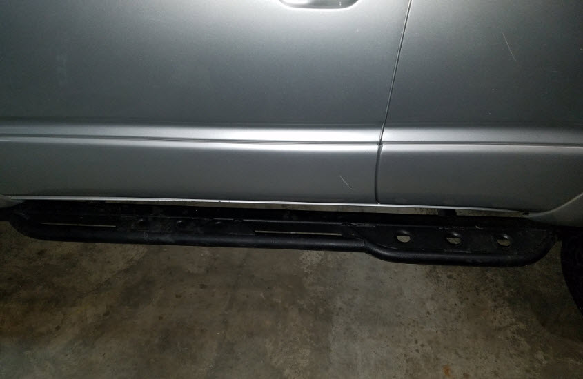

Finally had a day to finish the slider install.

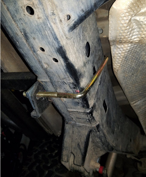

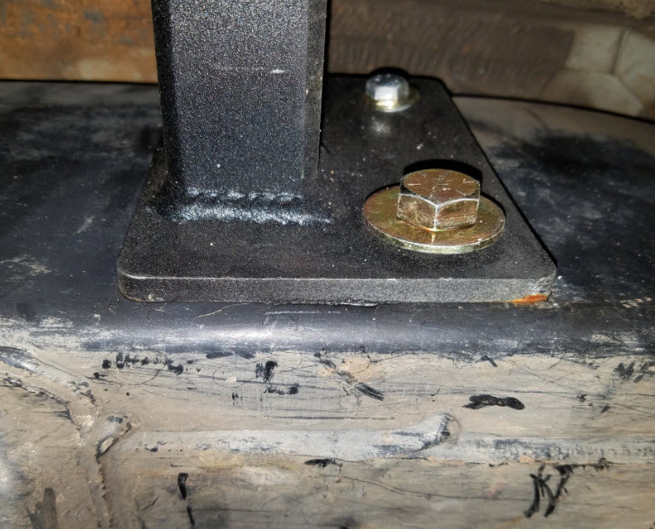

Ended up drilling all the way through the frame on the front and used the U bolts on the rear. They seem to work. I went looking for a place to test them. But only ended up getting wet.
Overall i am happy with them. I just think they need a little bit more design to them.

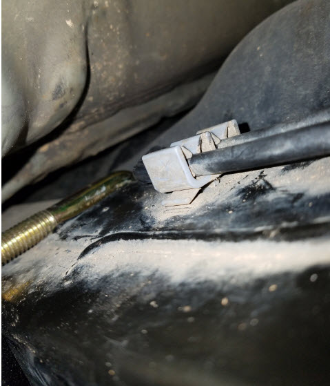

The driver side has fuel lines that you have to watch out for when putting the U bolt into place.

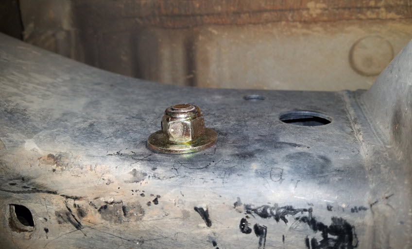

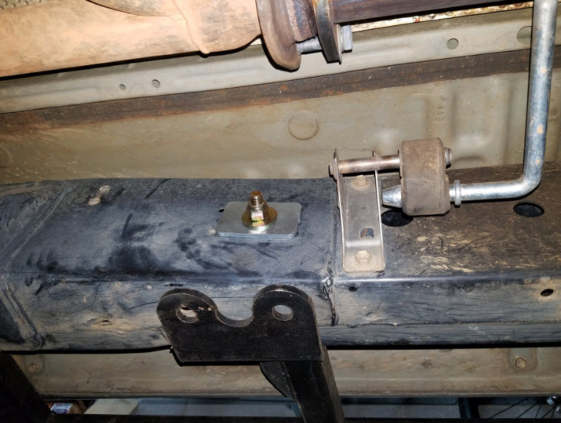

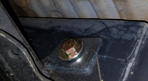

Here are more pics of the bolts I added. No rivet nuts were used.

I have installed mine just fine using the rivnuts/nutcerts. For people who have never used a rivnuts before I suggest buying a few extra and practicing with them. It takes a couple times working with them to fully understand and get a feel for working with them. Biggest mistake I see people make is drilling the hole in the frame too large and then the rivnut/nutcert not grabbing and just spinning around. You want that rivnut to barely fit in the hole. Having to gently tap the rivnut into the hole is ideal for best fit. I have dropped my rig down on mine, lifted it by them, done everything imaginable to them and I weight more than most here 5500+ lbs never had a single issue with them loosening or moving around.
The issue I see with doing through bolts only is that the outside of the frame rails is actually thicker than the inside, so there is more strength on the outside. By going to the inside to hold all the weight, and not using a big enough plate to support or spread out the load you run the risk of bending the frame and or pulling a bolt/nut into the frame denting it with a big enough hit -i highly doubtful you would pull through the frame but definitely bend and weaken the frame at that spot. There is a reason MetalTech supplies that small steel plate for that through bolt. A washer simply is not strong enough to spread that load out, especially if everything is completely through the frame.
Sent from my XT1585 using Tapatalk
Another concern with using through bolts is that the frame may get squeezed (deformation)if not a larger plate is used in leu of washers. Typically, when one drills through a frame, a round sleeve is welded through the hole. This way, the bolt goes through the sleeve and then you can tighten the shit out of the nut/bolt. This will not squeeze the frame but rather, squeeze the sleeve, which is fine. No frame deformation is achieved if using this method.

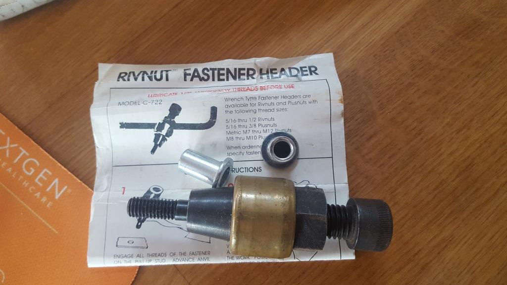

Not trolling, just spewing some facts. Yeah, done my share of rivnuts installs - steering boxes, sliders, link mounts, etc. Below is the rivnut tool I typically use along with two 3/8" rivnuts. I caught up to a local buddy with a GX yesterday who also has the MT sliders and saw what you were talking about. He didn't install the rivnuts either but he is also not a rock slammer.
It's all good, meant no disrespect or condescension. But, as always people take sage advice however way they see fit.
