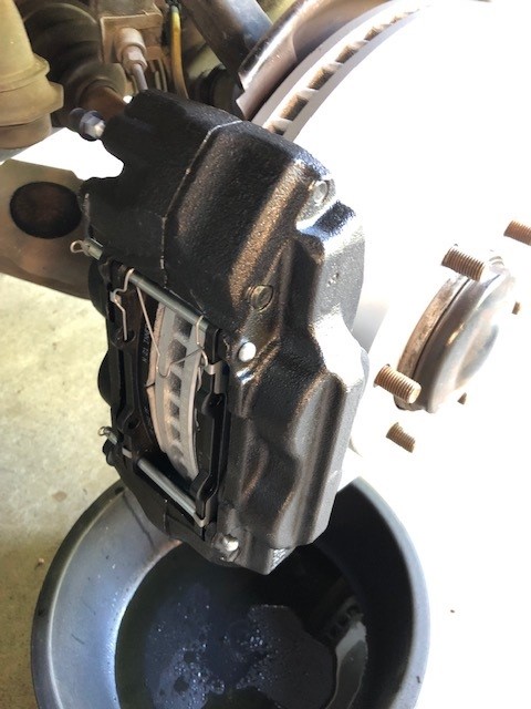

Thanks for all the great info here - was in a jam and had to make a fast decision, so ended up going Napa (liked the lifetime parts warranty). Specifically went with the coated (black) Adaptive One calipers and Adaptive One pads. Also went with the Napa Ultra Premium coated rotors. The only issue was that my year (2007 LTD) has 2 different rotor sizes? (12.5 and 13.25), something to be aware of. Mine was the 13.25. Maybe the rears are smaller, that would make more sense. $400 after core including a gallon of brake fluid. Only a few hundred miles in but so far so good!
