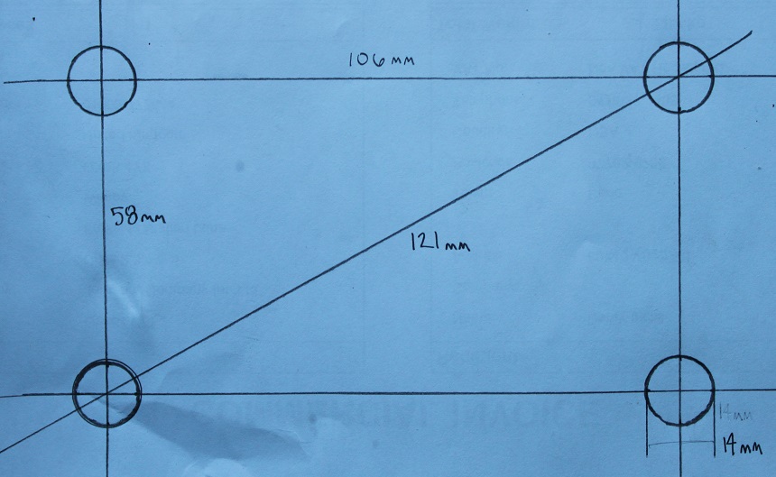

Anyone have measurements/CAD File for the rear frame rails of the 4th gens? Mainly looking for dimensions and bolt hole locations for the trailer hitch. Any help would be appreciated. :)

I'd appreciate it if you could. Mainly looking for the measurements of the holes where they're located on the rear frame in relation to the end and distance between them. I think instead of going with a "C-Rail" style attachment like I originally was thinking I may go with a more traditional mounting method like the trailer hitch and make L-shaped brackets for the tire carrier.
It's just a royal pain to pull all the rear bumper paneling and trailer hitch to get the numbers these days, so if someone has they laying about that'd be great! I have the measurements for the frame in the back from a while back if I remember right, but I neglected to take the trailer hitch mount bolts into account.

That'll help some, but they don't dimension a lot of the frame exactly (i.e. the multi-angled section in the back and the bolt holes) as that's mainly for a body shop to check the frame for straightness and such. But I appreciate you digging those up, they're out of the body repair guide which I have access to on TIS. :)

There are 2 bolt holes in the bottom of the frame rail I didn't measure, but can.
I am getting 20 5/8" for the outside frame rail to outside bolt hole (center of hole), both sides.
Pic for the receiver bolt holes.
