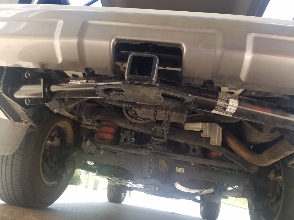

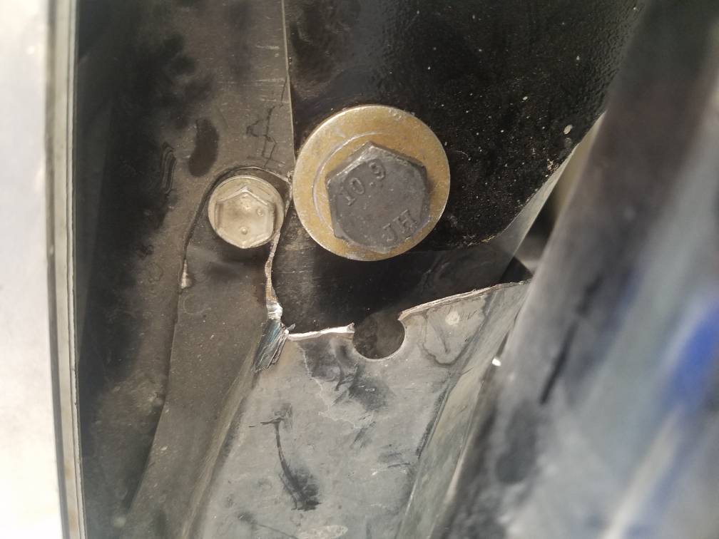

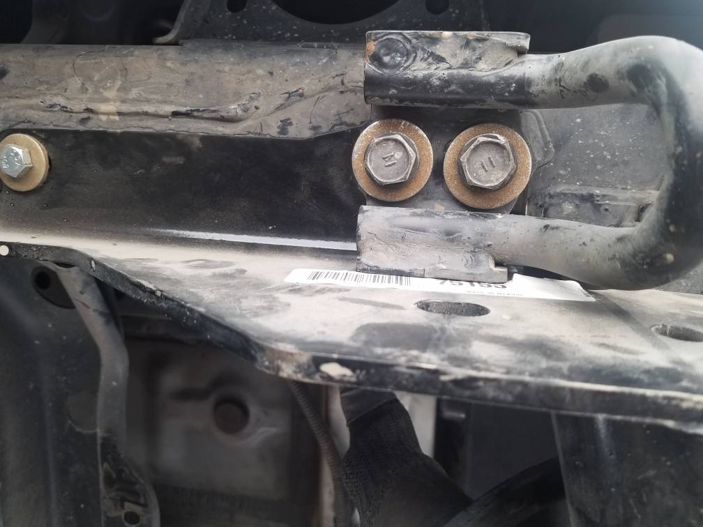

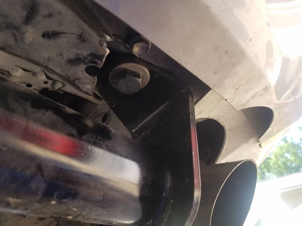

So, a draw-tite 75155 for a 4th gen will mount to a 5th gen. I have a 2015 TE premium and it mounted with minimal mod. I had to trim one spot on the passenger side bumper facia bracket. Took 2 minutes with a grinder. The only hiccup I have is relocating the factory 7 round/flat 4 connectors. The wires are too short and the bracket doesn't fit the new mount location. I plan to research an aftermarket one. Clip the factory wires of the stock one and solder them to the aftermarket one. I will add pics when it's done. I got interrupted because my 1 year old woke up from his nap.
