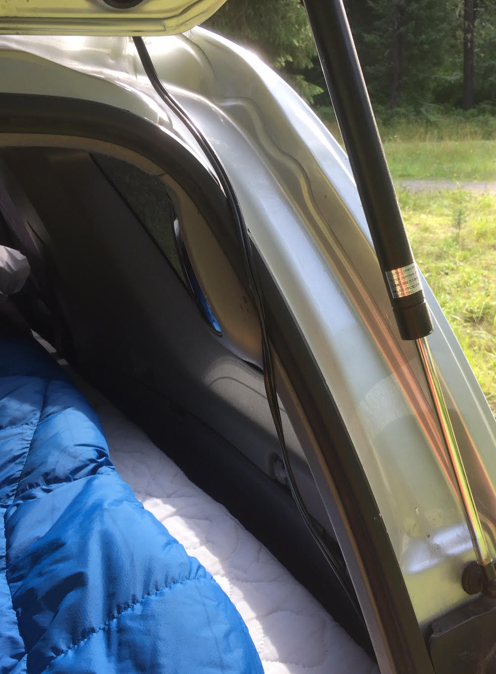

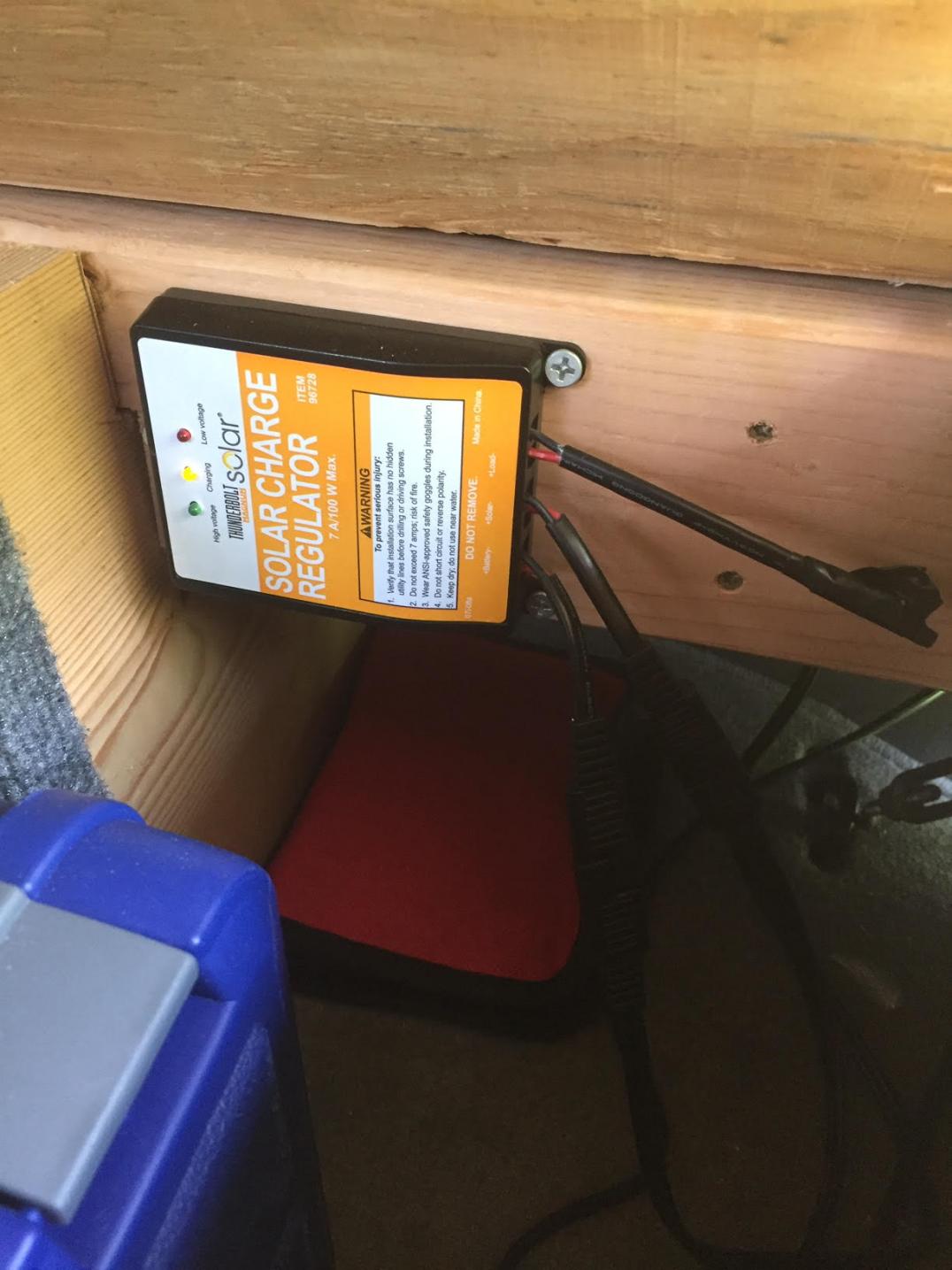

So here is what I discovered at Harbor Freight. A $64 dollar 25 watt simple solar panel with a $20 solar regulator that works under partial sun and stores nicely for transport. I just returned from a week of camping and had the piece of mind. Unit setup quickly and cord provided was long enough to reach the cargo area regulator and plug into the 12 volt socket.

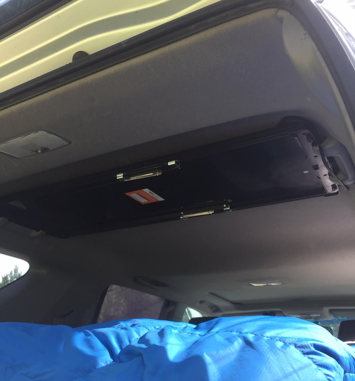

OMG, (miracles upon miracles) the panel fits (glass side up against the headliner between the double clothes hooks in the cargo area! Its a nice tight fit and stays up without any additional straps, no worries. But to fit the panel has to go glass-side up, which is what I wanted anyway.

Not exactly sure which 4Runner years or models have the double hooks, maybe it’s the Sport models.
The panel is held tight against the headliner and you need to work it in from the front to aft alternating both ends until it’s centered between the hooks.

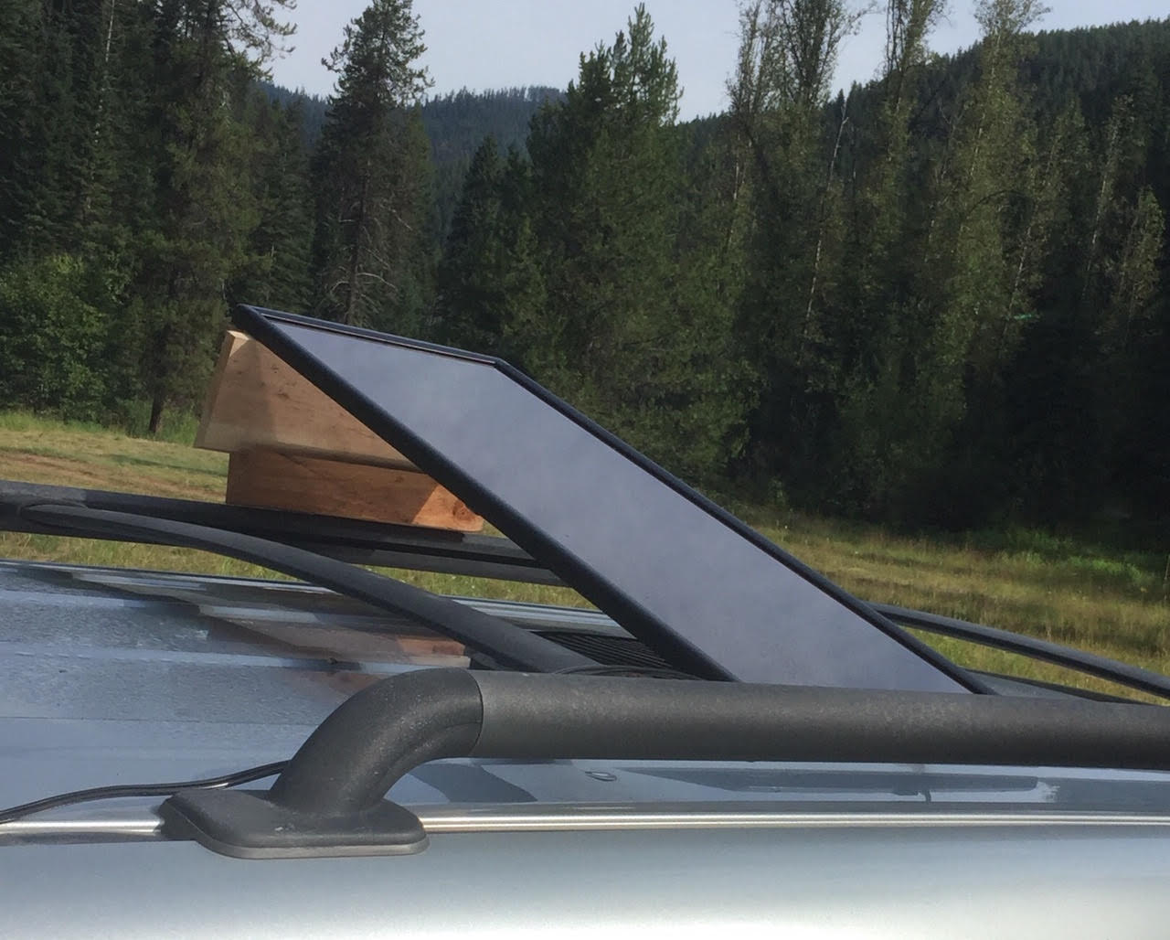

The legs that fold down rattle when traveling down rough roads-I will likely take the bracket off because I don’t think I would ever set it up vertically. I believe the bracket would only make sense if you had four of these to make 100 Watts-all connected together.
