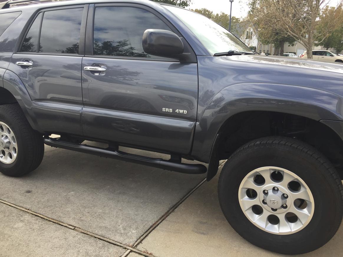

I used rustoleum primer and bedliner spray to refinish a set set of sports tubes.
I removed the end caps and steps. Then I scrubbed them down with degreaser. Let dry. Did some light sanding all over. Wiped them down with a wet rag. Let dry. Did 2 coats of primer and 3 coats of bedliner spray.
