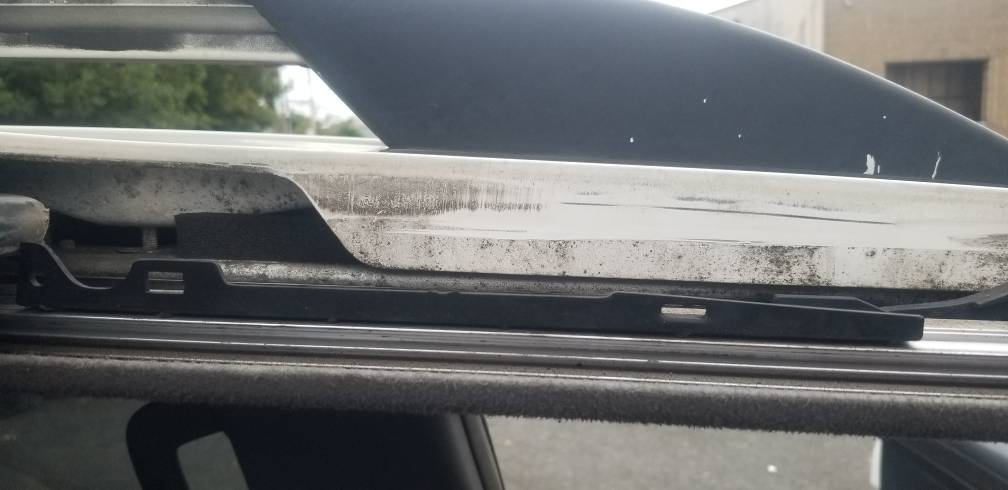

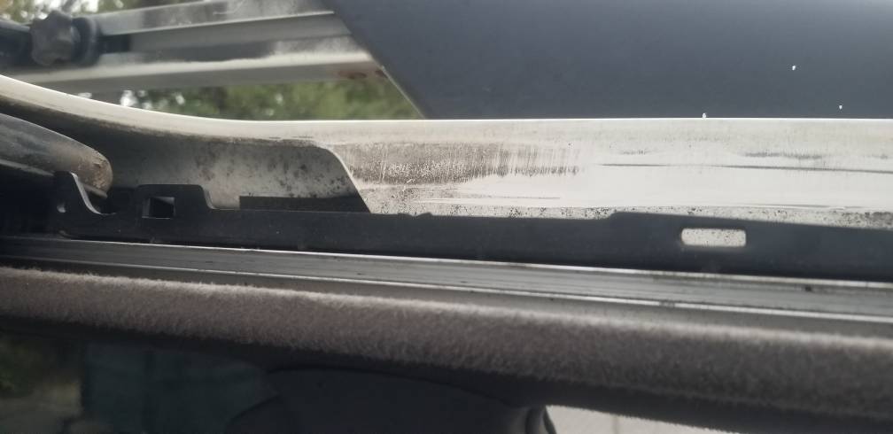

Sunroof is stuck open
Looks like the driver side track is broken
Motor still works
I tried the 15 second tilt with no luck
I also removed the motor and tried to manually pull it closed with no luck
Edit: update
Put the motor back in and for the love of god she closed
I disconnected the motor cable as to never open again....

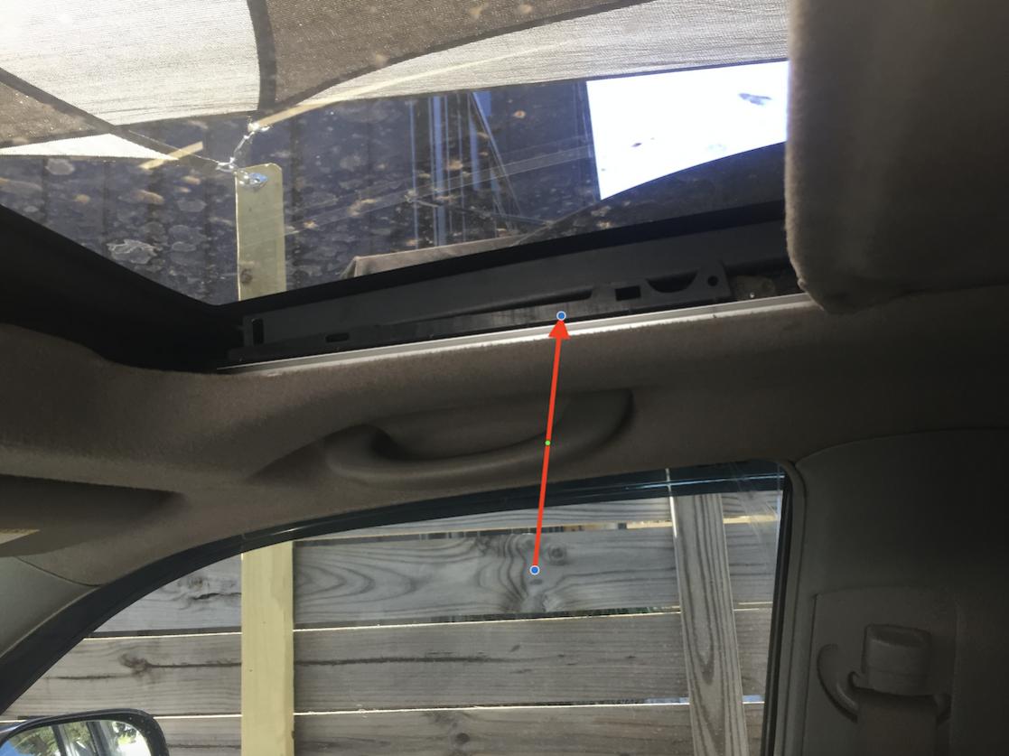

Hello Ashan. Thanks for the awesome how-to post. Can you tell me what this sliding member within the sunroof rail assembly is for? I've attached a pic of it with an arrow pointing to it. Thanks!
