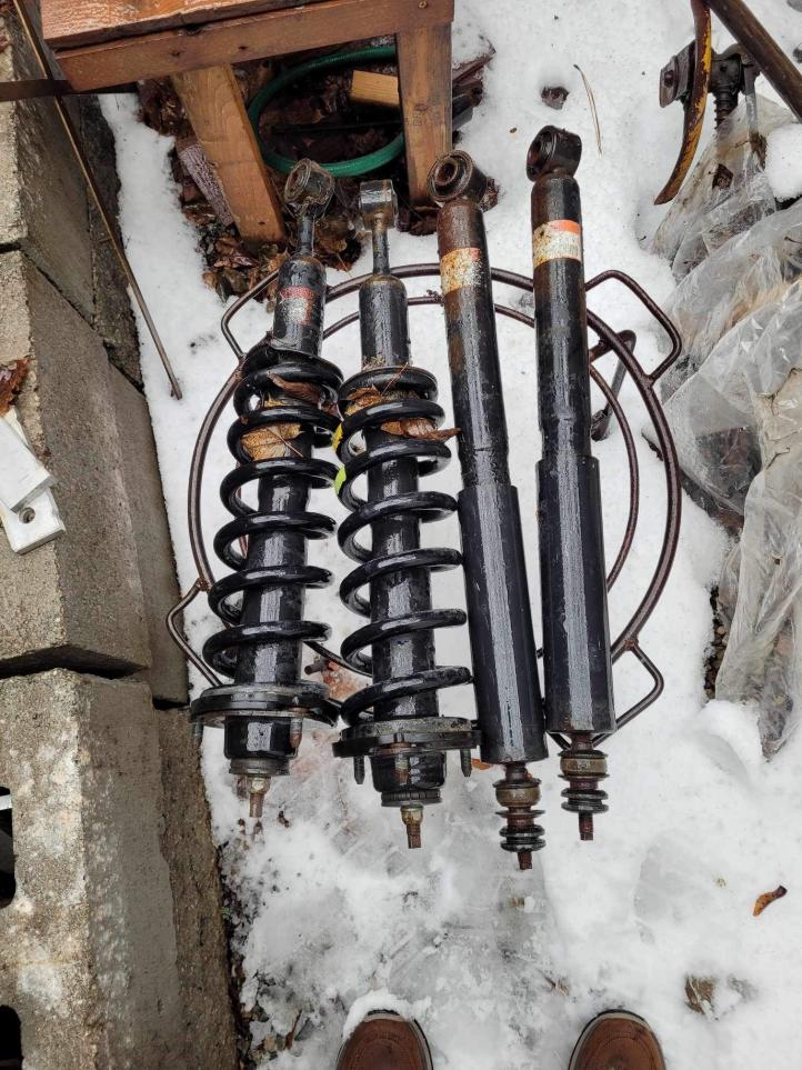

4Runner to FJ swap question
Hey, everyone, I found a good deal on what appears to be most of the suspension parts from a 2007 FJ but the description is a little vague so I want to make sure it will all work on my 4Runner (2005 Limited V8 with X-REAS). They already sold the rear coil springs but everything else looks OK and the seller calls the parts "OEM". Can anyone ID the parts by sight?
