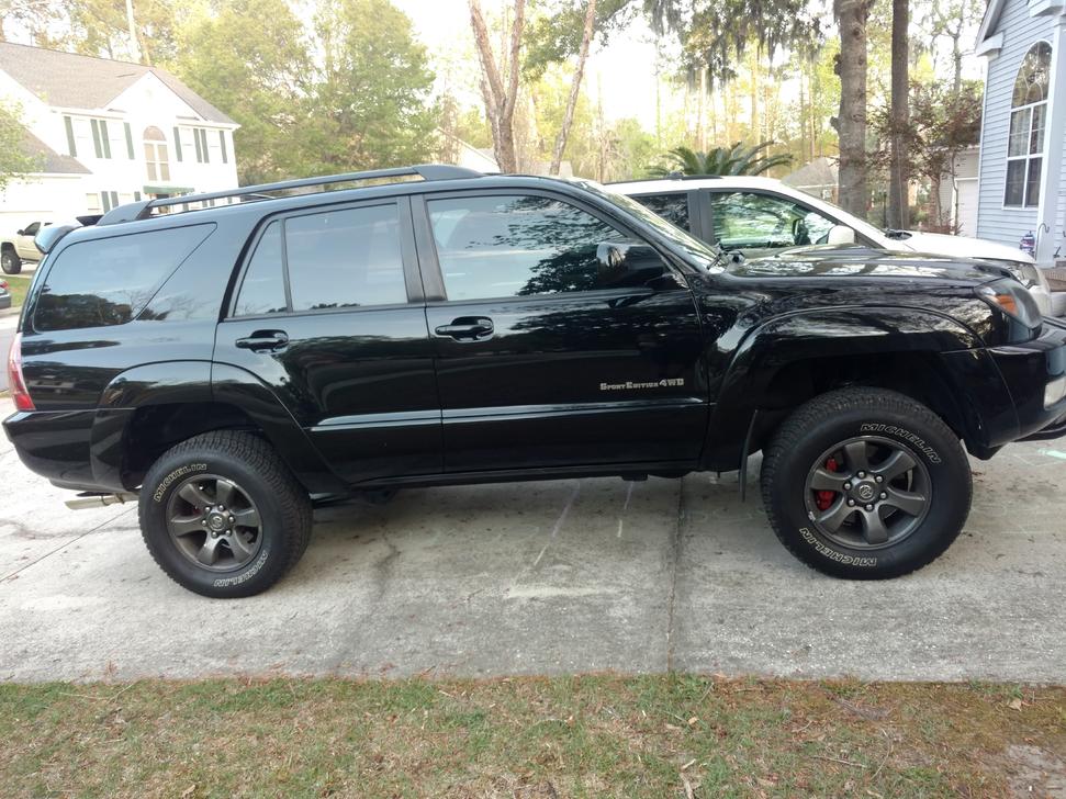

Well I just did this modification to my suspension. just a little different.
I had stock XREAS with 2.5/1.5 spacer lift. I just swapped out Xreas with the bilstein 5100 struts coiled with 5th gen springs set to 2.5 up front and put on rear 5100 shocks. Kept the 1.5 spacer with my springs in the rear. But I do have toytec 2 inch springs ready to go on if I don't like the look/ride in the rear...but everything looks great right now.
I will try to get a picture of my T4R later today for you to see.
The one thing I will say is when it comes to suspension, you get what you pay for. I don't mind the 5100's because that's all I can afford, but the ride isn't great. on a scale of 100 I would probably give it a 50-60. definitely better options out there but I cant afford them. just happy that my XREAS is gone after leaking.

Hey thanks man, I would appreciate a picture whenever you get some time. The budget for sure is a big factor to me, gotta keep the wife happy![emoji16][emoji106]

Here you go hope this helps
