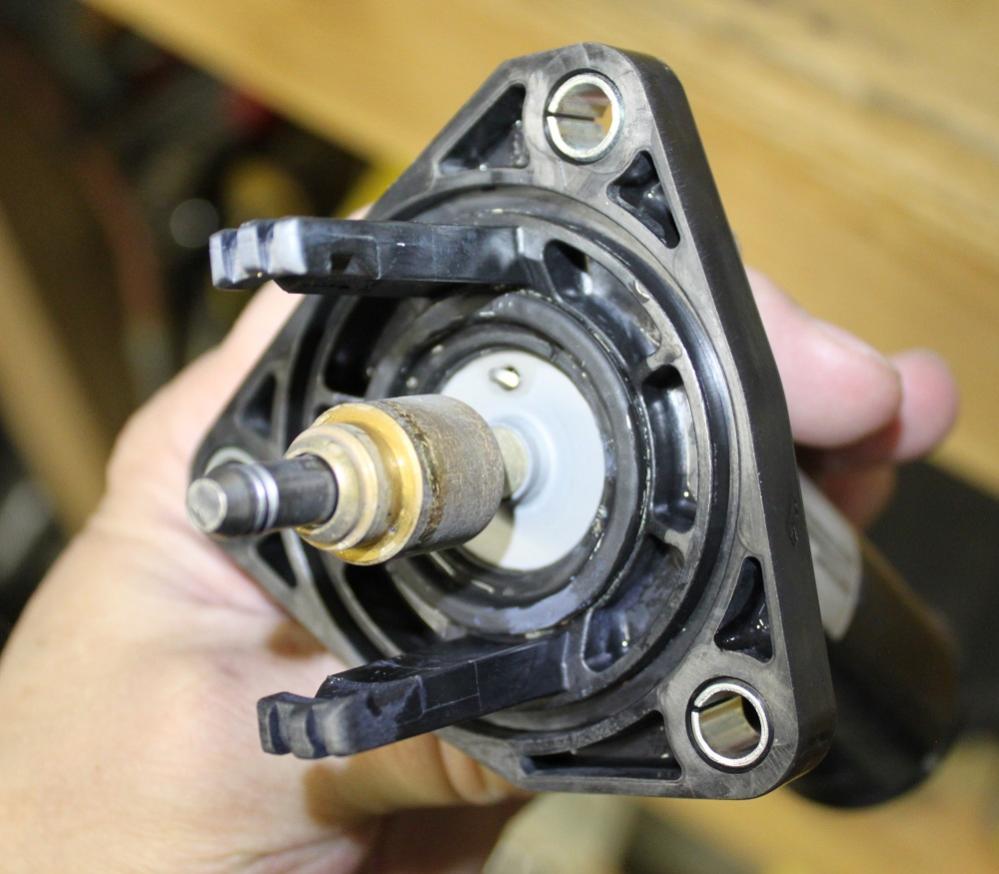

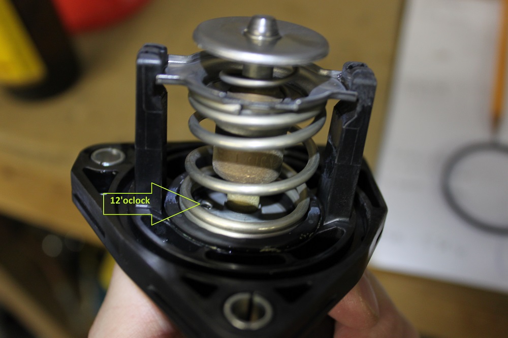

I guess unconsciously i just take pictures of everything anymore.
Answered my own question.
Looks like it is 12 o'clock.

The OEM Stat I removed, the jiggle was at 10 o'clock.
The Stant I installed, the jiggle is at 12 o'clock. :alien:
One of its functions is to bleed air from the cooling system on initial fill so you would want it at 12 o'clock so in highest position to allow air to escape and not 'pocket' above it.
