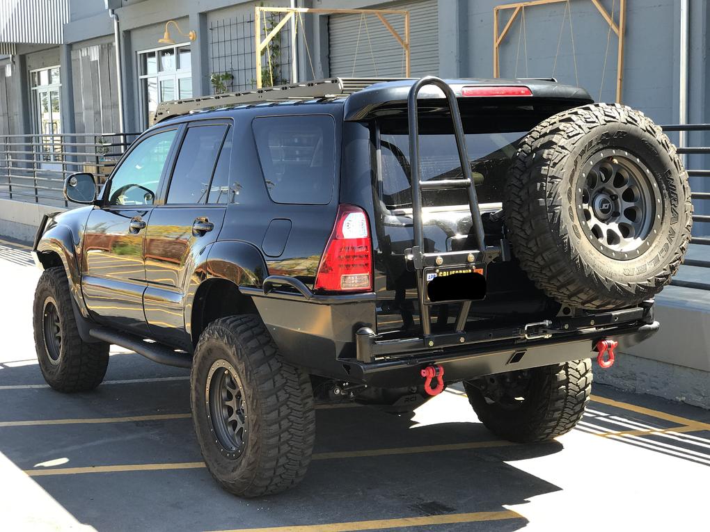

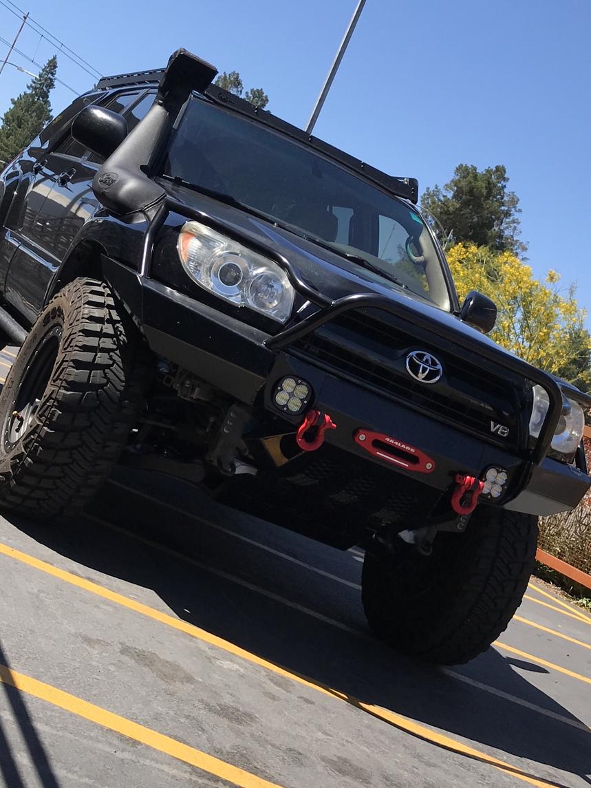

Total Weight with full tank of gas (23 gallons): 5480lbs ***edited
Total Weight with only 3 gallons of gas: 5360lbs
DF: 1420lbs PF: 1370lbs
DR: 1480lbs PR: 1420lbs
With the tank near empty the rear axle has less weight than the front - 2740lbs front and 2620lbs in the rear.
