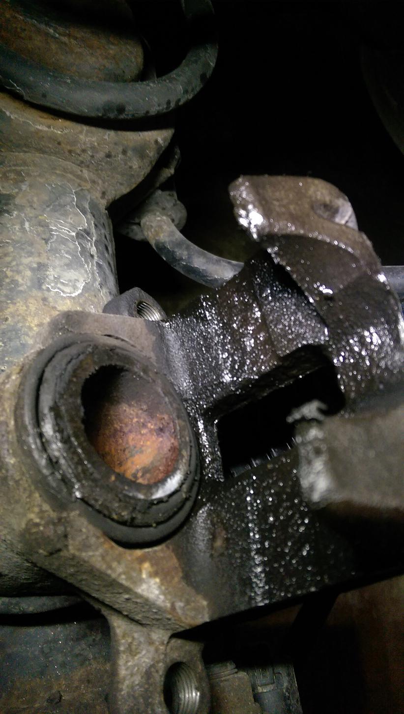

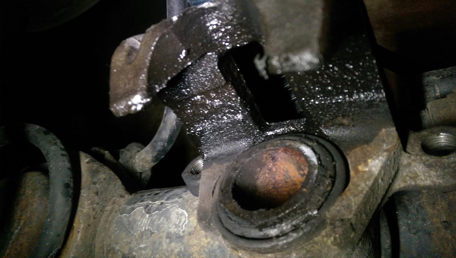

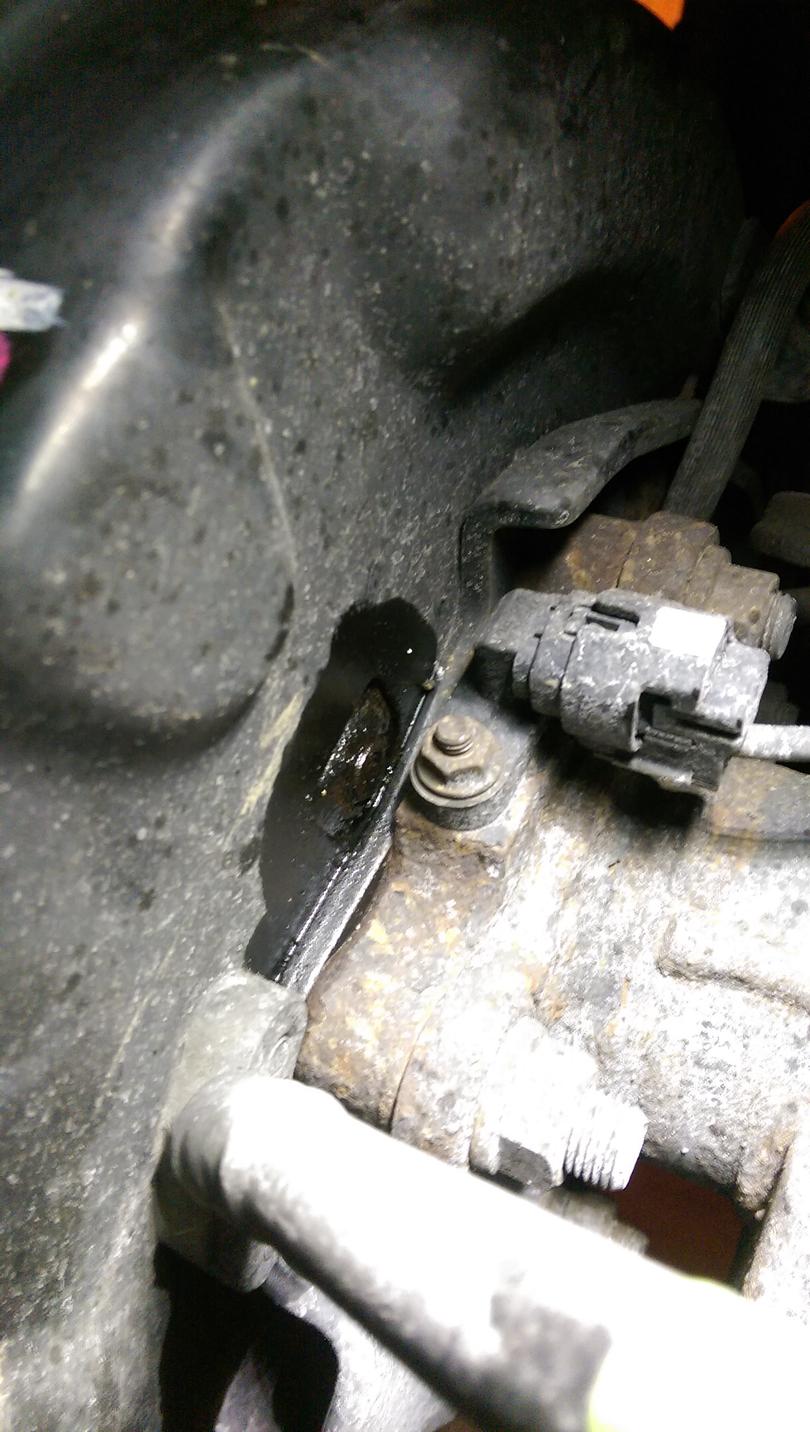

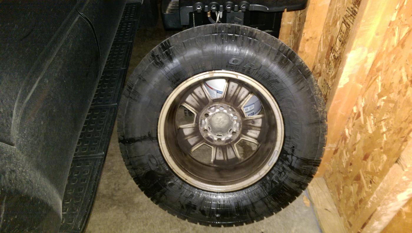

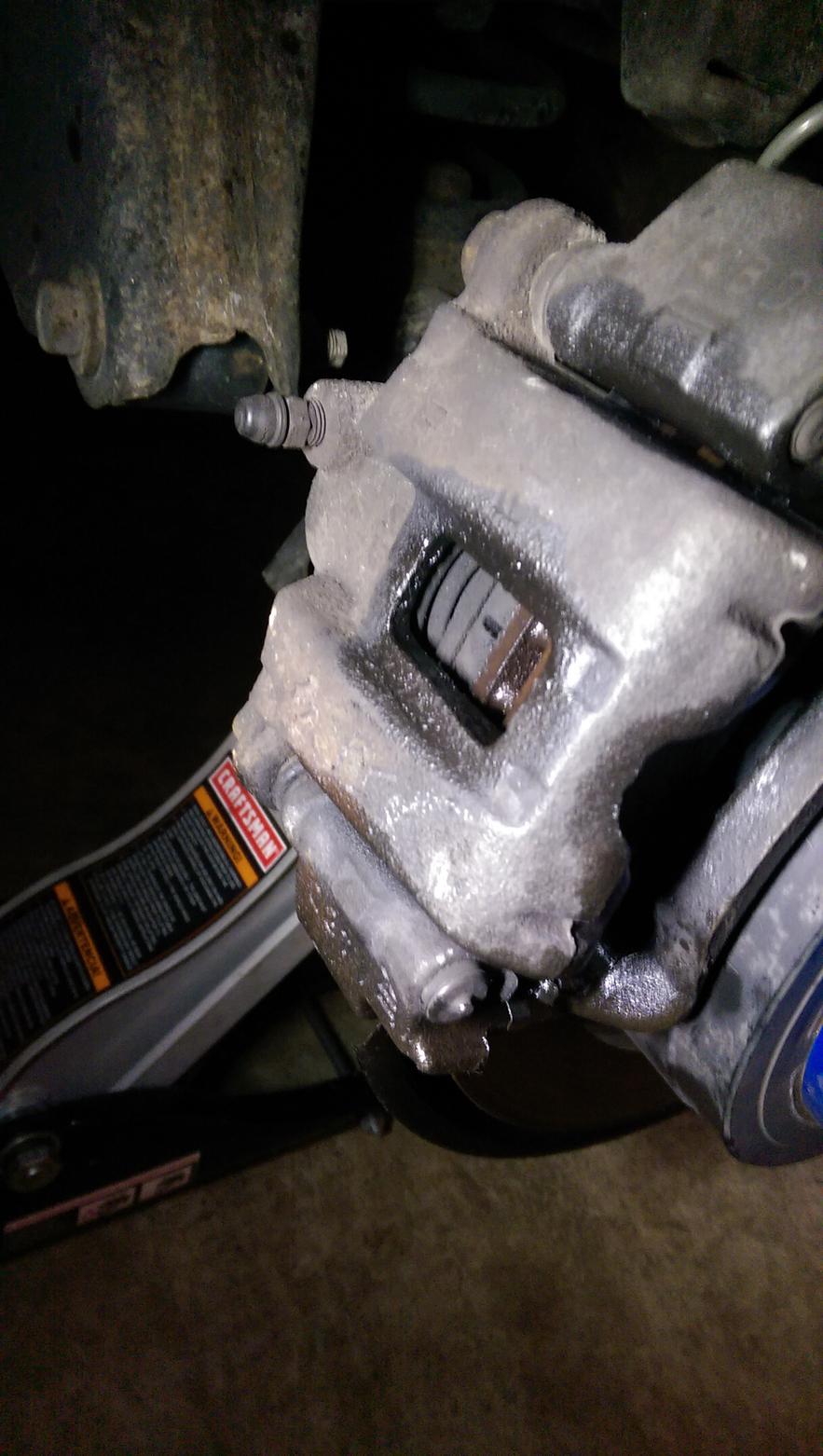

Went out today to install a Daystar 1.5 to correct my 'lean' and found the inside of my rear passenger tire splashed with oil. It would be WAY too simple and lucky for this to be a faulty brake caliper, and since the brake fluid levels are fine, I'm thinking the bearing is pretty much toast. I came out here and found an EXCELLENT write-up for the 3rd generation rear bearings...are the 4th generation pretty much the same, with the exception of part number differences? I searched around out here a bit, but couldn't find anything conclusive for the 4th gen rears (plenty for the fronts).
Here's a few pics: I couldn't get a good pic of the rear of the brake shield, but the lower end is saturated in oil.

The process for the 4th gens is the same. The only difference is that you can't use the same tool to press the bearings out since the 4 bolts that hold the backing plate to the differential tube are in a different pattern.
It's really not too hard of a job. Take it off and take to machine shop, should only cost you $60 or so for them to press it
Most of the time you can just replace the seal in the axle housing and be fine though. No need to replace bearing if it's not bad. The seal you just slide axle out install new seal on housing and and be on your way.
Unless the bearing is making noise, the oil is gear lube and you only need a axle seal. Save yourself some money!
