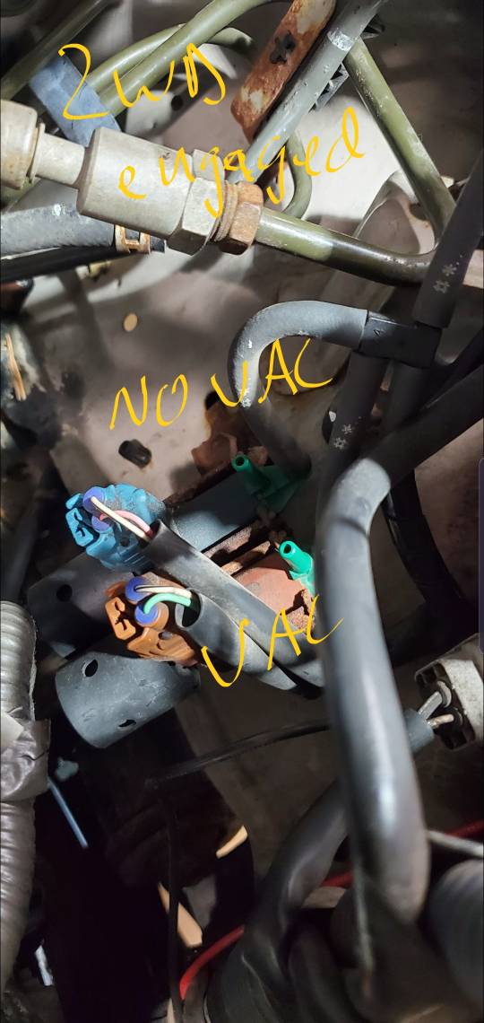

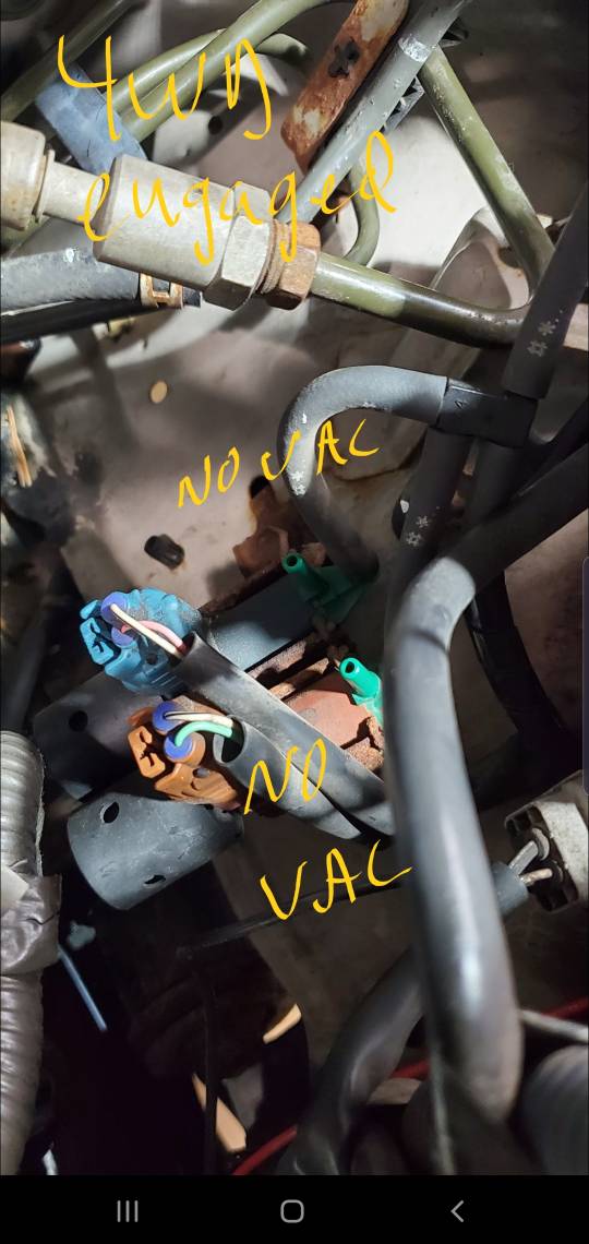

OK I realized I wasn't messing with the correct tubes, I have found them now.
I first checked the manifold to make sure I had vacuum and I did. I also made sure the check valve was working (I can blow in it but you can't suck any air through it) so that appears to be fine.
The orange VSV has vacuum and the black one doesn't when I'm in 2wd.
When I put it in 4wd, neither the orange or black VSVs has vacuum.
So what's next?
Sent from my SM-N975U using Tapatalk
Sounds like you need a new vacuum switching valve. Unplug them and make sure that you are getting power and ground to them when shifting in and out of 4wd just to rule out the switch on the transfer case or the wiring. A new valve is over $500 from Toyota.
Well I fixed it! After finding some write ups and how the system works, it turns out one of the VSVs was bad.
Thankfully I had a spare set on my parts truck. Everything works like it should again.
Everything was working like it should but the one VSV wasnt getting a vacuum when I put it in 4wd.

Yeah my issue wasn't with the actuator (thankfully) but one of the two VSV's that mount to the drivers fender well in the engine bay. Everything test fine except when I would put it in 4wd, the one VSV wasn't passing/switching the vacuum to engage the actuator. If you're having any 4WD issues, find the write ups that The Durk has made on here and follow his instructions. I understand how the system works now and it is pretty easy to diagnose.
