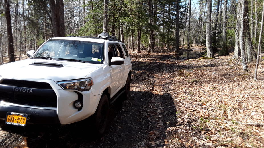

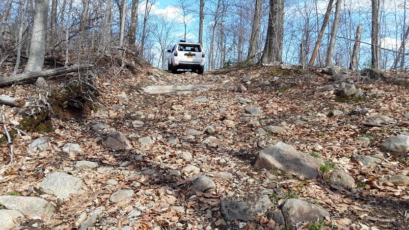

Besides what better an excuse to go out once a month to find some dirt or gravel to play in?
